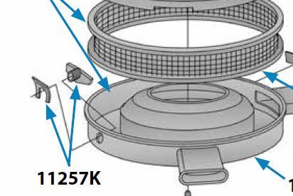

Awesome, thanks chaps some great advice, I will replace the PCV see if there is any improvement - for this "it wil have a PCV filter clipped inside the air cleaner" - any pics what this looks like, the car is not stock and I dont really have any history of it so not even sure what is/is not stock and I will also replace on the offchance (if I have/need one)

There has to be a breather in the passenger side valve cover, whether the car is stock or not. Verify the breather is installed, and that it's flowing freely. If there is no breather/fresh air inlet in the passenger side valve cover, that's part of your problem.
The PCV inlet air Air Cleaner Breather Crankcase Filter looks like this:
It installs in the air cleaner like this:
If you have modified your car to eliminate the stock system, you must replace the filter with some other alternative means of crankcase inlet air for the PCV system or it will blow oil out the PCV seal.

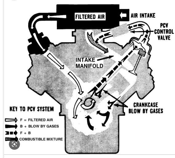

Only the PCV should be routed to the carb's manifold vacuum port. The passenger side breather must be vented to atmospheric air pressure, either inside the air cleaner or by being a free-standing vented cap to atmosphere. The passenger side vent should not be routed to any port on the carb.
This diagram shows the PCV system operation at idle and at light throttle cruise when there is plenty of manifold vacuum. When you "get on it," there is little or no manifold vacuum, and ring blow-by is at its greatest, so the crankcase gasses then reverse their flow and blow up through the passenger side air inlet supply, into the air cleaner, and get sucked down the carb's air inlet. If you do not have the fresh air inlet tube from the air cleaner, but have a vented valve cover cap instead, the blowby gasses are simply vented to atmosphere under high power settings. If blowby under power is excessive, or if the fresh air inlet system is restrictive, the blowby gasses will pressurize the crankcase and attempt to blow out the PCV with resultant oil leaks around the PCV grommet.
