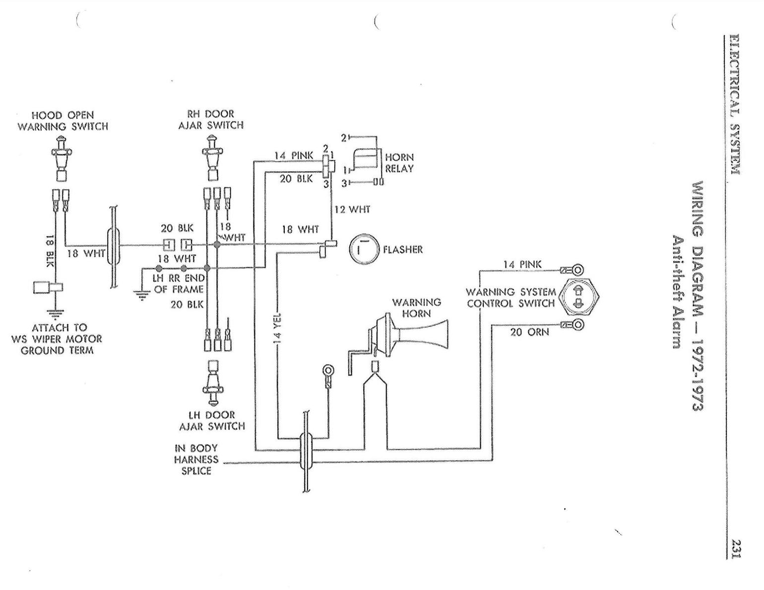

Have you tested the anti-theft system to see if it works?
Do you have 12 volts on the orange wire at the switch?
Since you have no key for that switch jumper from the orange wire to the pink wire and see if the system works.
