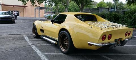

I run a 69 vette with 650 hp all day long very street friendly same as my car when I had 350 hp and with AC to boot. not gunna happen on that budget.

Very nice, but unless the OP is a speed freak, 400-425 HP should fit the budget, and without having have to spend tons of cash on drivetrain upgrades.
650HP - Jeez. You, sir, are a brave man (or just stone cold nuts- haha). I'll be happy with 507HP. 650HP must be an absolute monster...

Not a monster very smooth and friendly and have vacuum to run head light doors and wiper door and fits under hood no problems .
