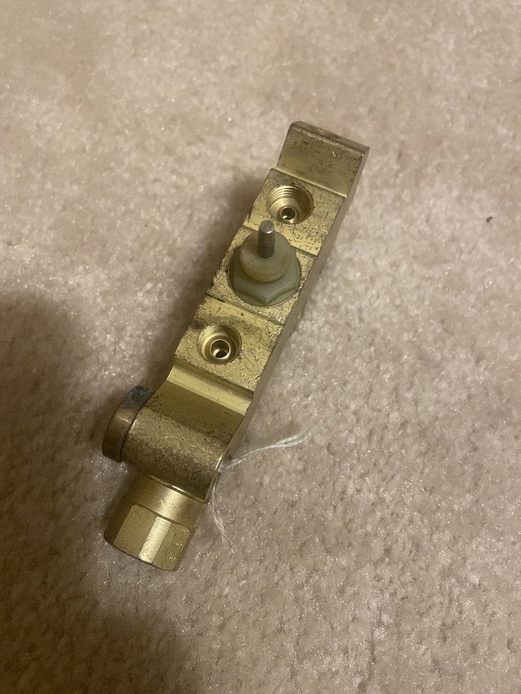

Pushed the button on the proportional valve, it's the stock one so fairly old. I took the handle part of a screwdriver and pushed as hard as I could on the button. I didn't hear or feal any clicks or noises.

Oh, and a 76 doesn't have a proportional valve. It does have a brake pressure switch that will move to one side if you lose pressure on one line or the other. It has a brake warning switch in it. And the way to recenter it is to stomp on the brake pedal hard a few times. But button? What button?

I thought it was called a proportional valve but yes I've looked into it. My brake light doesn't come on and I tested the switch on top to see if its gets power, by using the tool where you ground it with a clip on one end and then touch the wires on the switch to see if the light comes on in the dash. The light did thus proving to me that the switch worked. I have also slammed on the brakes many times just to make sure. On mine, there is a small black button on the rear end of the pressure switch. Ive also bench bled the MC two different times and I pump it until it has no air coming out. The only confusing part is when Im going about 40 and I stomp on it the passenger front tire locks up and leaves a tire mark behind me, so I know that side is good. Do you think I should still bleed the brakes while the car is running?
That is not a button, it is an electrical terminal. The 'BRAKE' light on the dash will come on if the parking brake is applied and the same light on the dash will come ON if there is a leak in the brake system. Remove the brown wire at the prop valve and with the key ON, ground it and the 'BRAKE' light will come ON.

Yes, the switch sits on tops of it, for some reason mine looks different then anyone's I've seen. It has two mounting bolts on the top instead of the top right and bottom left. I don't have a picture nor when I look it up I cant seem to find what my mine looks like. With the measuring tool, when i took the MC to bench bleed it I stuck a bolt in and measure how far it went in and then copied that on the adjustable rod.

Can you post a picture of your PV?

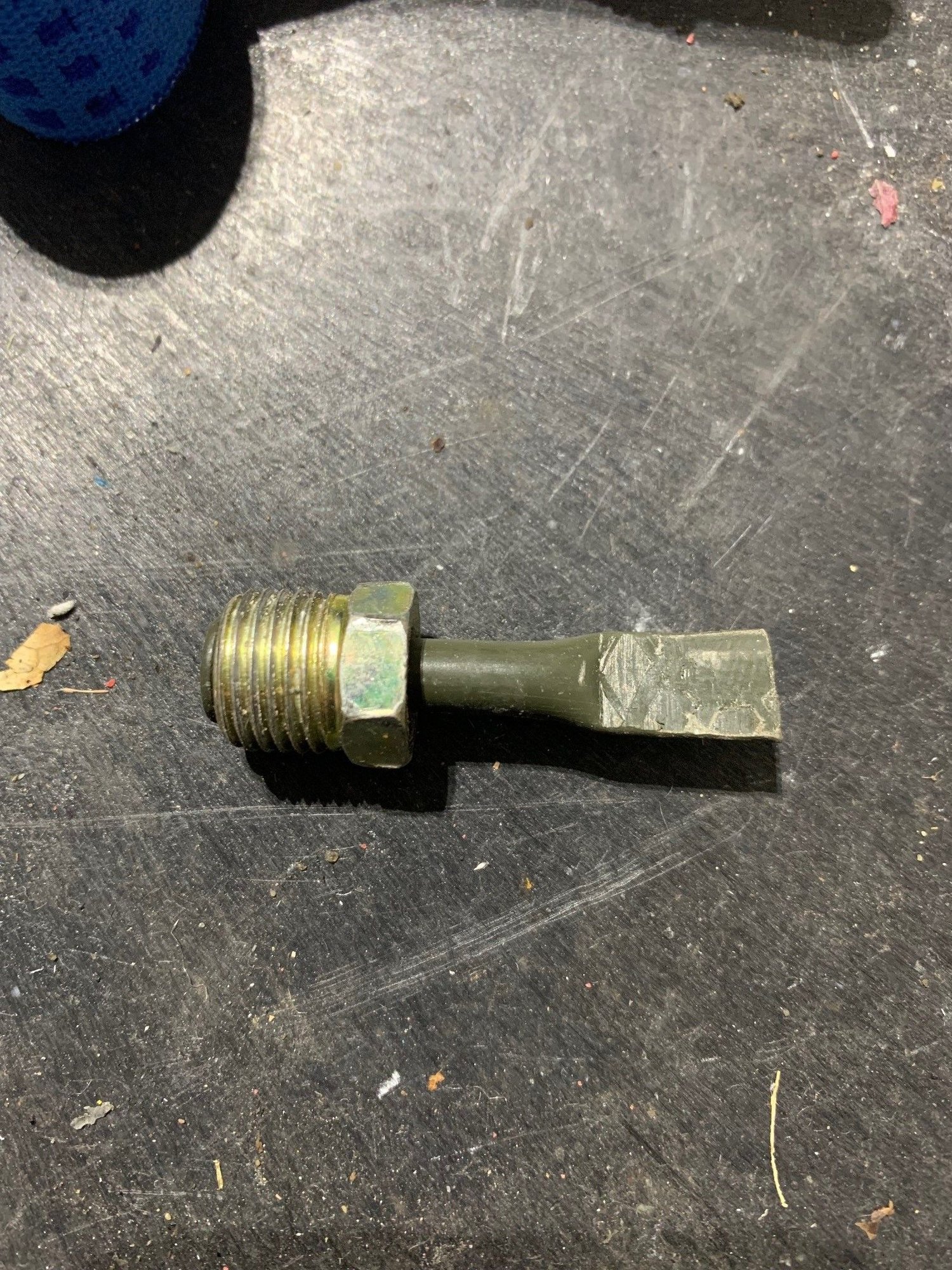

The 'GAP' between the booster push rod and the master cylinder is critical and should be between 1/32" and 1/16"
In the HELP section of many auto parts stores have master cylinder bleed kits that contain the plugs.
The size you need is:
9X18 and 1/2X20
