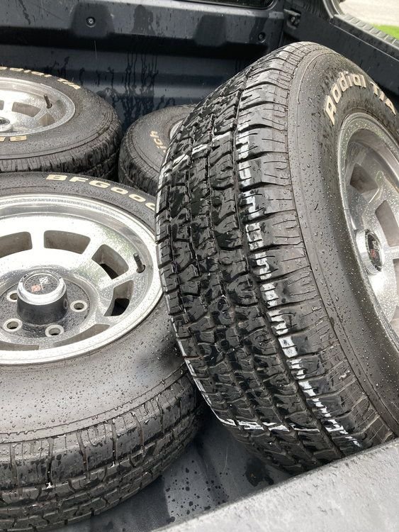

The tires are cooper cobras. Not the best but I’m going to get them rebalanced. The date stamp is from 2018 which is’t too bad.
The mags are REV made by Holley. Can’t imagine them being out of balance. I bought a set of factory ‘68 AG rally wheels that I’m going to repaint and mount a set of redline BFGoodrich redials from Coker on. They are pricey and though I’ve seen a few used sets for sale even though they were “like” new they were 6 years old or better and thats like rolling the dice. Coker is running a sale right now with free shipping and 10% off so I’m going to take advantage of that while I can.
