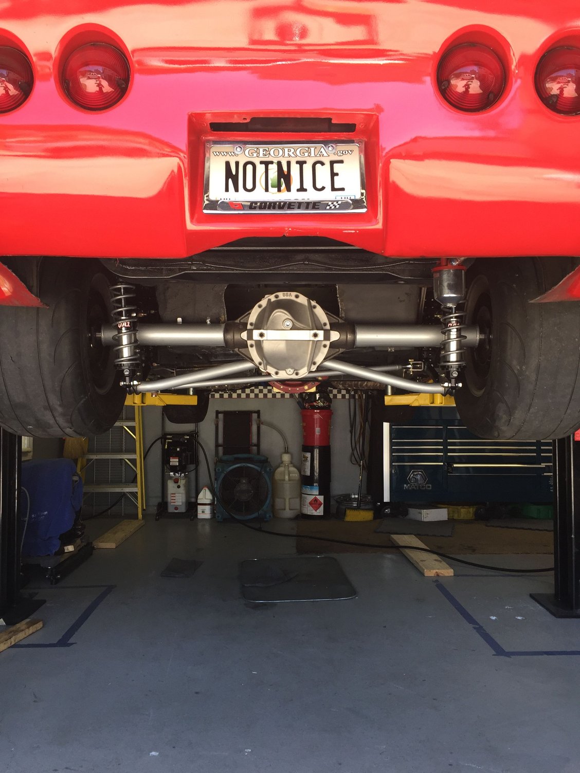

Do you have a differential and driveline that can handle this?

Oh I see if I read it and paid attention lol it has a straight axle 12 bolt got it .

Yeah Skip White and yeah a solid axle in it 😎

Ive had 4.11 for over 30 years in my vette, but it was always with OD transmissions.
Before I put a dime into a 3 speed automatic I would research modern 8 and 10 speeds. I attend and pit crew NHRA events. They have lots of 8 second late model Camaros
Someone must make an adapter. I was dumb to put 5 grand into a 700r4 and 3800 stall TC

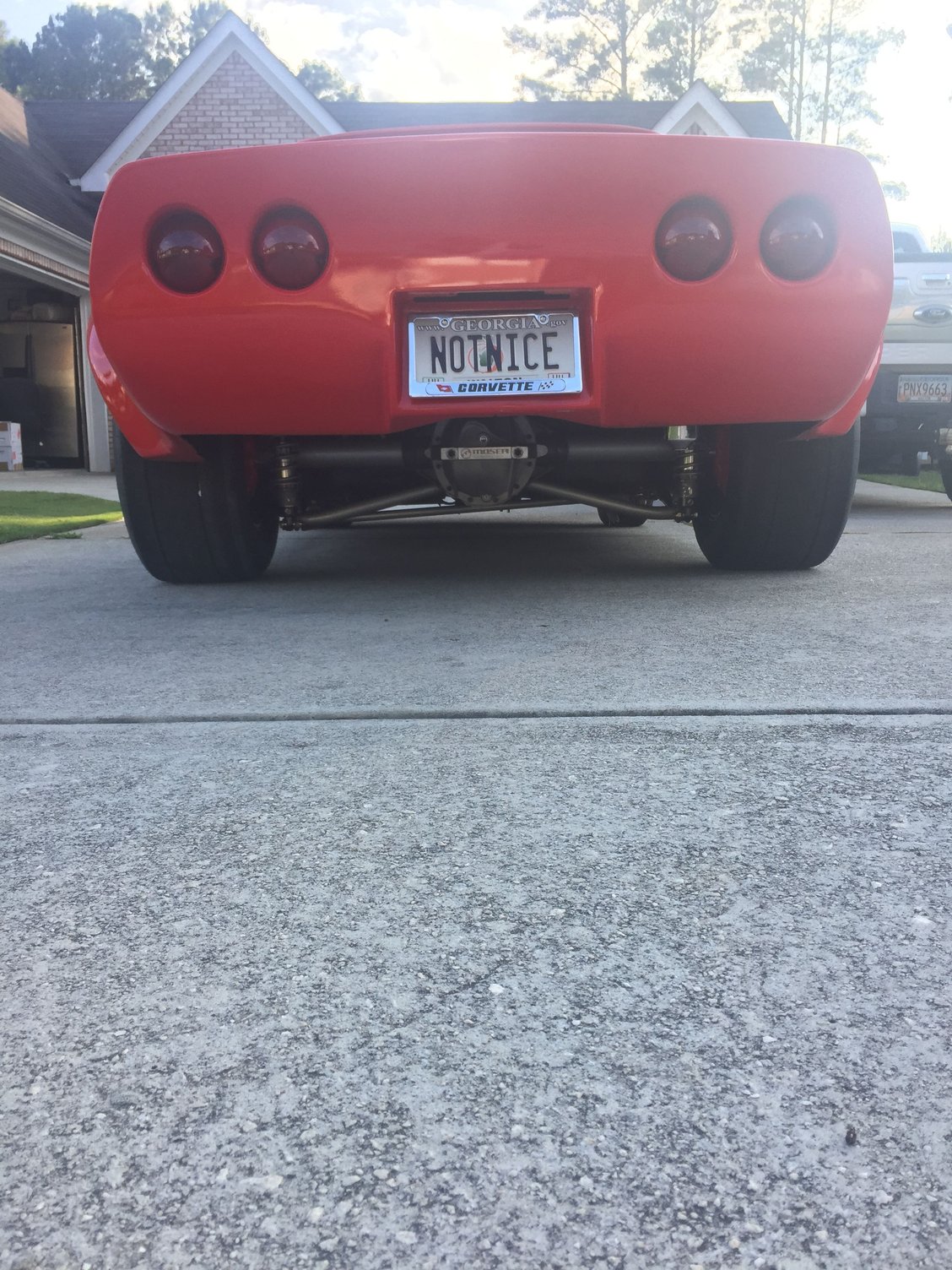

No tires are big enough for that on the street, lol. My 33"x 18.5" MT ET street slicks roast at any speed up to 60 mph in my 800 Hp 540 Cuda. I'm sure at higher speeds too but I won't try it. Maybe better if I got the tires hot but in urban areas with curves and hills you simply can't drive fast. Only the track will hold it.

TC's are a torque multiplier in an auto tranny. I had terrible wheel hop with my vettes IRS and traction problems with my 335 width best ultimate performance high speed radials. The answer was a manual tranny with the best clutch that people with 1000 hp use, 520# custom mono spring, QA1 dual adjust shocks, solid mounting the rear diff cross member, solid mounting the front diff snubber for zero movement, Smart struts mounted for Zero camber gain, and trying zero rear toe in for max traction like in drag racing with a solid axle. I already had the full roll cage 8 point for no frame flex and lightened vette to get nearly 60 % rear weight bias.
It will take some thought to get a 582 and 4 link going. Weight transfer and adjusting the 4 link setup My friends pro street 69 Camaro does it with even more power.
Amelio you might think about a parachute!
