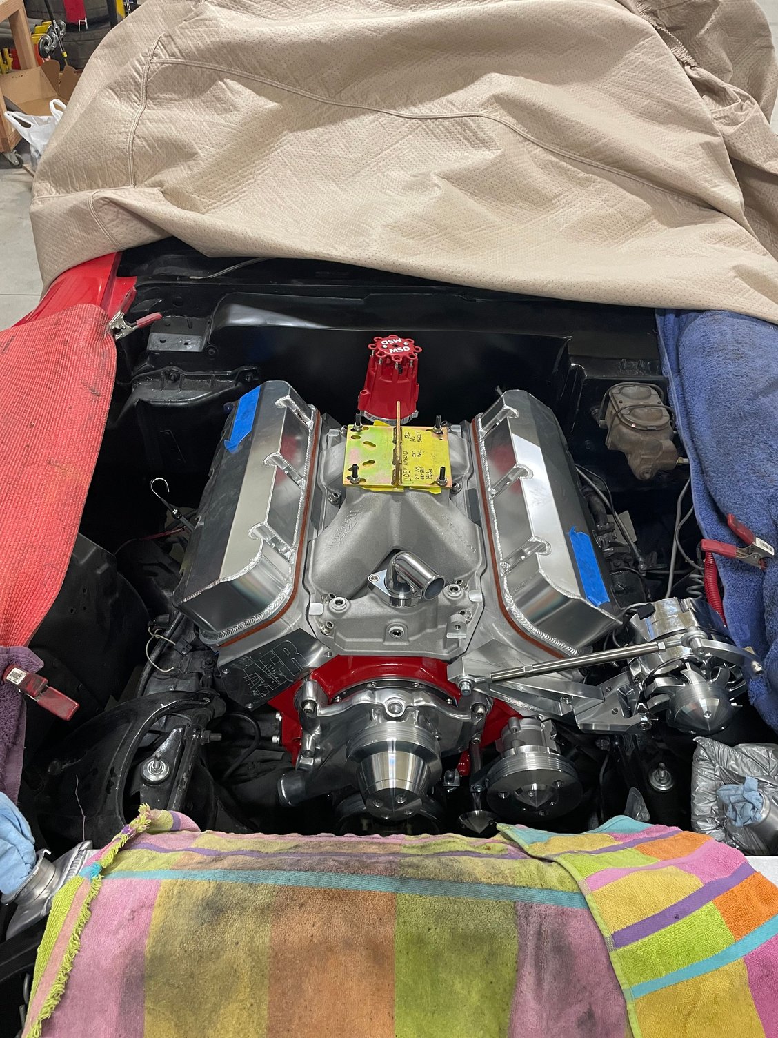

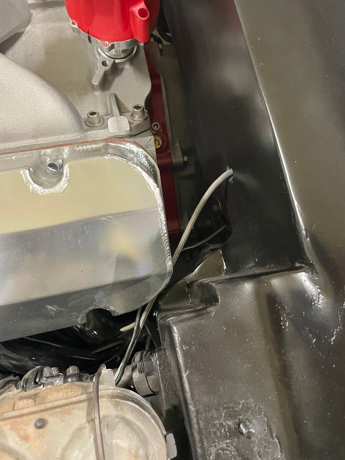

finally got this thing set in for the last time, I’ve had the engine in and out about 10 times, playing with engine mounts and firewall clearance issues. Had to message the fire wall some more next to the brake booster to clear the covers. Once that was done I had the headers on and off about 15 times, had to clearance the frame multiple times to get things to fit.
Now it’s finally set in, trans and all is hooked up and headers are bolted up. Just need to start wiring and plumbing. Getting much closer.

Nice tight fit!

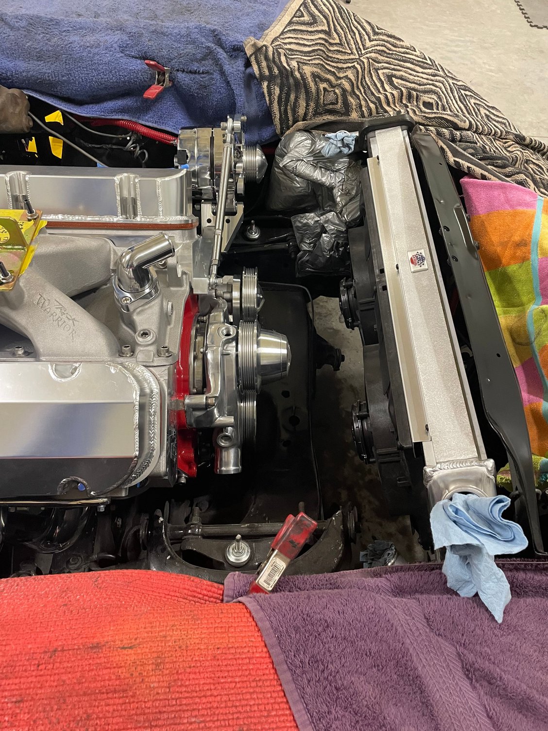

Originally Posted by 509 rat
Looks good is that the march pulley set up I have them in both my cars .
yes sir, I should have ordered the engine less the accessory drive setup, I had to switch everything because the long water pumps just won’t work in this car. I thought I could get away with it because I had a long pump on my sbc, I figured I would just notch the crossmember but it wouldn’t clear the fan setup. So I ordered the March kit and now have to use the type II power steering pump with the remote reservoir. No big deal really but I’ll have to get some hoses made.
im really happy with how it looks as I wanted a serp belt setup on the car. It’s getting closer, hopefully another few weeks of plumbing and wiring and she will be ready to run!
