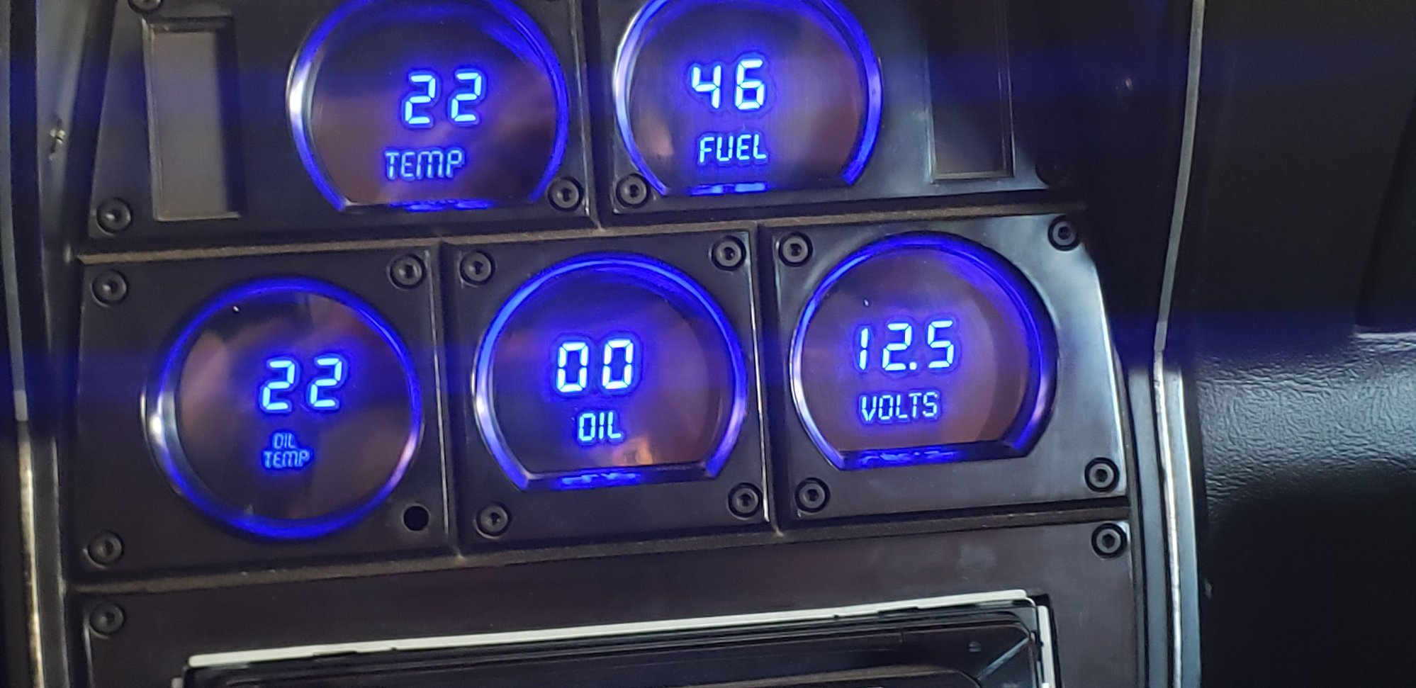

When you say none are working are you also meaning Tach? or Just center console? If it is just center console, it might be possible plug harness behind center cluster not making good contact. Just redid my gauges on my 80 to a more modern look.
Still waiting on two sending units. Water and Oil senders.
