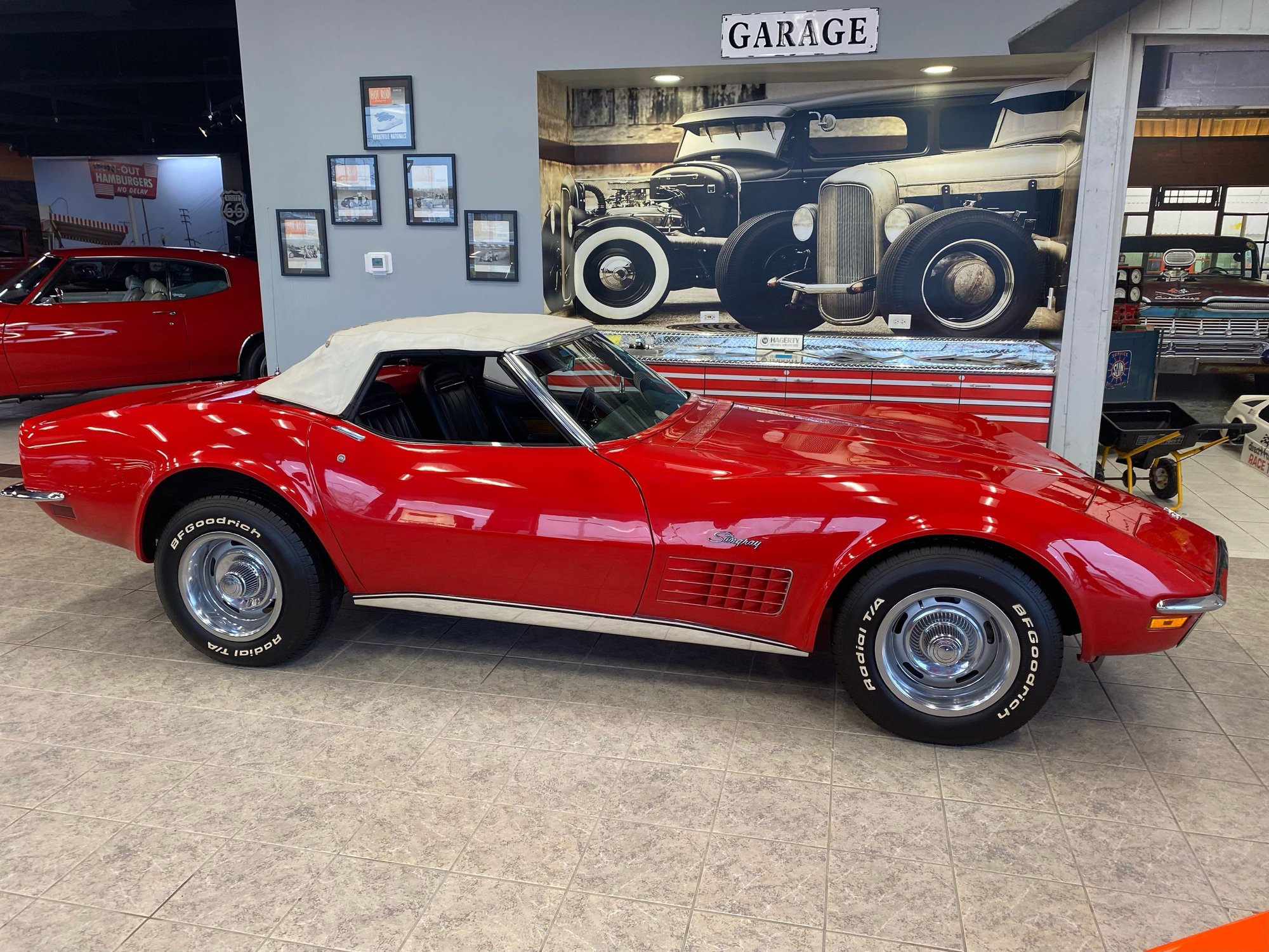

I took delivery of my 1970 Stingray with the original 350 ci this weekend. Love it, but it needs some TLC. First set of issues may be related, but not sure. First, engine idles at 1500 rpm all the time, no longer how long it has been running. Second, the radiator fan runs constantly as well. Third, the coolant temp gauge doesn't work and sits at 100. Are these related? Will fixing one resolve the others? Or are they separate issues?

nice looking car.
all 3 have a temp related system but I don't see how a cold engine makes fan run?
1500rpm sounds like choke system.
70 had coil on mani and not electric
fan/s running must be electric?
gauge is elect
need pics and more info

The fact that you have electric fans installed means that someone has done some modifications to your engine, and it is not stock. The fact that the fans run all the time means that the modification was poorly or incorrctly done, which then leads to the question, "what else have they modified and performed incorrectly on your engine?" Did they change the intake manifold? Has the exhaust crossover been blocked? Do you even have the original carb on the engine or is it an aftermarket non-stock carb? High idle speed is indicative of either a vacuum leak or the throttles not fully closing. Not knowing what carb you have makes it impossible to make good suggestions - shoot some photos of your engine compartment so I can see what the configuration is.

The fan is not electric and it spins by hand when the engine is off. I may be overestimating the continuous operation, but I have yet to see or hear it not run.
Went for two-hour cruise today. Intermittently, the idle settled down to 1000 rpm, but returned to 1500 by the time I got home. Still not sure why.

A de-clutching stock fan will always be turning when the engine is running. That's the way it works. Even when de-clutched, it still spins.. The stock mechanical fan never stops spinning if the engine is running. Yes, you can spin it by hand when the engine is not running. Your fan is operating normally.
