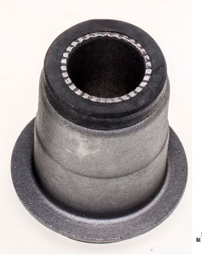

The outer sleeve should not be removable from the inner rubber. The bushings are a 1-piece assembly that should not come apart:
Lars
