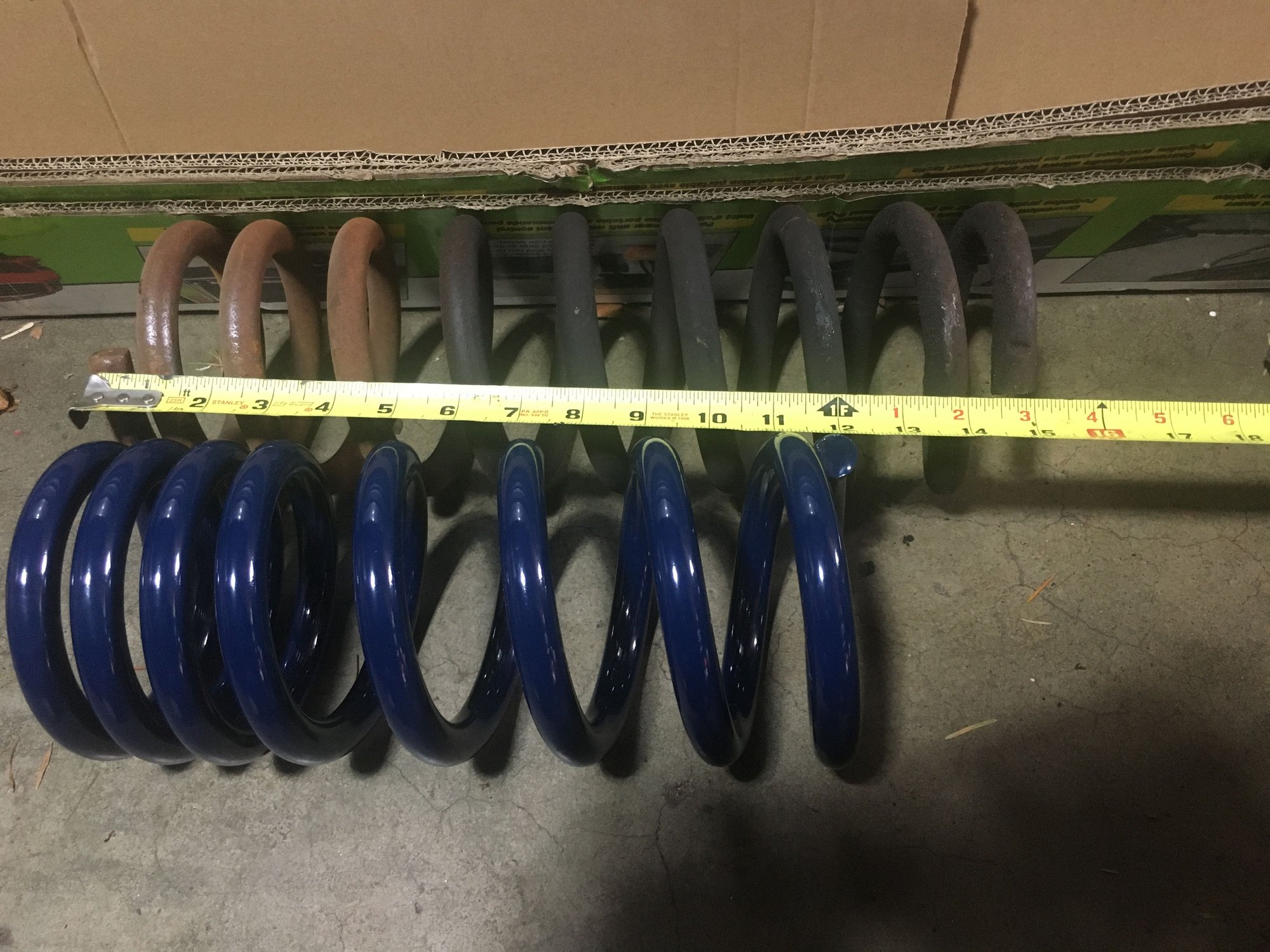

Thank you all. I'll just cut the coil in front and get longer bolts in rear. Is changing the coils a tough job? Anyone done it?

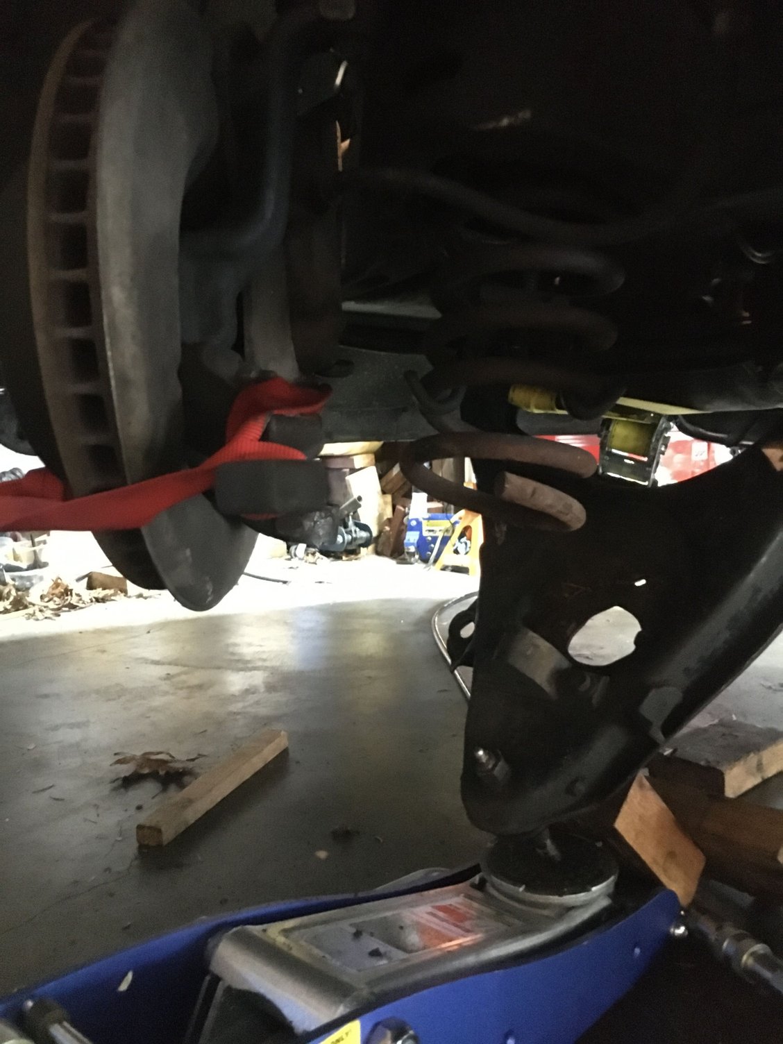

I feel very safe using a heavy-duty ratchet strap along with the spring compressor. It’ll work with just the compressor, but I’ve heard stories about the compressor breaking and the spring flying across the room. Here’s a pic with the spring ready to come out. Dual rate springs reduce body-lean in hard cornering without compromising ride quality. These lowered the fender lip to 27 5/8” with 27” dia tires.
