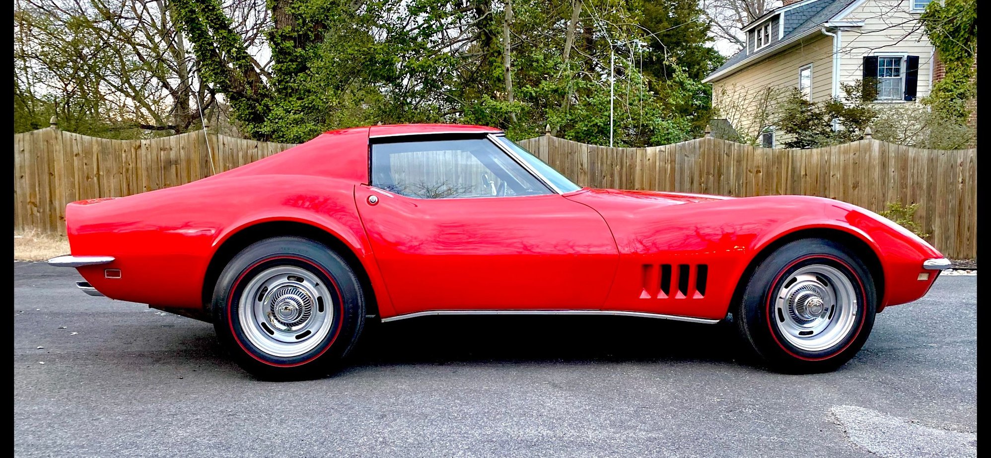

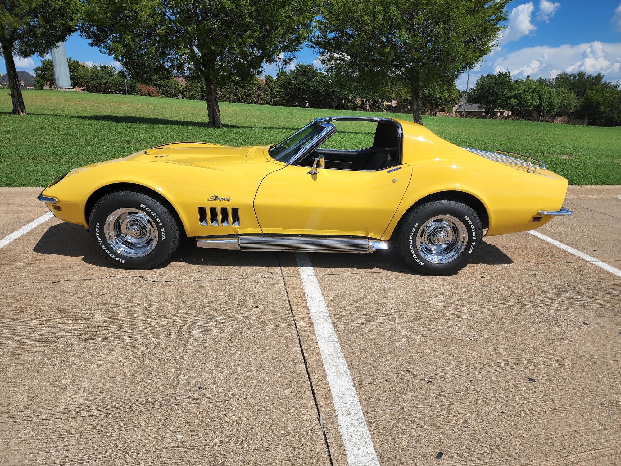

Hi all, a few years ago I installed a new leaf spring which was the factory or OEM one. I started looking my car again and noticed that the ride height seems to be pretty high. There are no new shocks or springs and I haven't done those replacements yet. I'm wondering if I should do that and any recommendations without any drilling and whether it's car should be lower?
Should I be removing some leafs? And what about front coils?Edit: I did some measurements.
front- ground to outside wheel fender =28.75 inchRear - ground to outside wheel fender =29 inch

Looks like the gm brochure to me ..and yours looks great to me..i also like the slight rake

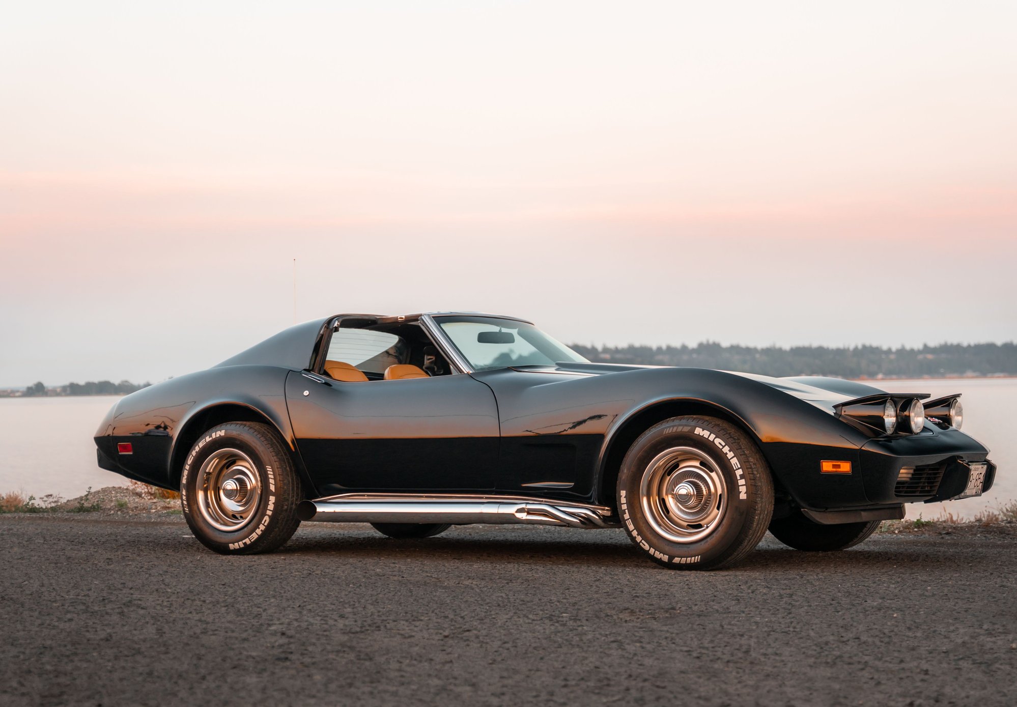

New eaton 7 leaf gymkhana stock bolts..actually sits lower than i wanted..but not bad..moog 474# up front

Looks like factory ride height to me, mine has all new suspension.

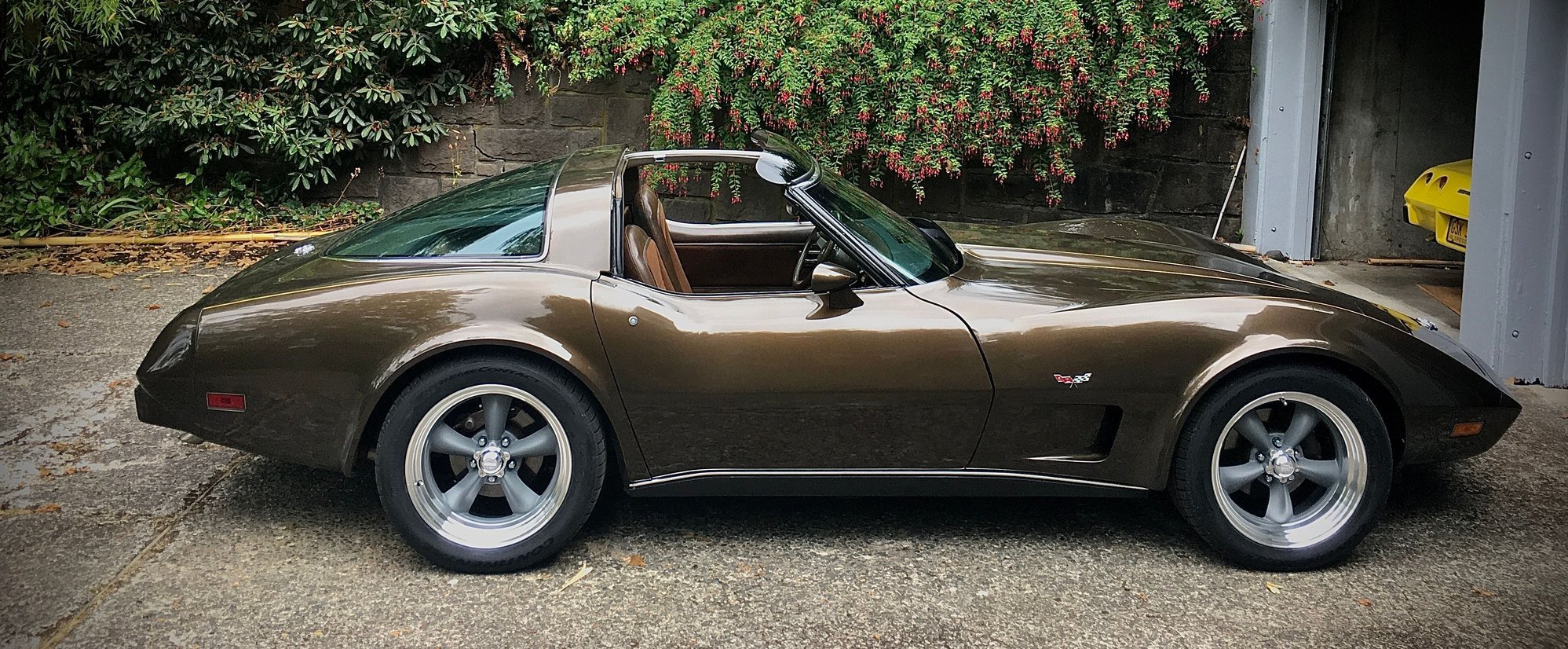

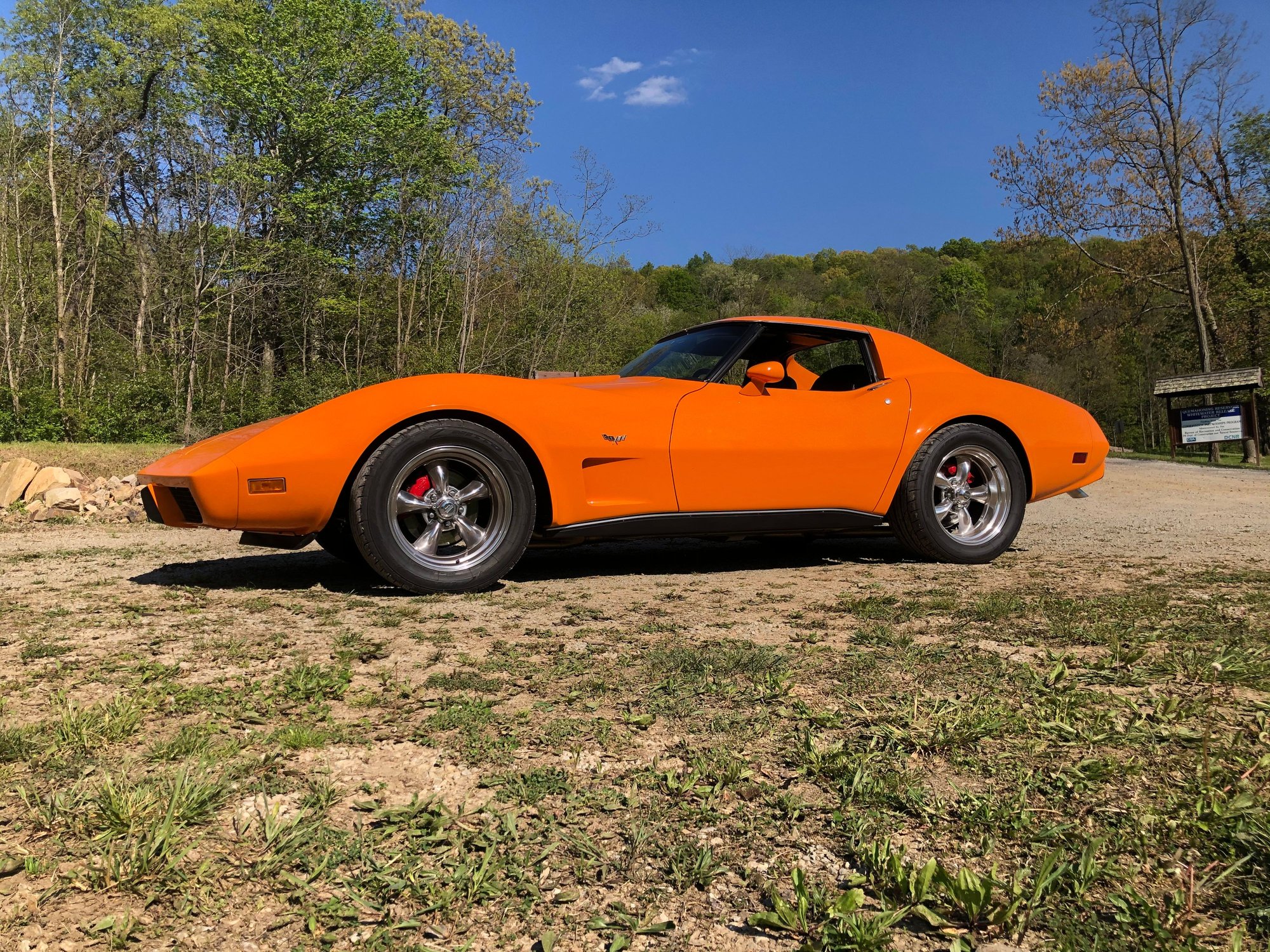

Looks ok if you wish to have the original ride height and handling quality. Lowering 1” is easy, improves handling, and IMO looks more like a sports car. Stiffening the suspension, even a little bit, and spreader bar make an improvement as well. As above, longer rear spring bolts make the rear height adjustable (mine came from Vansteel). I used dual-rate (480/700) Hyperco lowering springs(-1”) from Ridetech in front. Here’s a before and after pic. Wheels are 18x8(up to 9.5 rear possible) with same 27” diameter as 255/60/15. Ride quality stayed the same, but handling improved dramatically.

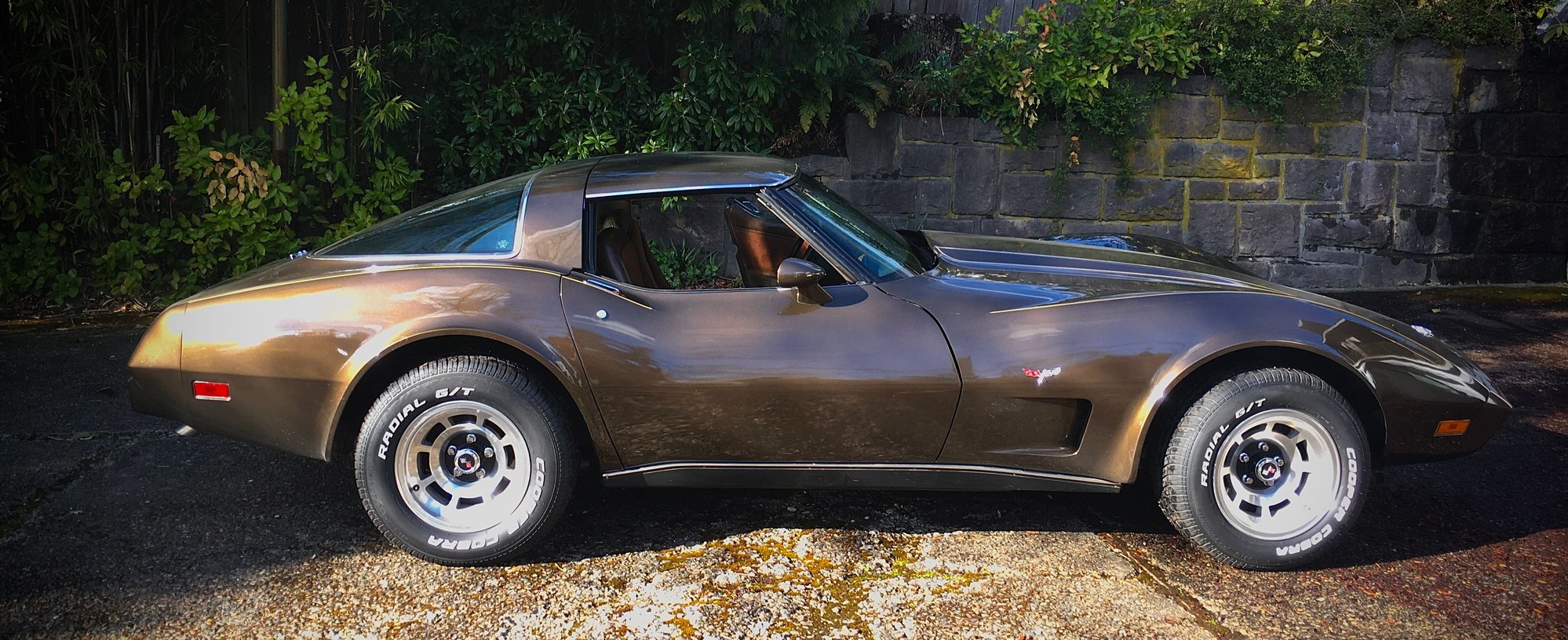

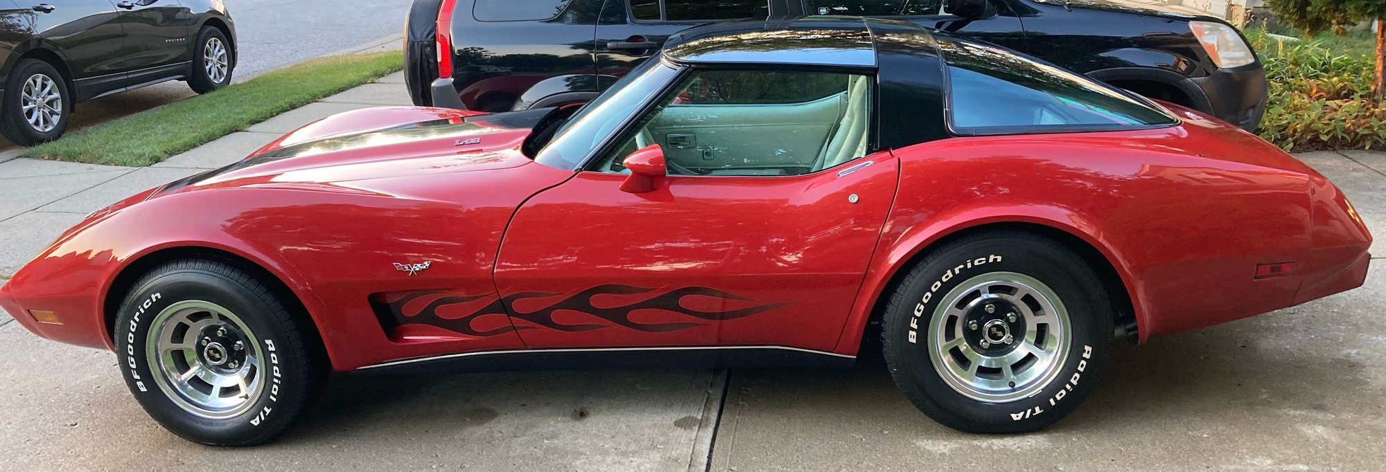

I made the required adjustments to get the ride height around the 27-1/4 inch mark to the wheel well openings. Required 8 inch bolts on the back, and cutting half coil off front springs (Moog 500 lbs). This is the result. These are 17 inch wheels, but the tires are exactly same outside diameter as 15 inch tires. This puts the tires perfectly concentric with the wheel openings.....looks perfect, no rubbing anywhere.

It looks factory, which in my opinion looks too high, kinda like a Jeep. I'd take out a couple leaves, and cut a loop of the front coils. Or go with coil-overs like I did.

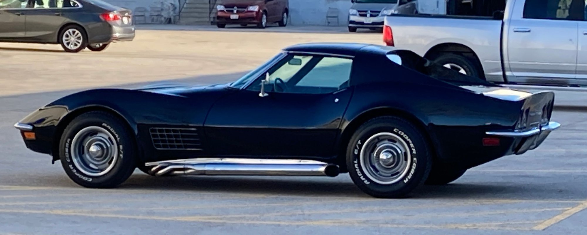

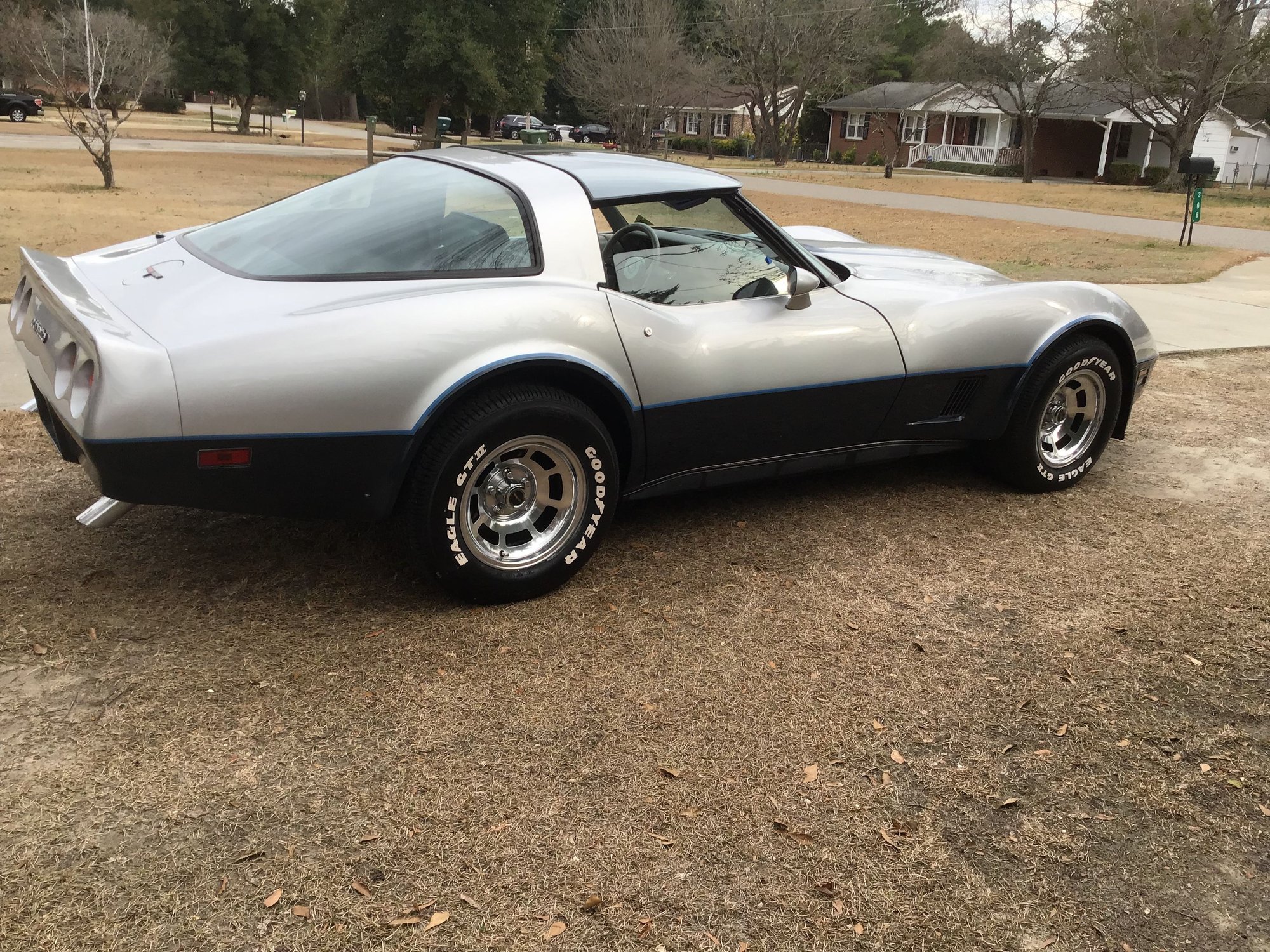

Here’s another black one with side pipes for comparison. Stock ‘71 running gear. I do want to go lower.

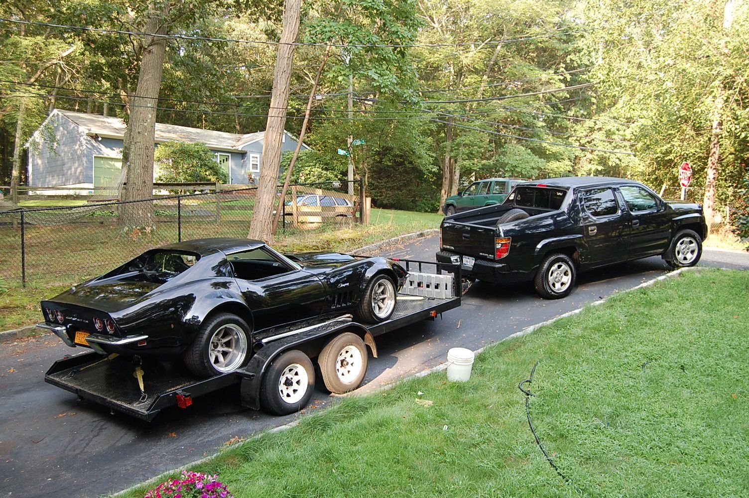

I have. I had the stock springs in my car. I tried the Daytona suspension. It was too stiff. Then I purchased Dick Guldstand’s F-41 suspension.
My ride was height was higher when I installed a new read spring. See the pic wth the car on the trailer. I took the car to do a Time Trial at NJMS (Lightning). The car did not handle well. My friend who is a certified instructor and driven numerous Corvettes of all years initially told me the car was possessed. I was reading my Chevy power book. Seems the real way to set the height was to set the “D” height.
I noticed the rear half shafts were not parallel to the ground. I found my D height was off (it was over 2 inches) and I have ordered longer rear spring bolts to get the back down and get the proper D height. I personally found that 8 inch were too short. I used 10 inch and when the proper D height was set, I trimmed the excess of the bolt with a Dremel. Someone correct me if I am mistaken, but I think non-tracked cars the D-Height should be 1.6". I used the racing spec of 1.2". BTW: This should be performed with a full tank of gas and weight equal to you own in the passenger seat.
Setting the D height also had the benefit of making the rear half shafts parallel to the ground. I had the car re-aligned and the handling was better at Summit Point. (see second pic with my son driving).
It is better than guessing and saying "That looks right". Be sure.
