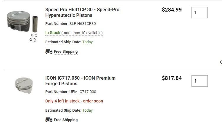

None of the skirts are broken other than worn and some of the groves are now gone. We did not measure the skirts to see how those look. Its for a 16 year who is driving to and from school. He does not need more performance. I am running speed pro hypereutectic in my 62 and it has plenty of power for that ride.

Sounds like you made a wise decision concerning what you found inside.
If you have not bought pistons yet, I would reconsider some 4032 forged ones. The Hypers are just cast and brittle. When they break they break badly. And they do not tolerate pinging from bad gas, or a carb out of adjustment, etc like forged would. Think of them as a durability "insurance policy". A few $ well spent.
The crank may not need to be turned. Feel it with your fingernail, if your nail can feel ridges it needs attention. If you can barely feel them, you can just have it polished. But if the nail catches on them, then it needs to be reground & turned undersized.
The polishing you can do at home with a cloth rope and the correct paper. IIRC it is fine emory paper, but if you like I will check with my machinist buddy to find the grit. Just wrap the rope around the paper and give it 6-8 spins back n forth. Don't go overboard. Then check it for feel again. Check it with a mic before & after. If it's smooth you are good to go. Ihave done them in his shop with the motorized polishing machine and it is just a few seconds on each journal.
If only you weren't 3000 miles away, I could help you check it, regrind it, or polish it, for you.
All right it's a $500 difference. Easy for us to spend money for you LOL!
OK..you know him...but I know how my 16 year old self drove and I KNOW how I would have driven if I had a Corvette!
As mentioned...cast/hyper's (especially the cheap rebuilder styles) don't do well with detonation or tuning issues..or high RPM etc. They are not the same quality as Porsche and new Vette Hypers and we don't have instant tuning ability that can retard timing before the next cylinder fires. But it's your call of course. I'm talking about longevity...not HP or performance with piston choice.
Not sure if you're saying some of the ring lands are broken on the pistons along with the broken rings? If so...that engine has seen some detonation or hydraulic'ing sometime in the past. Probably why head gaskets are different. It's a good thing you're going through it...it wasn't going to grow back for sure.
At least ck to get the actual deck height of the pistons as many are made "short" to allow for block decking and you'll end up with a dismal compression ratio.
And if you run the Hypers...make sure to pay close attention to ring gaps...they typically take a LOT looser so they don't rip the top ring land out of the piston.
And on the crank...make sure to actually ck the clearances, A pretty one can still be worn too loose.

Holy Sh*t those went up , I guess it would've been a lot cheaper to have over haul mine last year
