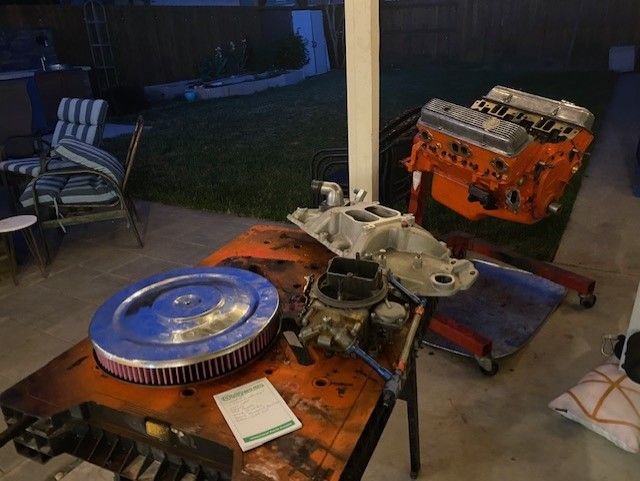

Picture from last night:

Last night, we got the engine in. We left the transmission in place. We did have to a wheel off to get enough access the for cherry picker's wheels. We went from the side and was able to get it stabbed in on one shot. Also, we had to remove the engine mounts off of the side of the engine to allow enough side to side room. I borrowed a neighbor's engine hoist. Usually, I use my friends hoist which has a larger boom on it. Taking the wheel off worked. Now, onto our list tonight. We should have three or four people working> Hopefully, we can knock out the list without getting into each other's way.
