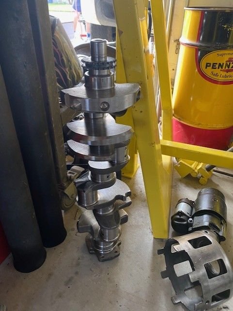

Some pictures...

Pull the gear off with a two jaw puller......hold it with one hand and use an impact.....
Jebby
Jebby
Yes, we have a new timing chain and gear for it. That was the plan... Also maybe some butane heat to get it going. Also, we need to remove the rear pilot bushing. Might as well get that out there too. Now, that part next to is for a 4L60E. My son is in the process of rebuilding his transmission too in the same three car garage.
No need to remove the bushing if going from manual to automatic....
And the gear should not be on there that hard....no heat needed....
Jebby
Jebby
yeah, I have taken off the gear before on other engines. I just did not do it when we took it off. It went to a machine shop for a good polish. Its going from manual to manual. It has a newer LUK clutch in it. Not sure when that was put in. The clutch looked really good.
If the pilot bushing is good....reuse it....no need to change it unless it has damage....or worn out of round....
Jebby
Jebby
I will take a look at it.

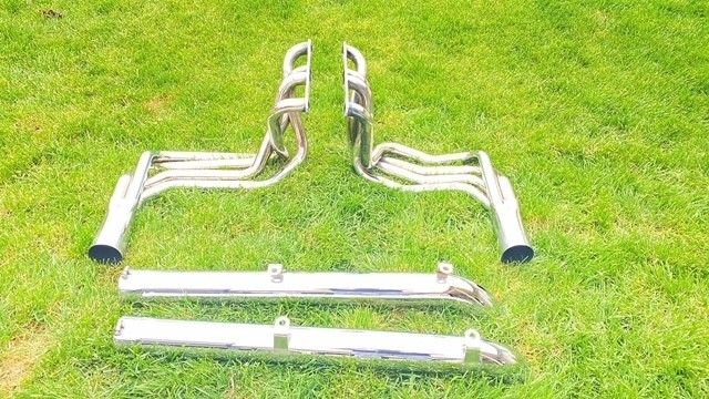

You dont want to break in your engine with the chrome headers,,,Good chance they wont look good when your done.
