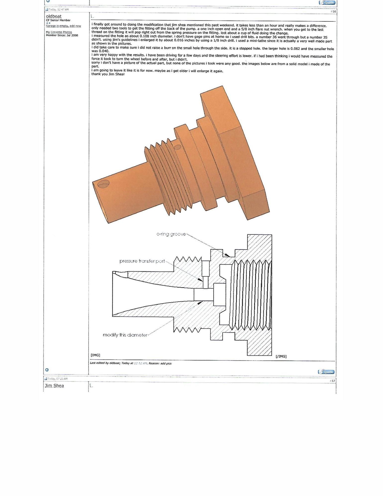

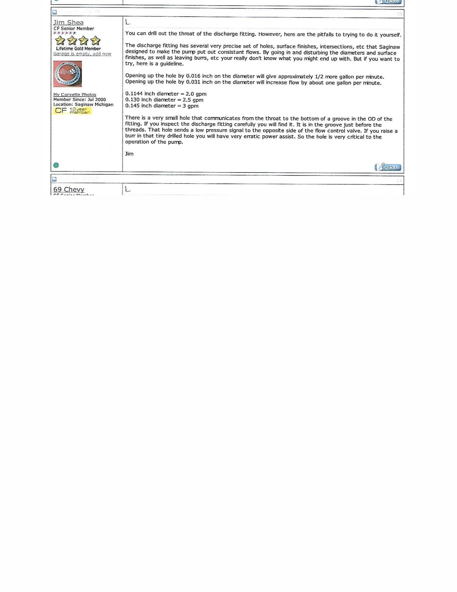

Default This might help
This question was asked by hugie82 on 08 09 2022.
I can't get the link to the original post, but heres the solution offered by Jim Shea:
