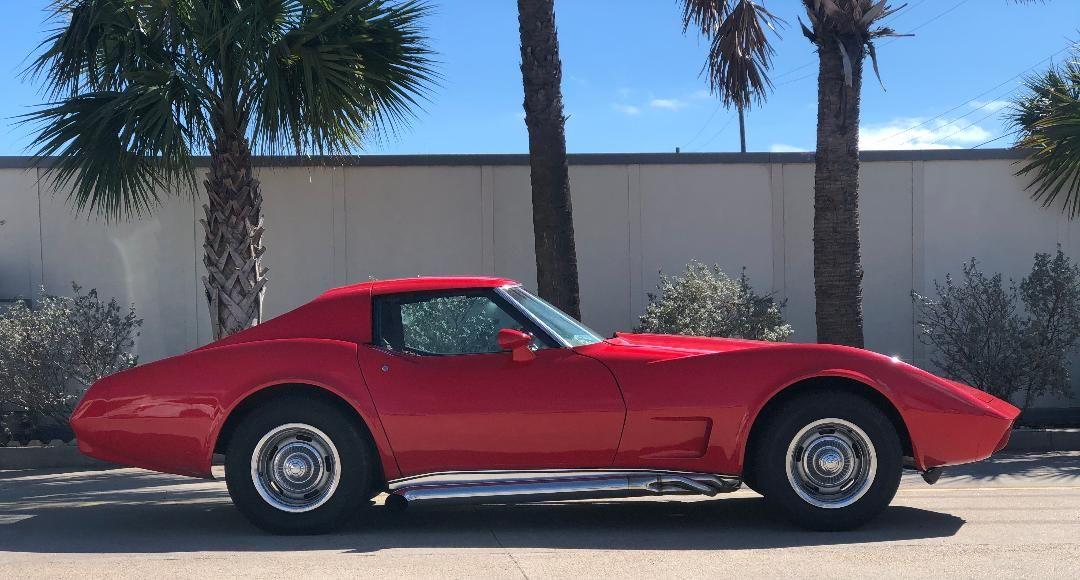

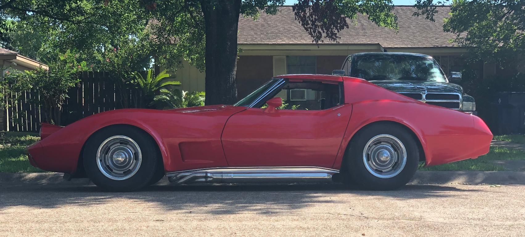

I haven't done my rear coil overs yet, just the front. Pulled out a rear leaf or two. Made a Hell of a difference. 255/60s all around.

Top of Front drivers side tire to wheel well clearance is smaller than passenger side. I replaced the spring but still sits the same.

I have same thing I see in your pic. Top of Front drivers side tire to wheel well clearance is smaller than passenger side. I replaced the spring but still sits the same.
A bad or misadjusted rear spring will effect the front

That is a before and after picture, it is roughly the same side to side. If the side to side difference were that massive, there would be serious problems!
