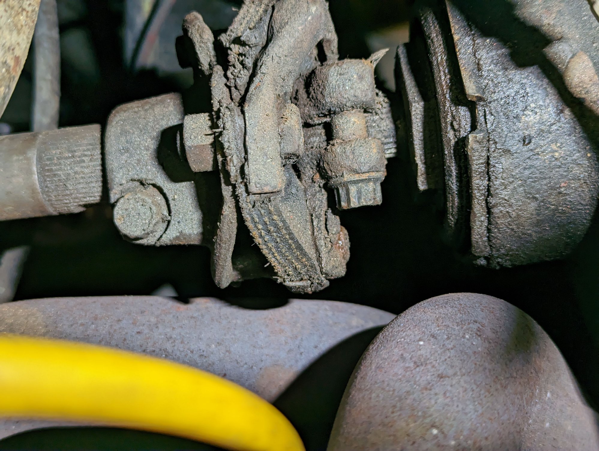

Well. That puts it in perspective, just a touch out of spec I'd say.
Rag joint is shot too, guess I'll fix that while I'm in here.
While the headers are off I pulled the steering box as well, as someone said in another thread, these while I'm in here jobs sure add up.

That is pretty bad, I would be checking the car closely for other quality work.
The best rags are NOS ones and expect to pay $300+ for them. The current new rags are not as firm, some don't have shoulder bolts, some are not grounded, some have the D-Flat 180* off. Yours is ripped has to be changed, a coupling will work and I would use one over the new rags sold today.
Your box is probably not much better and adding grease isn't going to make up for worn or corroded parts.

well it’s worth noting the quality of the original is much better than what you can get today but I agree prices are high. GM discontinued them about 10 years ago and they were $55 at the time. The cheap ones will work but they are not as rigid or grounded

You might even consider replacing the rag joint with a u joint.
Many people are swapping over and you can get a top quality chrome moly u joint for under $100.00.
I purchased this one from Summit Racing to go between my oem steering box and Ididit steering column, but they do make the direct replacement to go between the oem steering box and oem steering column.
They are also available in different materials, polished and chrome if that’s what you want.

The only issue with the U-joints is that they do not dampen, or even permit, changes in length along the steering axis. The rag joint desigm takes this into account.
That said, I have Flaming River U-joints in both cars.

Thank you all, I did pick up an aftermarket rag joint for the time being, I will keep the NOS rag joint and the universal in mind as well.
