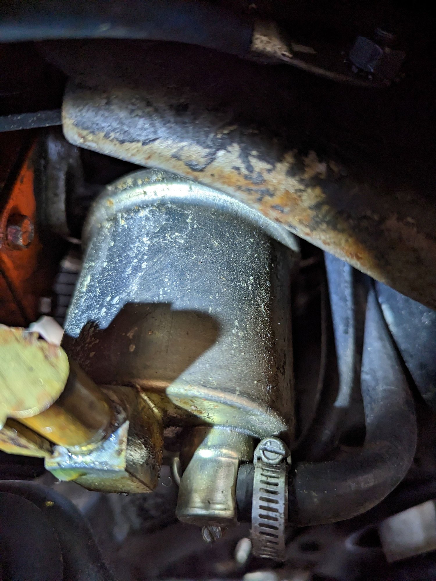

As far as I know, my fuel pump is original - at least I can't find any aftermarket wording or logos on it (photos below). I did replace the fuel line from the pump to the carb, but that is all I've done to the fuel system.

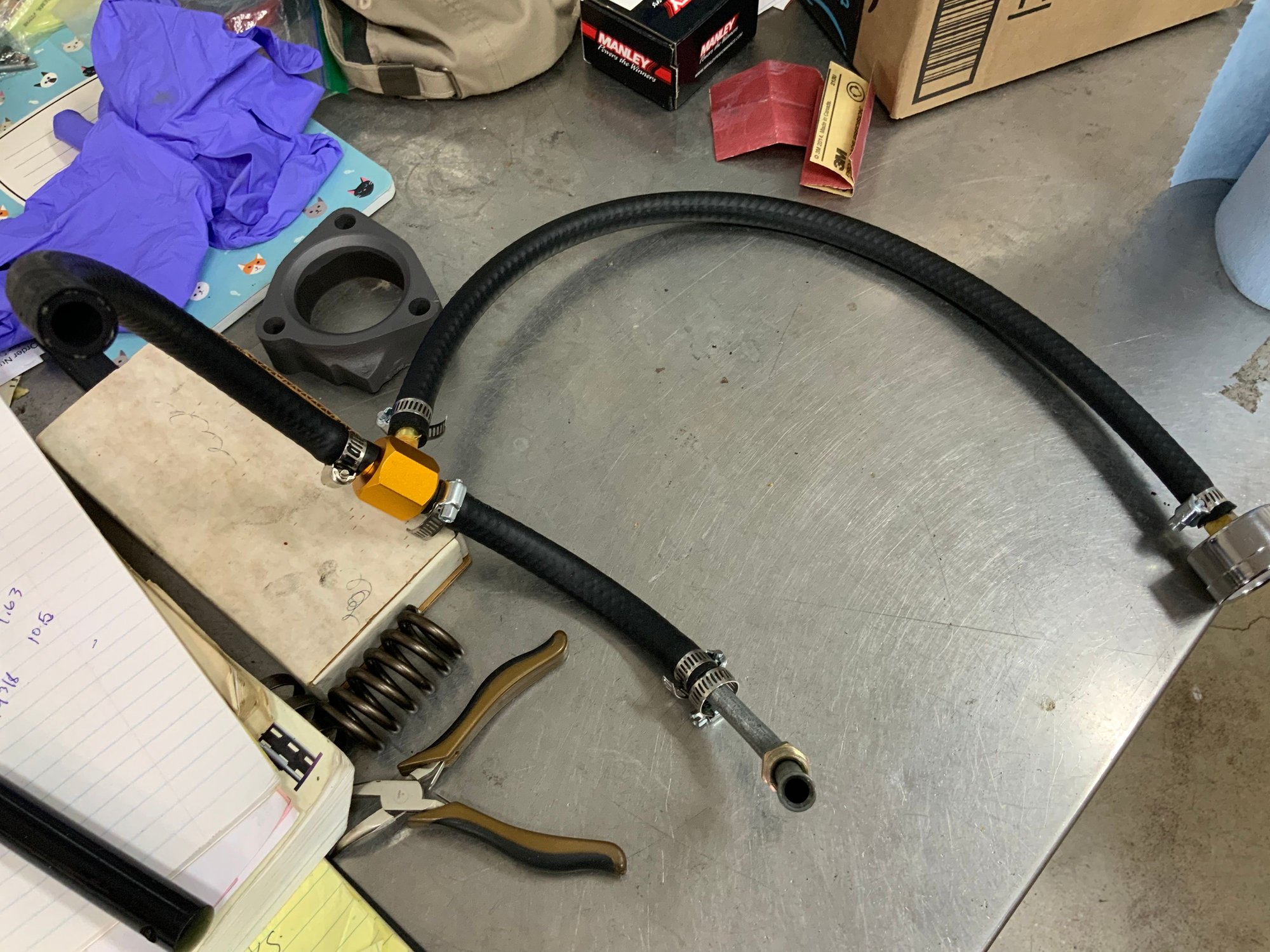

Here’s the configuration of the fuel pump pressure tester that I made by using a section of an old fuel pump to carburetor steel line that I cut and purchased a tee and pressure gauge from Summit. The steel tubing end threads into the carburetor and the open ended hose will slip over the end of the fuel line from the fuel pump at the carburetor end. This will allow the motor to run so you can observe the pressure.

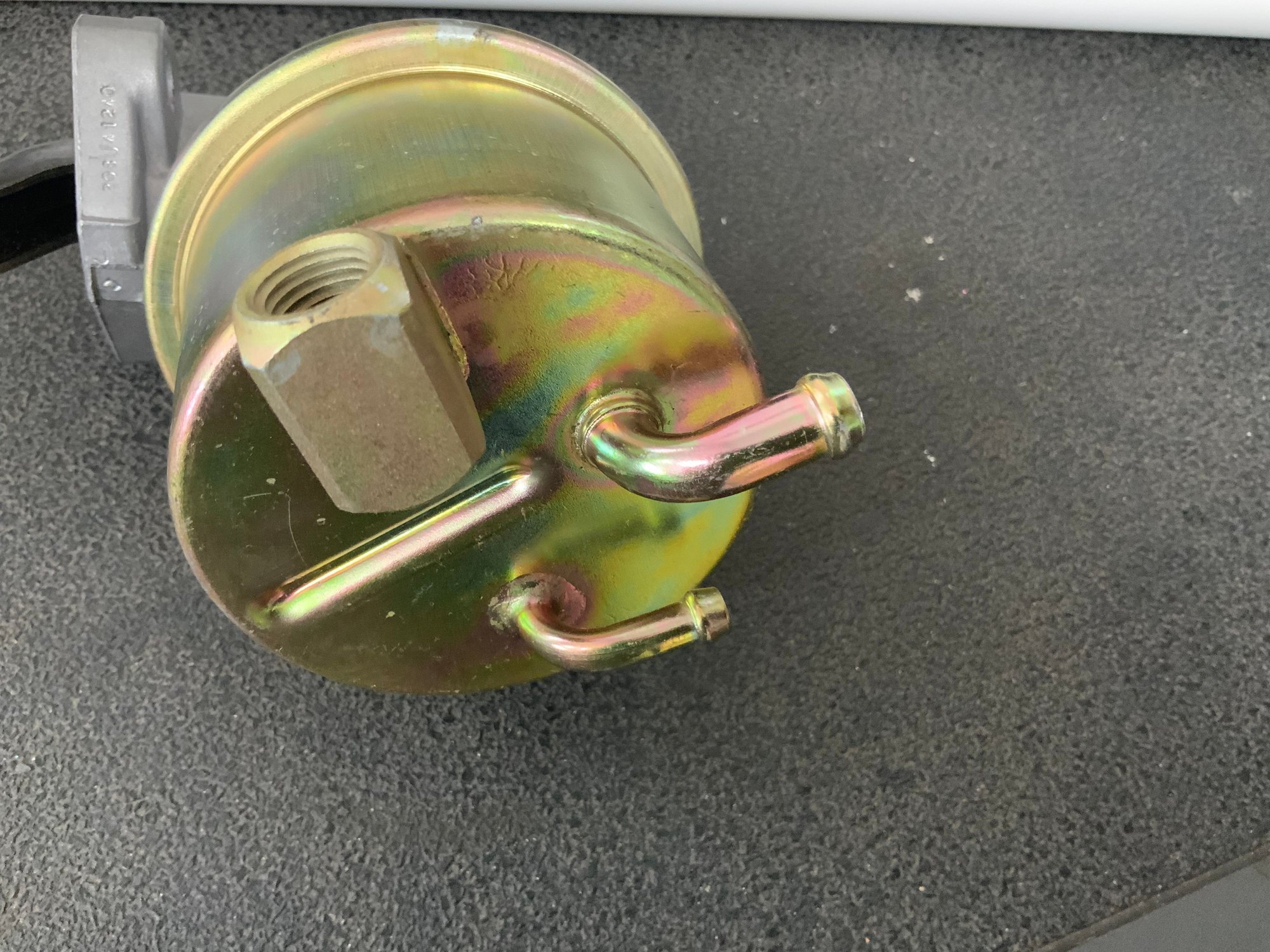

Also your fuel pump is not a AC #40769 fuel pump which would be original to 1970 L46. The fuel pump in the pic that I posted shows the bottom of a AC service replacement pump which looks the same as an original.
