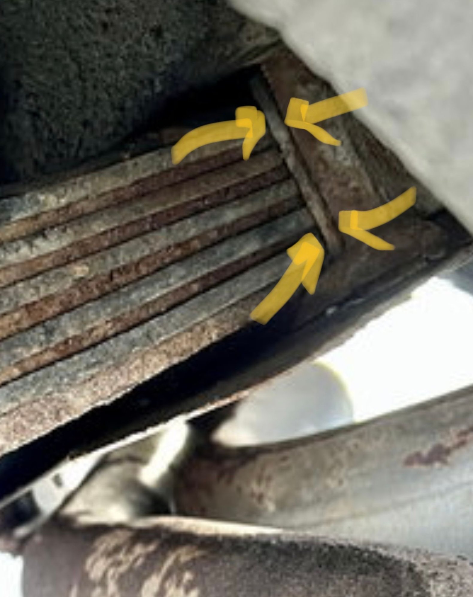

78s and 79s that had factory gymkhana springs used a 2 1/4" wide spring in the 2 1/2" carrier and shims front and rear.
If your 78 originally came with the gymkhana spring the shims should be there.
Altho when I purchased and drove my white 79 home 1100 miles I found this!!

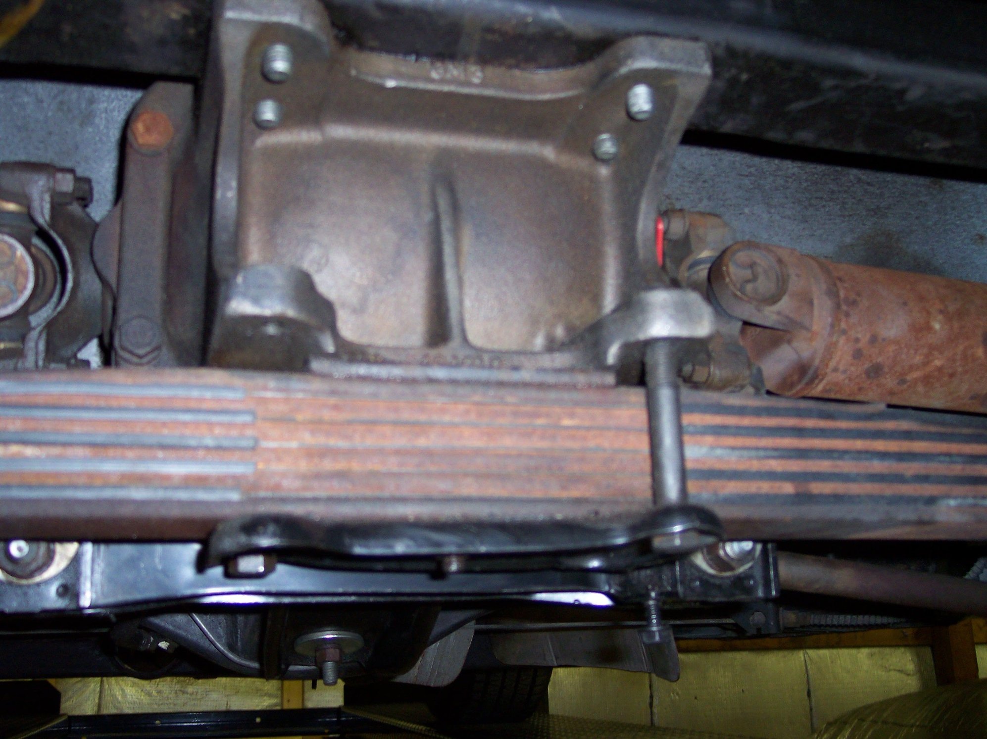

stock was 6 leaf gymkhana..eaton will be 7..note my link and see how mine fit, had to remove one plate. Watch bolt length…you need spacer plate too if yours is still there on 2 1/4…or not…pic of center of spring.?
Here is a picture. It does look like 6 springs but I wasn’t sure if the 7th was on top and out of view.

Your spacer is here..watch you length of bolt to not crack case. Note carefully washers as mine had some double..i replaced mcmaster carr in thread.
