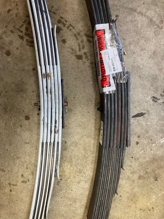

Originally Posted by 89vette
this is what is confusing me. you said you had to remove one plate.....
stock was 6 leaf gymkhana..eaton will be 7..note my link and see how mine fit, had to remove one plate
post 25
https://www.corvetteforum.com/forums...-spring-2.html

Originally Posted by kodpkd
Why would you have to remove 1 plate? Makes no sense.
the eaton spring comes with a thick plate.. it makes the spring taller than original. Remove the plate then the height is the same as original. Eaton confirmed ok to remove. It is not a leaf..note the original plate is very thin and the original leafs are thicker (6) than the eaton 7.
i suppose you can leave it..but make sure bolts are in far enough..I want to be sure bolts were as original depth. No more to possibly crack case..no less to possibly sacrifice holdng.

Originally Posted by interpon;[url=tel:1606344594
1606344594[/url]]the eaton spring comes with a thick plate.. it makes the spring taller than original. Remove the plate then the height is the same as original. Eaton confirmed ok to remove. It is not a leaf..note the original plate is very thin and the original leafs are thicker (6) than the eaton 7.
understood. I ordered the Eaton spring. It’s on back order and said he has 46 being produced in a few weeks. He also confirmed that no one makes the original Gymkhana 6 leaf spring.

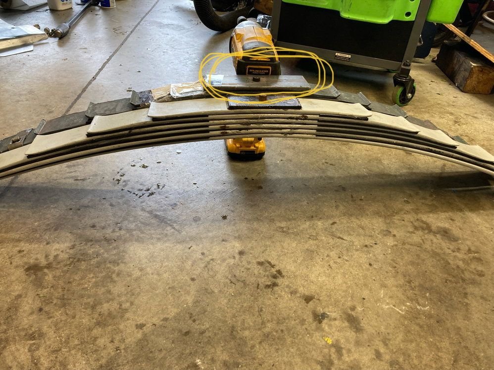

Someone already tried this:

Wow,,,, 89vette. This is the first time I have ever seen a spring that sagged out. You are correct, that end bolt has been shortened up more than enough. You can even tell by the upwards angle of the end of the spring. I hate to say it but with the rust, there is probably more restoration you could do on the suspension. Thanks for the picture.
Thats really bad. Those hangers are shot but the springs are too. They look like the ends are higher than the middle like a smile. They should be flat or with the ends lower like a frown.
