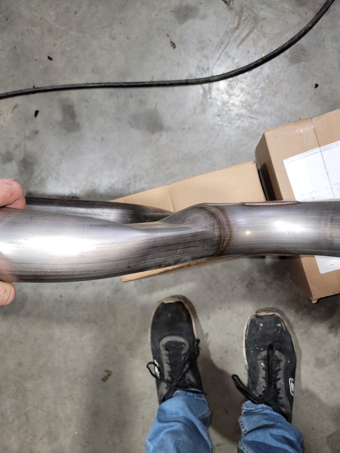

I recently purchased the Doug Throley Headers D334 and the Pypes SCC10V to install on my C3.
When I openned the box to start my install I saw there was a bent on boths sides of the X-Pipe.
I sent an email to Pypes directly but havent gotten an answer yet so I completed my install anyway.
I assume it is for the clearance but by looking at it it looks like it will restrain the air flow.
What are you tought on the subject? Have you purchased the same kit and received the bent pipes?

that looks purposely machine bent

All that trouble and marketing hype for mandrel bent......then you smash a flat in it.

What year is that designed to fit? I cannot see a reason for that squish on my 68....???

That is what I was thinking, it look machine bent in their factory. My only explanation would be to clear the handbrake cable which pass near this area.
Acoording to the description it is for "1968-1973 CORVETTE C3 2.5 INCH CROSSMEMBER BACK EXHAUST KIT WITH X-PIPE"

Send it back. There's nothing immediately behind the crossmember on a pre-cat C3 that requires the flats on the X pipe.
That and X pipes sound raspy. Find a system with an H pipe behind the crossmember. It will annoy your neighbors a lot less and will still run better than straight exhaust pipes.

One of the reviewers had this to say "The X Pipe has HUGE notches taken out of it on either side that literally reduce the effective size of the pipe in half. This is not reflected in any of the advertising photos. Per Pypes, the notches are for parking brake cable clearance, however they are nowhere near the location of the parking brake cables."
FWIW, Engine masters did a test on denting the header and what difference it made on the dyno but I don't know about the pipe being half the size.

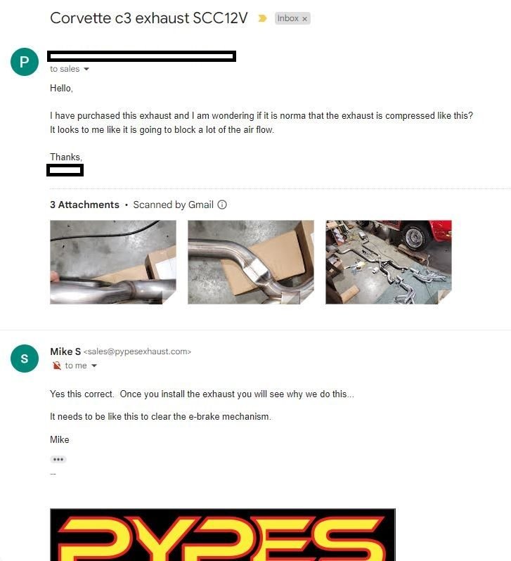

Received the answer from Pypes.
They confirmed it was for E-Brake clearance.
Not sure how this affect performance and sound but I managed to install everithing with a bit of work.
It will have to do for now. Worst case, I will get the flatten section replaced by 2.5 round down te road at a shop or replace the whole X.

That flattened section wont hurt performance at all. Even on a 1000rwhp build, that section would be the least of my concerns on this setup.
You'll be fine.

If flattened sections do not affect performance.....then what is all the hype and COST with mandrel bent exhaust?? Reminds me of the Engine Master episode where they dented the **** out of headers.....and nothing changed. No performance loss. All of this further reinforces my long standing opinion that much of this "performance" stuff is marketing BS.....and at best, has no obvious measurable benefit on a street car. On a race track...competing with other people who have good flowing exhaust...max performance....it makes a difference. On the street......I think much of it is immeasurable and just nonsense. I succumbed to it many times....we do what we do becasue we like to feel like we are doing something....but in the end....nonsense. Its all part of the hobby....even if we are just fooling ourselves.
To the OP.....I am not buying Pype's story......I have 2-1/2 inch mandrel bent pipes coming out of the crossmember holes....and my E brake cables clear them just fine....no flat spots.
