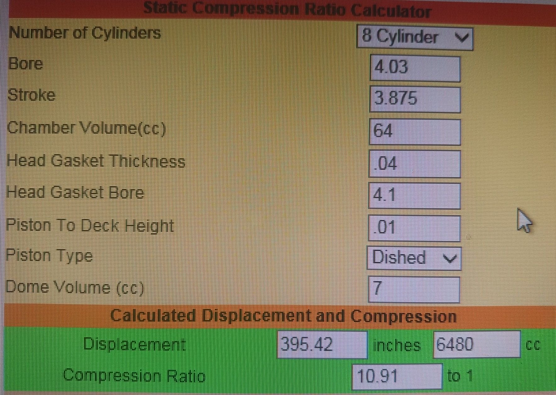

I went with a 383 crank, I was concerned about rod to cam clearance.
I also wanted to keep my compression ratio around 9.5:1.
While plugging numbers into calculators and researching kits I discovered it's easier to keep the compression low with less stroke.
I also used a calc for cr and was surprised how little it added.
about .35 in my choices.
