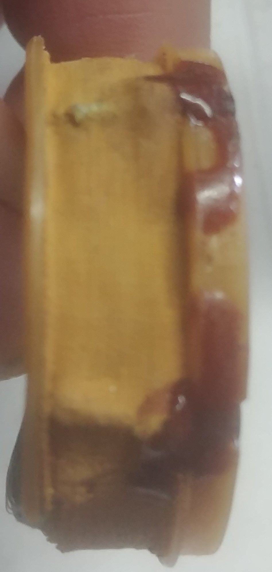

Default Problem Solved!!!!
Here is an update on issue of the car randomly dieing while being driven.
I have driven the car over 500 miles during the past week after swapping out the distributor with a new one.
I am happy to report that the car is running great with no repeats of the engine dieing.
The new distributor seems to have resolved my problem. To be more specific, I believe that the problem was the pickup coil in the distributor.
As part of my testing this week, I took the control module, rotor, distributor cap (including the ignition coil) and installed them on the new distributor.
This left only the pickup coil and the 4 wire harness that comes out the back of the distributor (wireharness nearest to the fire wall) as the only new parts on the distributor. I don't believe the problem was the wire harness. This leaves the pickup coil as the likely cause of the engine stalls.
I had previously installed a new pickup coil assembly on the old distributor with horrible results. The car would start and run fine until the distributor had a chance to heatup (about 4 minutes of running). The it would strts mising and get progressib=vly worse until it would not run at all. This happened on two consecutive days.
I believe that it was a bad puckup coil assembly. The coil assembly was a very tight fit to the old distributor. In fact the distributor had to be put in the freezer i order to shrink the shaft enough to be able in install the coil. Even then slight tpping with a hmmer was needed in order to get the coil assmebly installed. I think this was the root cause of the new pickup coil failure.
Also, I did an autopsy on the old pickup coil assembly and found the coil coil to be quite brittle. I came apart when I tried to remove it from bracket that held it. Also, the bottom of the pickup coil appeared to have overheated. The bottom of the coil had a brown caked on substance n the bottom.
Pictures shows the leakage from overheating. This was all over the bottom and on the assembly bracket.
