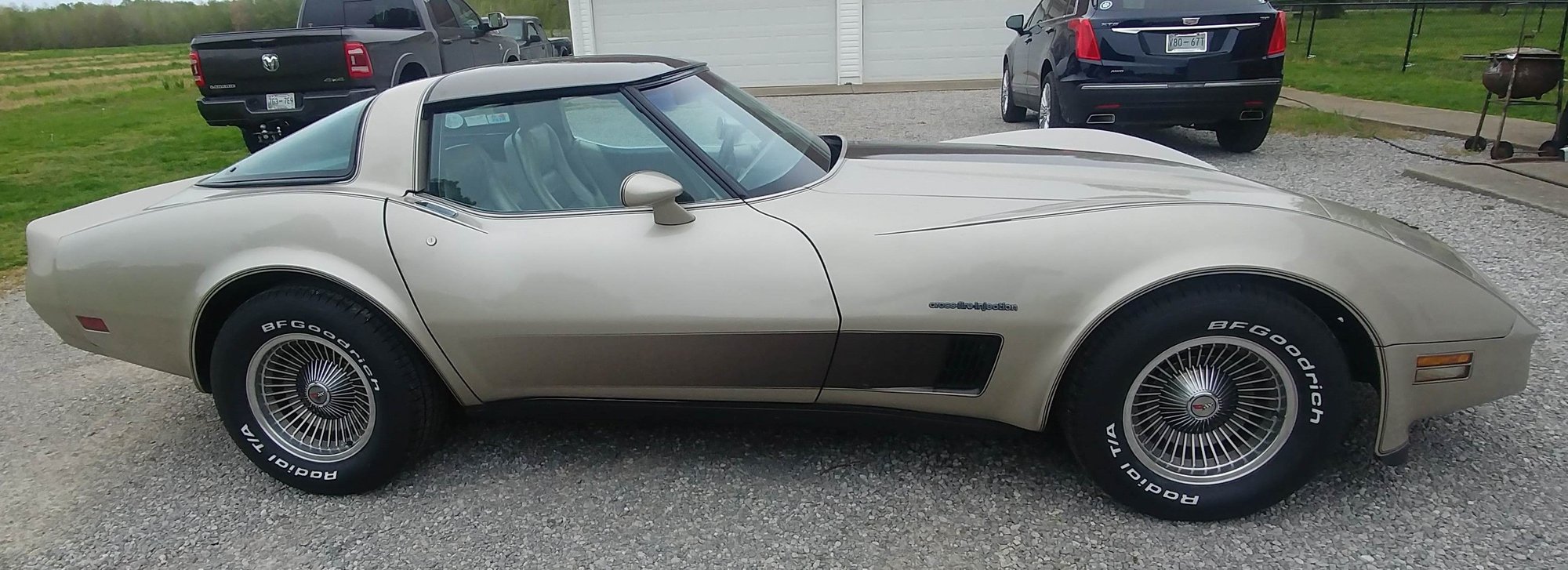

After all that, at least post a photo or two of your car!

Default Pictures as requested.
Pictures.

Every 82' Crossfire came with this feature / standard .........................
Beautiful car ! Love the CE's

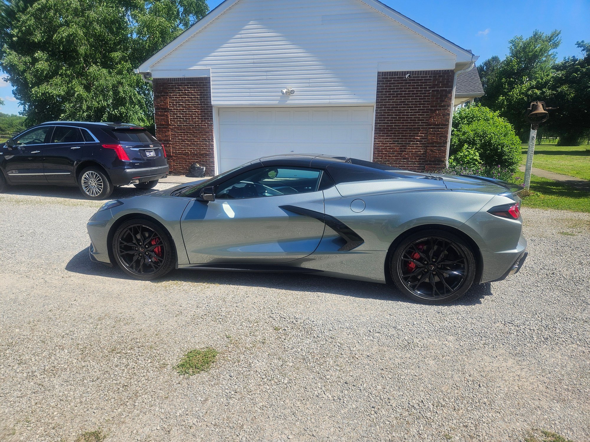

I traded the 82 Vette for a new 2024 LT2 Convertible the end of May.
The 82 was still running great at the time.
24 Hypersonic Gray
