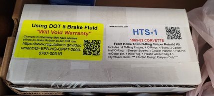

this O ring convertion kit came with what I feel where some really crappy looking O rings.
It was brought to light by a fellow former member that in the early days of these O ring convertions that the slight mould seam on the O ring would wear and then cause leaks. So the Corvette aftermarket sought out O rings with the seam offset.
My research seems to show that this is the approximate time the DOT 5 warnings came into being.
It seems that one rubber compound seems to work well with both DOT 3 / 4 and DOT 5. This is the EPDM rubber compound commonly used in brake parts throughout the automotive industry for approximately 50 years.
However, when special O rings where manufactured specifically for Corvette calipers. This is not the rubber compound that was used. Thus this crappy looking O ring that doesn't like DOT 5.
the rubber they use does play nice with DOT 3 and 4. But doesn't like DOT 5.

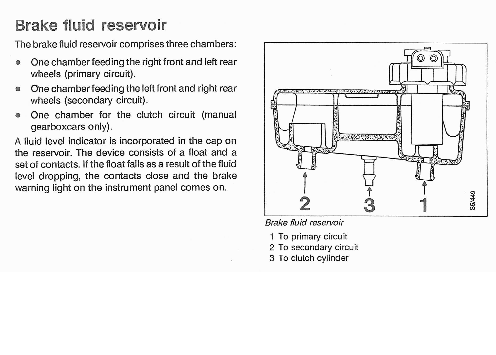

I happen to see this thread as I was sitting here having coffee looking at a brake system for an old Saab with a manual 'gearbox'.
Just thought it was interesting, check this out. It needs DOT4 so I am taking the radical step of using DOT4

This is the box my high-heat O-ring kit came in from CSSB Inc, which presumably contained EPDM O-rings.
EPDM is an "old school" elastomer for brake components. It's perfectly fine with silicone fluid, as well as the other DOT fluids, and always has been. The Raybestos caliper seal kits contain EPDM seals.
Don't presume that CSSB calipers use EPDM - maybe call them and find out what they purchase. I believe the boxes contain the warning because they are not strictly sticking to one elastomer or supplier and are DOT 3/4 elastomer shopping for best price.

The O ring convertion kit I purchased is cssb branded. And has the DOT 5 warning on it. The Orings look and feel cheesy.
I honed my old caliper, it's well within spec. Not so much for the "New" one I purchased. I assembled it with Viton O rings. But it'll be a couple weeks before I get the chance to install it as I have other projects at the moment. But I will keep you all posted.
