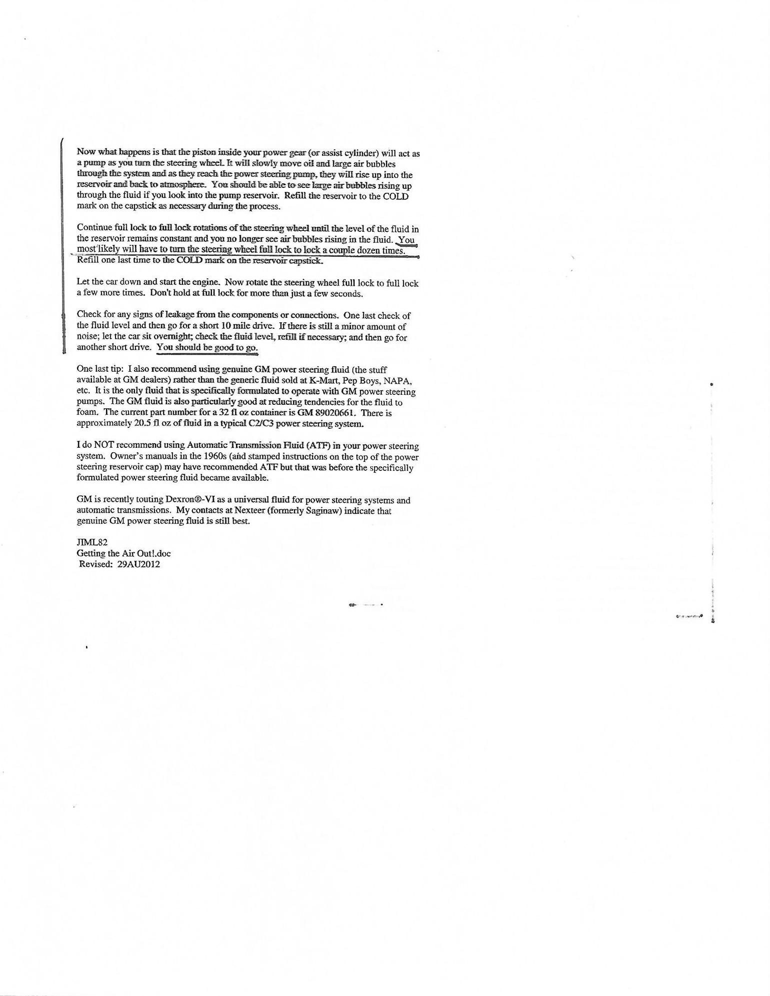

From: mount holly NC
Jim Shea recommends turning the wheel lock to lock several times with the engine off to get the air out.
You might try this before you have to remove the PSCV again.

From: Newcastle, WA
