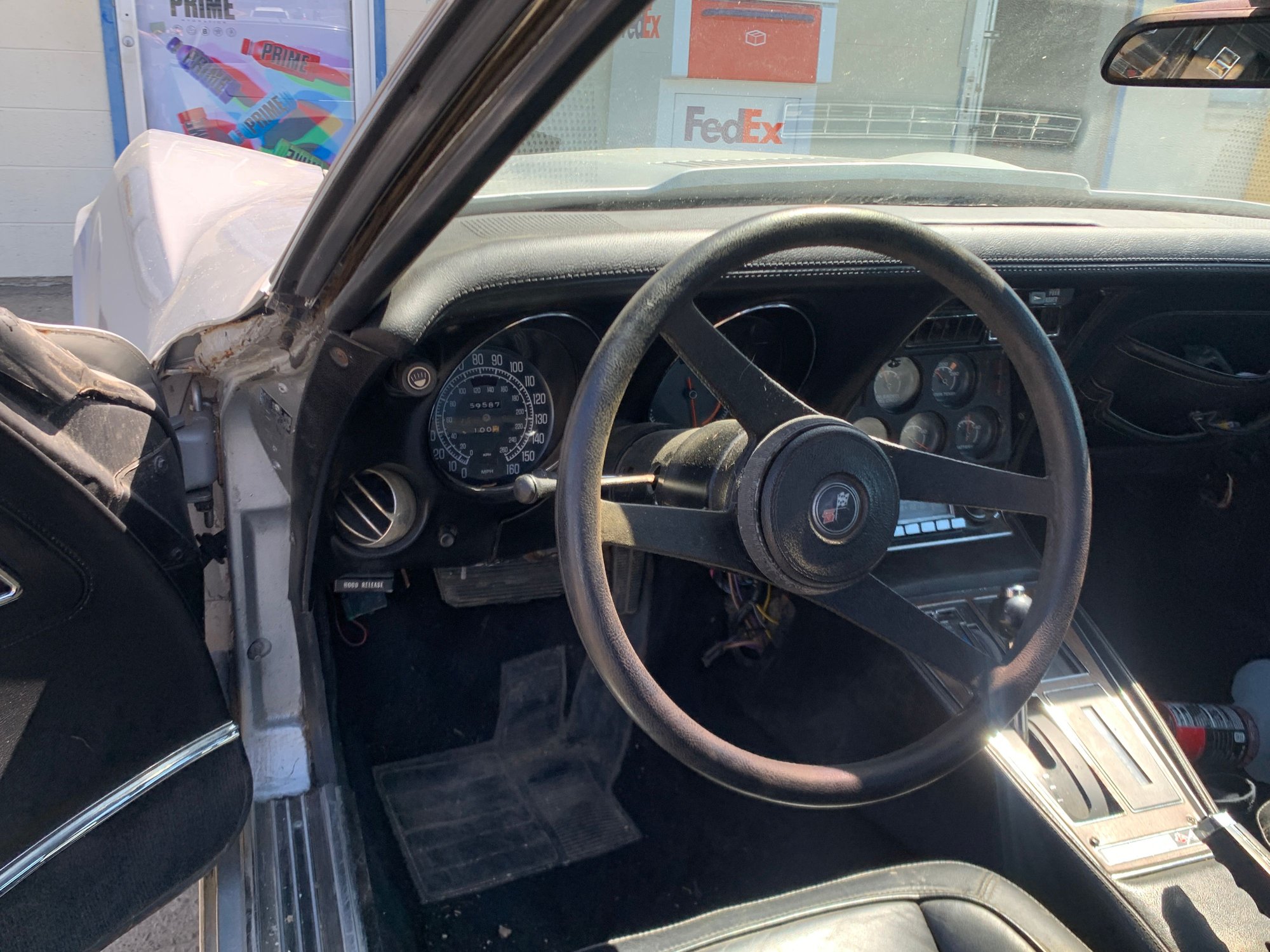

I just. purchased this 76'
Im excited to repair and drive this car.
What I've discovered so far
-80's rear bumper
-Interesting old school made in los Angeles centerline rims
-Exhaust leak
-Suspension causes, all over the road feeling
- Multiple leaks (of course)
- original radio works
- headlight actuators and wipers work!
- interior redone nicely a few years ago
- decent silver repaint over original silver
I want to enjoy this 76' as a driver my 71 vert had perfect paint and I was always worried about scratches etc.
