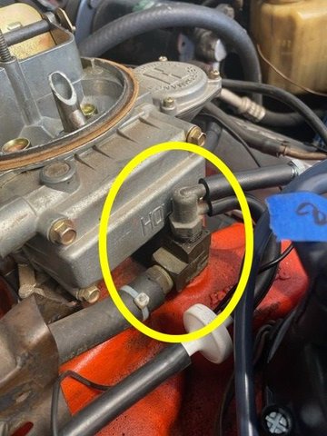

Allen,
What he means is, on Holleys the metering block, which is sandwiched between the fuel bowl and the main body have a vac port. You have yours hooked up there.
It's also called "timed vac port". It's for emissions. It also kills on performance you may desire. Just cap it off with a rubber nipple, not needed.
Your distributor vacuum canister should be connected to Full Manifold Vacuum. Your choice where to accomplish that. All those manifold ports have the same amount of vacuum. Some carb base plates have an extra port in the front or tap into the Intake itself. But never use the P.B. line.

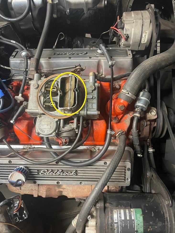

See photo. Is this what you're saying? What is P.B. line?

Got it: P,B, Line. Power Brake. In the photo below the PB line, headlight vacuum and the plugged line are all going to one manifold port. Should the PB line go to a dedicated port and the others go to another one? Is this what you're saying? I DO APPRECIATE ALL THE HELP. I want to get this right and learning as I go along. Also, LARS stated my carb was very small. Do you know what the proper size would be for this engine?

Looks like 6R8025 B

There's a steel line connected a hose from the lower front of the carb in your picture - where does the other end of this go? In my experience this steel line runs between the distributor vacuum advance and the carb but yours isn't using it that way. The only other thing I can think of that needs vacuum on that side of the engine is an automatic transmission modulator. If this is where the steel line is going, plug the trans vacuum into the hose with the bolt and run your distributor advance off the steel line, leaving it where it's already connected to your carb.

I'm beginning to suspect there is not a number on the airhorn. Do you see anything at all on the vertical sections of this part?

looks like stock cast iron,,spread bore.
allen, do yourself a favor and find an appropriate rochester
someone can give you the number to look for

Might have found it. 80457-7 0067

That steal line goes down the front of the firewall I assume to the trans.

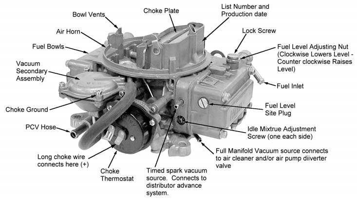

Here's a port diagram from a Ford forum .
Where it says "timed spark vacuum source", that's ported vacuum. While technically correct for as-delivered, it is not best practice for your car. Your car will idle terribly without vacuum advance at idle. Connect the vacuum advance (directly, no Tee) to the "Full Manifold Vacuum" port, and move whatever else you need to somewhere else (it looks like the manifold port behind the carb is capped for some reason?)
Email @lars for his timing papers. You should be able to pick up a bunch of performance from some simple adjustments.

I see now... the steel line from the trans has been straightened out a bit. Connect that to the manifold Tee with the bolt in the hose. Then connect the hose that was on the trans line to your distributor vacuum advance. You'll now have full vacuum for both components.
Yes, PB should always be a solo, dedicated line. Any outside source of vacuum interference such as accessories could affect your brakes.
As to post 25, yes cap that unwanted "timed" port. Not needed.
Yes move that hose from the metering plate to Intake manifold port.
But first, swap the PCV Valve with the valve cover breather. Find a new home for that hose.
