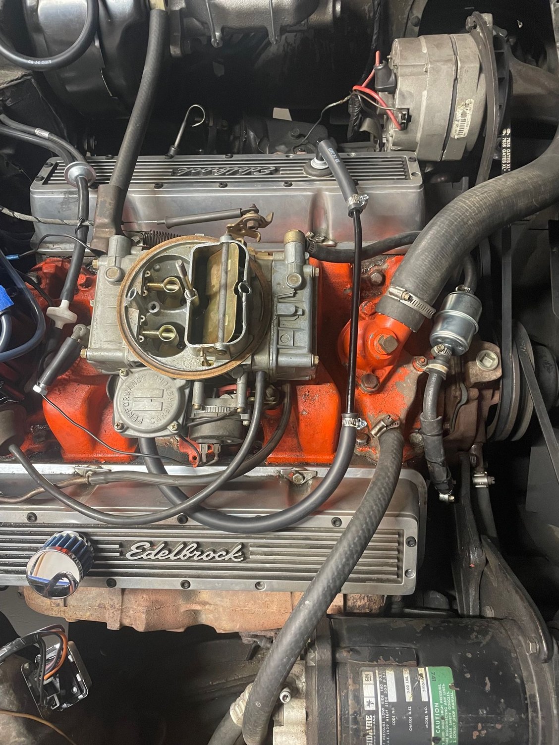

Recently purchased a 75. Runs very good except slight hesitation and rough idle. Had a local mechanic replace plugs, wires, distributor, rotor and set timing. Really didn't do any good. He said it needed a new carb and went into why but I can't remember exact words . Anyway, Yesterday noticed gas collecting in areas shown in photo. So I assume the carb does have issues. It's a Holly 600. I would rather get a new one than rebuild this one. I don't need anything fancy, just want the car to run as it should. Holly 600 a good carb? In your opinion what does the photo tell you? Is it ok to drive the car until it gets fixed? Thanks! Sorry I forgot to add the photo. Here it is.

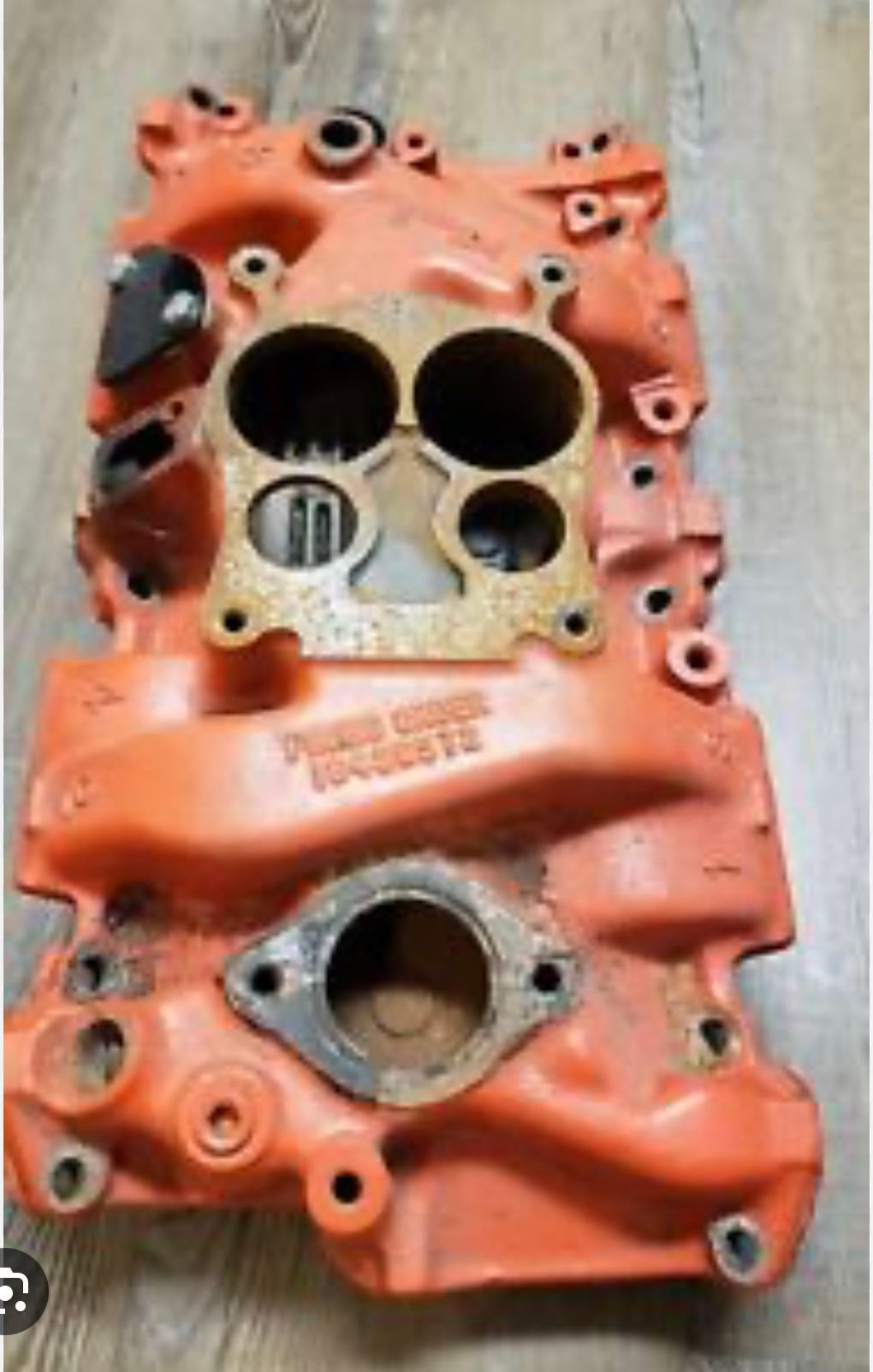

‘75 Corvettes didn’t come with Holley carbs, only quadrajets. So the factory intake manifold will look like this.. Which is a spreadbore manifold, which also means your engine is not exactly stock/original.
Actually, just took a better look at your picture. You have an Edelbrock performer intake on it. Definitely not original.

Without knowing what intake you have, no one is going to say yes or know to that question.
Can you identify which Edelbrock Performer intake is under there? They made both square bore (Holley) and spread bore (Q-Jet), and using an adaptor will make your car run like garbage.

ALLEN007
Step back some and take some more pictures of the engine. Some where we can see the manifold and the whole engine. If there is a part number on that carb, then get a picture of that also.

Only numbers I could find are 6R8025.

The carb you have is a good (but very small) carb. Any "new" carb you buy will need to be properly set up - there is no new carb that will run correctly right out of the box. You're much better off just properly setting up what you have. I see that you are running your vacuum advance off ported vacuum, which means that your timing is severely retarded. Badly set timing has a much greater impact on engine performance than the carb setup. You have tuning and setup problems that are not related to the carb. Set your engine up properly, give it a correct level of tuning, and adjust/set up what you have. It will run great. Just replacing the carb with another new carb that needs a setup will gain you nothing, no matter how much money you have in your man-pants. If you chose not to properly set up and tune your parts your car will never run well.
...and FYI - the carb list number is stamped right into the choke airhorn on the forward driver's side.

Love Holleys, as shown on my avatar. However, that 600 in my opinion is not correct for SBC. The fuel inlet is on the opposite side of the fuel pump. It almost looks as though the fuel bowls should be swapped for proper fuel connection. But that's not feasible.
Your factory carb was 650 CFM. So, you downgraded. I think I would look into a different Holley, 650, with fuel inlet on the passenger side.
Also, bubba hooked up your PVC Valve so a vacuum line is routed all the way across the engine to the rear of the carb. A better solution is to swap the PCV Valve with the breather. It will be a "short-cut" to the vac port for your PCV.
Which is now plugged with a bolt?
It looks as though the fuel bowl and metering gaskets are non-existent or are smashed down so much that, that is likely your fuel leak. Those gaskets are easy to replace, but get the blue, reusable thick ones. And use only Holley parts, not knock-offs, "fits Holley blah-blah-blah.

A couple days ago I had plugs, plug wires, distributor and rotor replaced as well as timing done. Sure gets confusing. Thanks for the input.

Good idea on swapping the PCV over (I'm still learning). Also, the tube with the screw went to the Charcoal Cannister. That fitting has two ports. One goes to the headlight system (which I just replaced everything) and the other to the Cannister.
