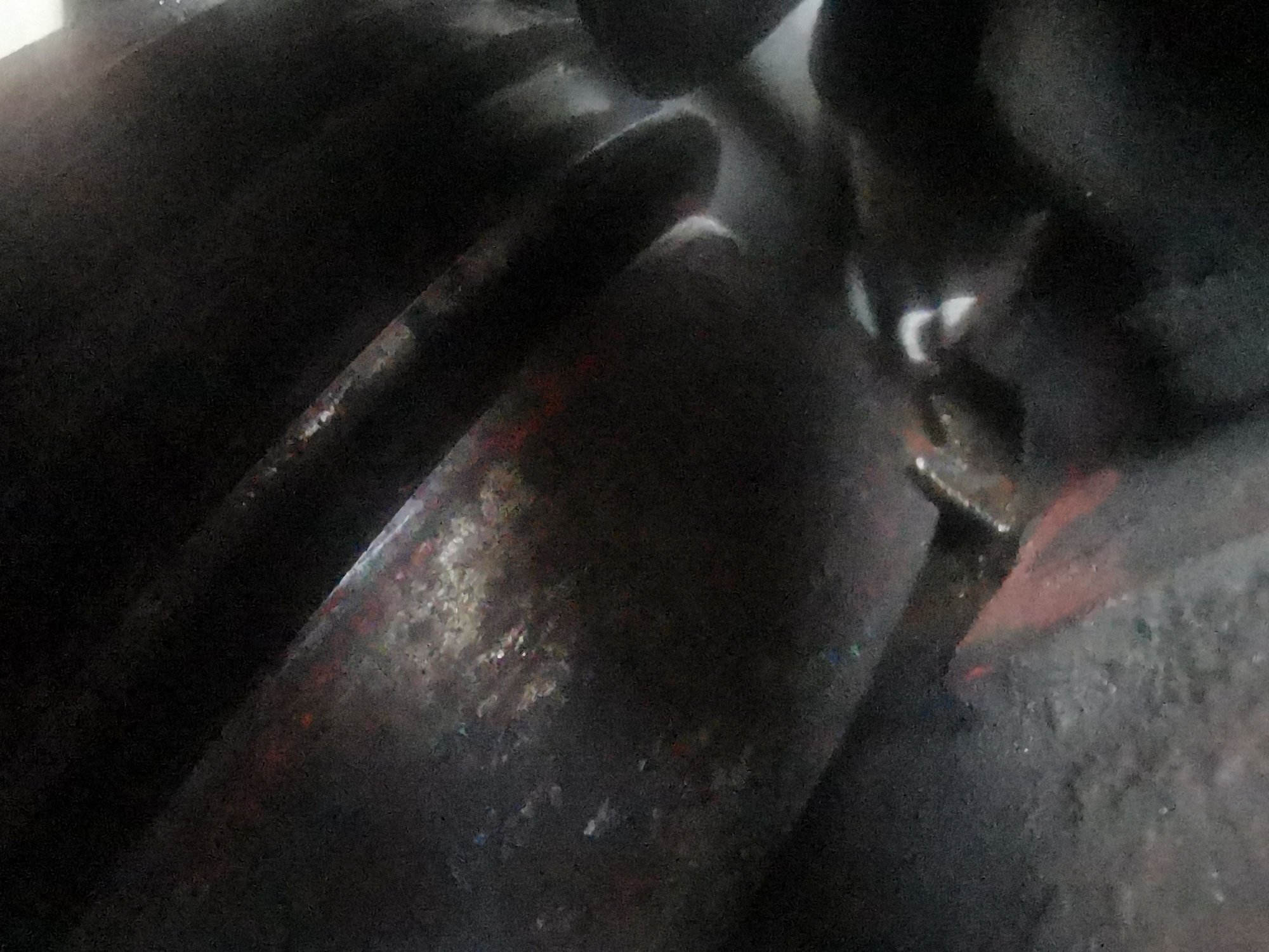

That's the best I can get. It's right at the top as said timing light has a hard time getting it.

That doesn't look like standard GM/Chevrolet and that tab appears to have had some extracurricular modification done to it. Sorry to be a pest about this. Can you upload a couple more from 1 foot further away, 2 feet further, and the entire front of the engine with fan to intake? I'm not as interested in seeing the tab as I am the timing cover and other front-of-the-engine components.

the tab is not modified. Its jagged like that because its impossible to see the numbers on it, so its made with valleys and peaks so you can line it up by counting peaks or valleys were you number is. its only like that until about 16 degrees before. O is in the first valley, its 4 degrees to the next valley. Thank god its like that or you would have to draw a line on it to tell were to line it up. Also, I had to get that close with picks to see it. If I move 6 inches more away its too high and you cant see it at all. You can tell its right at 12 oclock because you can see the head of the fuel pump in behind giving reference. Dampner is blue and orange, motor is orange. THis may help. Had a bad day and out driving the clutch packed it in on the A/C. Took out all the belts, lol. SO bought new ones from lordco. They were too short???? So went back, they checked numbers and they were right, but they said there are 2 350 motors, and I have the High Performance one and the belts are bigger. Got new belts they fit. Had a chunk of old belt and sure enough the number on it matched the longer belt number. So apparently I got the good motor anyway. If I went new Id go with the builders advice and get the one I said above anyway. THe newer 4 bolt main engines are much more robust. Also explains why it goes like a scalded dog. It does feel peppier than other 350s Ive had. Vettes are light tho, so that too.
I suspect you have a mismatch of parts that could be causing timing problems. C3 Corvette 350 engines had the timing tab at about 1:00-2:00 when viewed from the front of the engine. It also appears from the pics that the relationship between the tab and the balancer shows much less "overhang" over the balancer than I've seen in other examples. If yours is indeed at 12:00 then it seems you, at minimum, have a later timing chain cover. Trying to time a standard Corvette balancer to a 12:00 timing tab would make your timing so far advanced that it would ping like CrAzY! Is there another (perhaps homemade-looking) line on your balancer about 2" away from the deep one?
Check out this message on Jalopy Journal that seems to match your issue – they start to identify the issue about 1/2 way through the first page of the thread:
https://www.jalopyjournal.com/forum/...#post-11966616
To really understand what is going on here, providing the block # off the back flange where it connects to the transmission as viewed from above would go really, really far.

The blue paint on the harmonic balancer, and on the timing tab on the timing chain cover, also indicate that something is amiss, or at least that someone has been in there before.

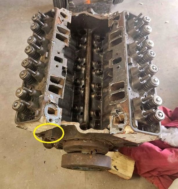

Post A Photo!
It was easier to pull photos from Facebook Marketplace than to walk into my garage, but my 79's motor looks similar (though my timing tabs are in the offset location, not at the top as this one appears to be).
This stamp pad (circled) is squareish, indicating a late 70s, early 80s SBC.
The casting number (circled in the second photo), reads 14013679, so a 350 from 77-82, could be 2 or 4 bolt. The internet will find whatever number you see on your block.
To Timing, how to

Real hard to read, but there you go a number and letters. Small tab looks like T1025ckH

I agree with CKH, too bad you just missed the last character.
The three options seem to be:
CKH 1972 307 Powerglide 130 2 F A X/Apollo/Ventura
CKH 1973 350 m/t, 4 spd, NB2 L48 175 4 F A X/Chevelle/Monte
CKH 1974 350 m/t,3 & 4 spd, NB2 L48 160 4 F A X
Option 1 is 307ci, so hopefully not that.
So not a Corvette engine, but period appropriate.
https://nastyz28.com/gm-chevy-codes/...s-suffix-2.php

There was only half the H. So last number didn't hit the plate
