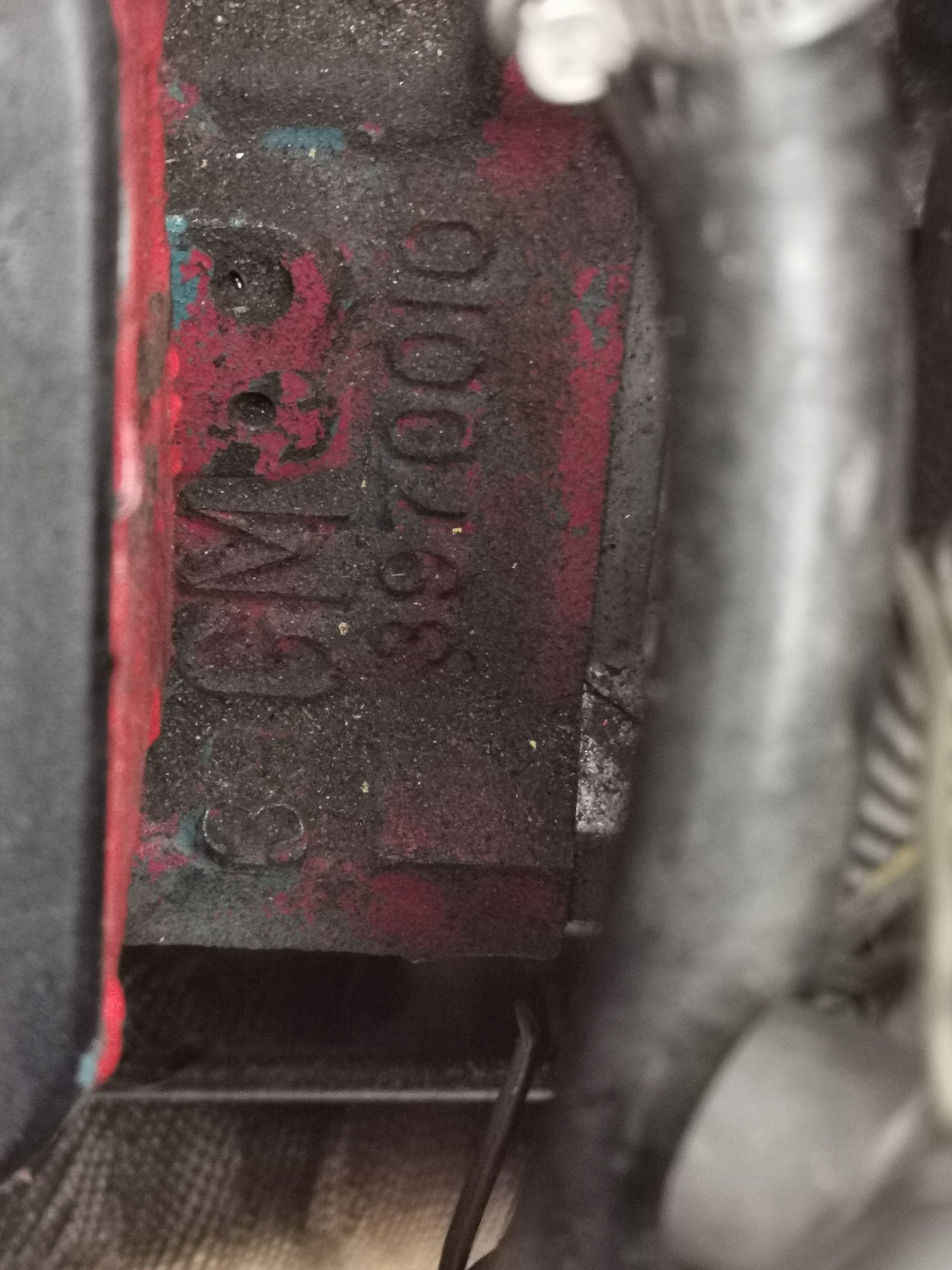

I got the yellow accel super coil, the none liquid one. Think it was 42000 volt? I have an msd black one too but it's 45000.
Pics are for everyone asking. Found that engine #.
I just looked that up. It's a 69-79 corvette 370 motor! Is that horse power or torque. Says 350 torque on shifter thingy. That's great, now back to pinging. Should I open that gap up a bit, maybe not 45 but 40? Lol.

In the back there is a much smaller set of numbers/letters for the casting date.

Originally Posted by Jebbysan
I seriously suggest you E-Mail Lars at V8fastcars@msn.com and get a copy of his timing paper. You are confused and believe that not only is your timing pointer in the wrong spot, but the balancer is spun as well. This needs to be verified before you can go any further.
Not one automobile built from the 50's to the 90's had a factory timing spec that was conducive to performance or efficiency....not a single one. They all had an emissions friendly timing spec.
The only way to set timing is with the total advance method. This is not spelled out in any manual and no manufacturer has a procedure for it.....but it is the way that ALL professional engine builders and tuners do it. Vacuum advance is unplugged for timing set.
Base/Initial timing is soley a product of total timing.....you do not drive at idle so initial timing is not important except as a reference. I have set timing on hundreds of 70's small blocks and they run best around 15 degrees of initial timing.....but that is becasue the total timing is 36...which is where most small blocks want to be. At 8 degrees of initial....your total will be about 28 degrees which lose a significant amount of performance and elevated coolant temps......
Get Lars paper to understand what timing is all about.....it is not that difficult but about 99% of people get it wrong as most were never taught correctly or refuse to believe the factory spec is wrong. Even into the 90's, all cars were timing soft.....one of the worst was the 5.0l Mustang LX/GT....which had a Ford spec of 0 degrees....if you move this to 7 degrees, the car will pickup a half second in the 1/4 mile.....huge. Computer controlled cars were all set at base timing because the computer controls total timing and it is impossible to check free revving the engine in park......so this adds to the confusion.
At any rate......no low compression engine will ping at 8 degrees base......even on 87 octane or lower.....so something is wrong.
The timing pointer should be at the 2 o'clock position.....but some early covers have the timing mark at 12 o'clock....which is a pain as no one to my knowledge makes a balancer that has the correct 12 o'clock style timing scribe.....so this is another potential screw up.......
Jebby
That number is from the back? Drivers side by end of head.
The casting date on my 72 is on the aft passenger side just before the bell housing. I can see it by looking from the top just behind the head.
According to my Corvette Black Book, you have a 70-72 LT-1 block. 3970010, date code on pax side will give you the year.
