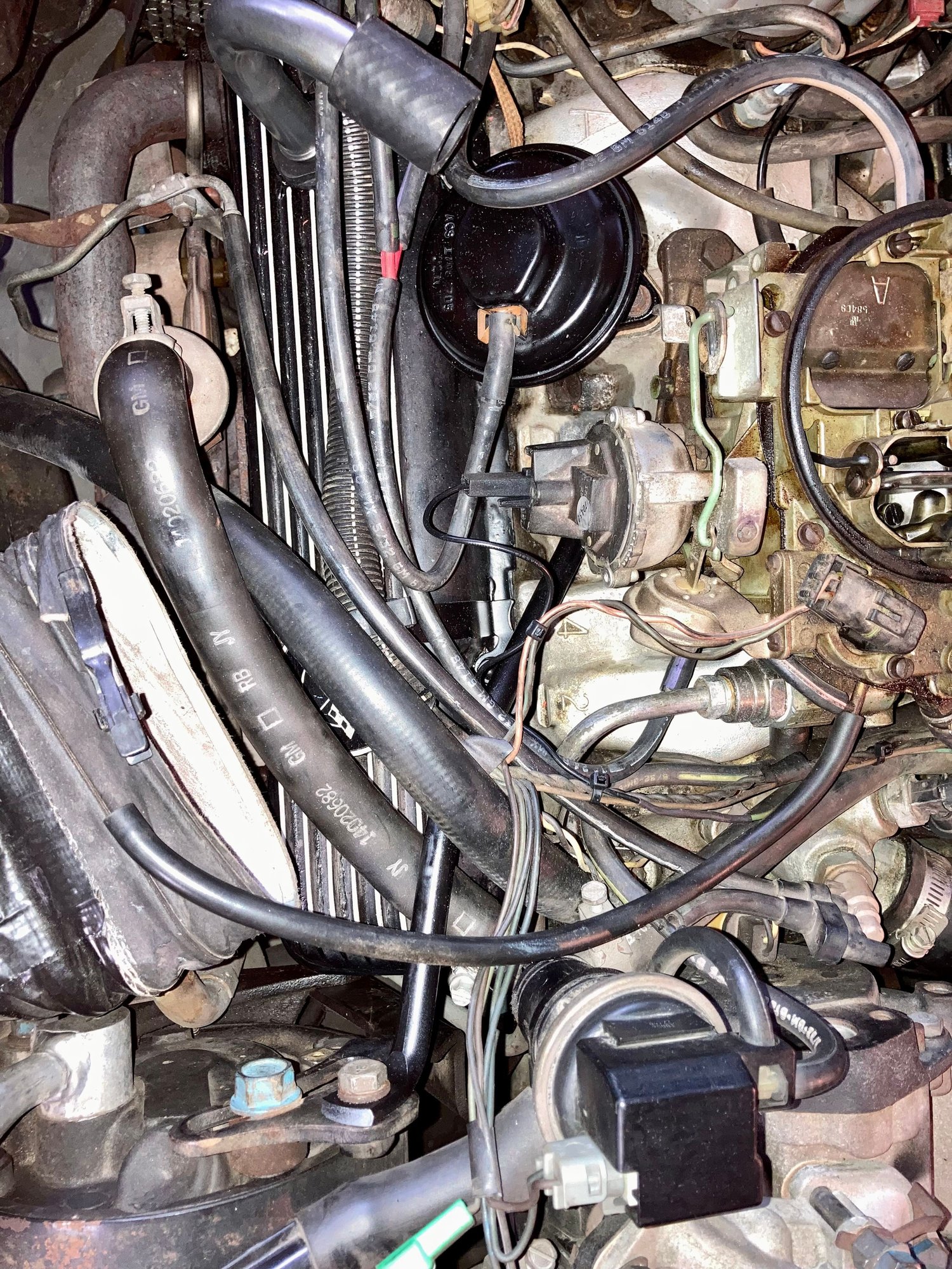

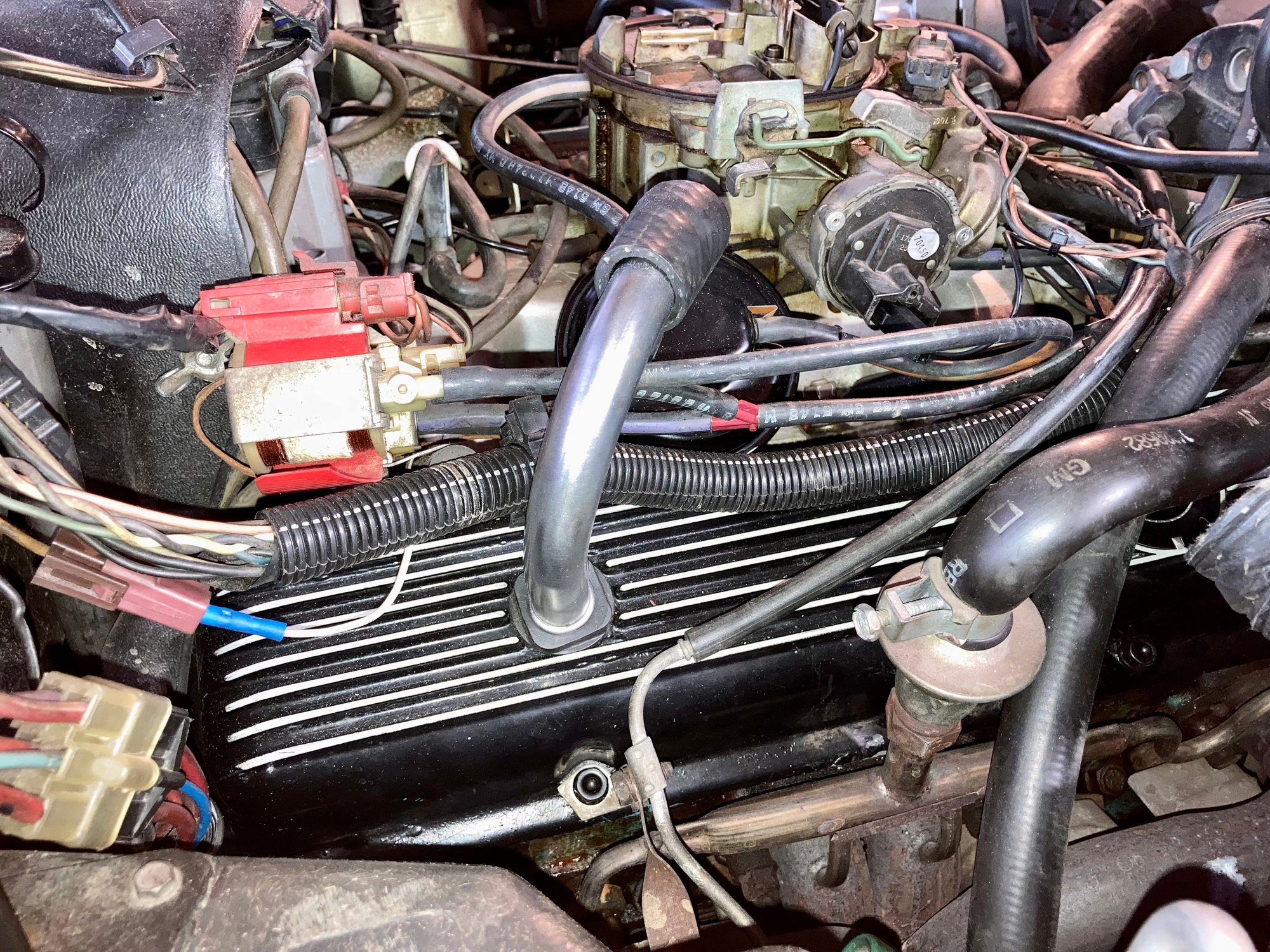

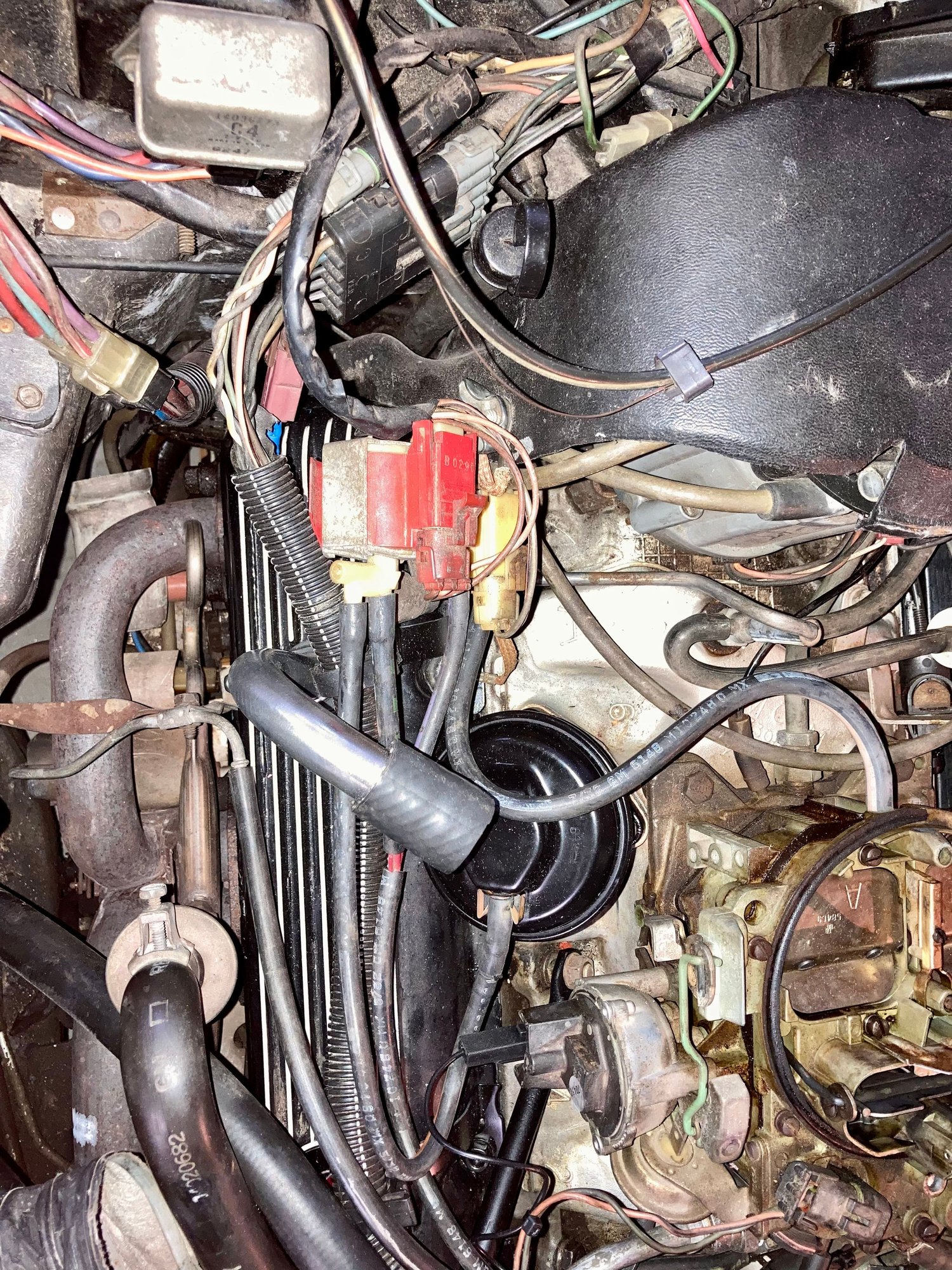

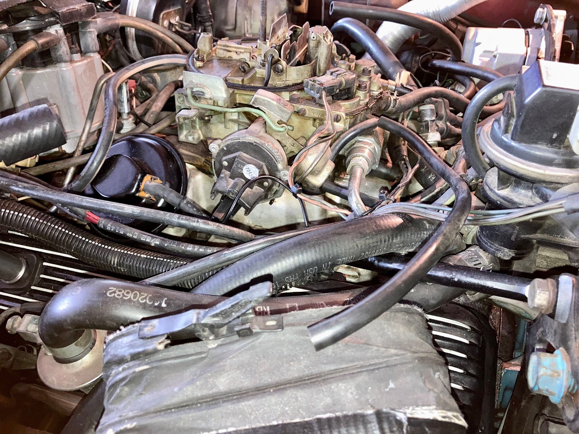

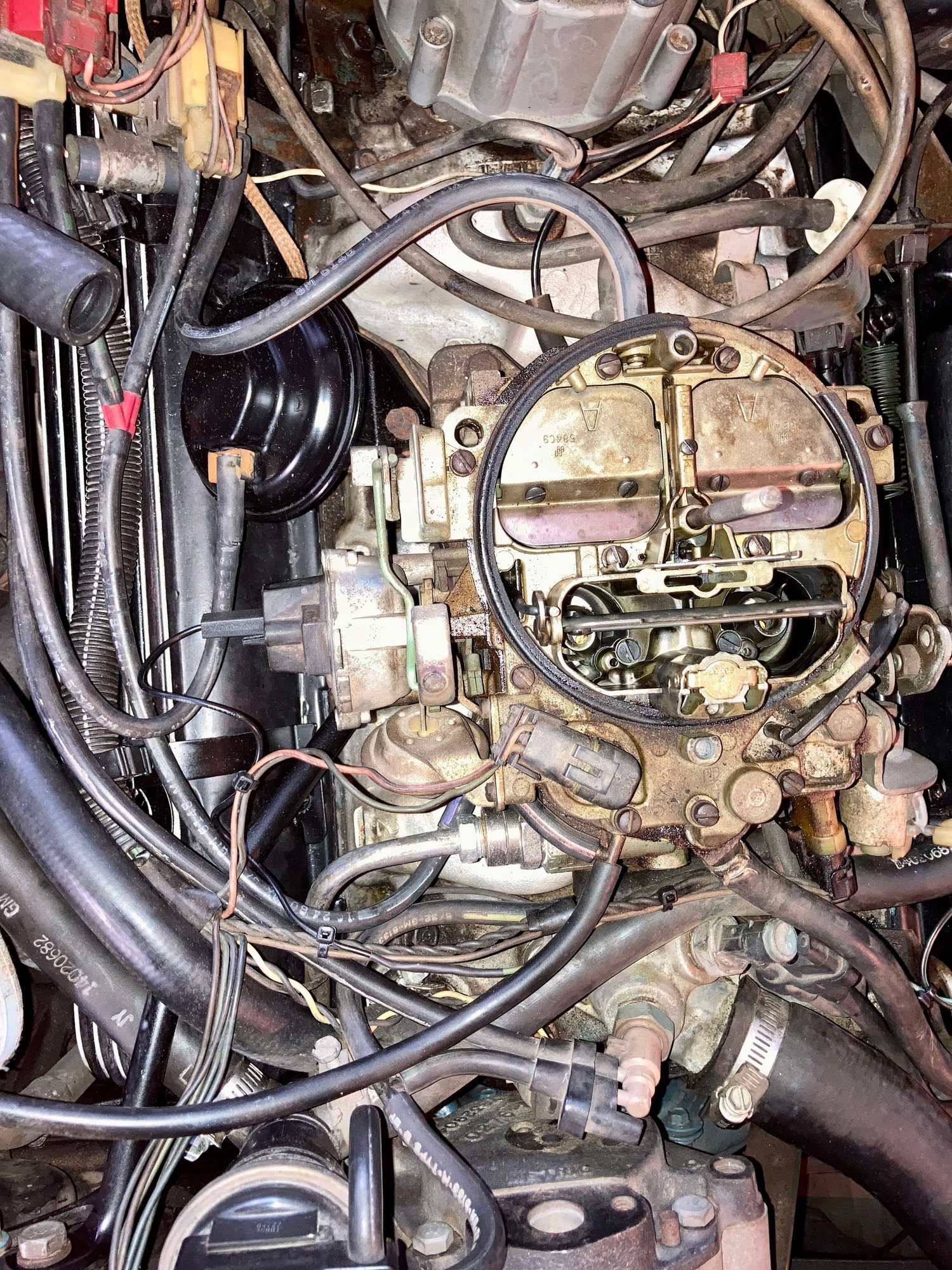

no check engine light?
carb is ecu controlled.
there are a lot of wires and hoses over pass side valve cover.
egr stuck?
pics will help

Calwldlife, thanks for your reply.
There is no check engine light on.
I’m not sure if the carb is ECU controlled, it’s a stock QJet.
Now, about the EGR, is it highly sensitive? I did have to remove it to get the passenger side cover off and while it was off, I cleaned, taped and painted it. I did try to remove some of the soot from the underside.
It looked like it could be original.
I tried to route the hoses to the way they were when I disconnected them. Is the concern that they may be too close to heat?
All of the pics are from the passenger side.

carb is computer controlled
if egr is hung open then it will stall eng at idle.
egr gets vacuum from tvs valve, heat allows vacuum.
these cars run well but systems need to be in good shape.
factory service manual is essential.

Lots of vacum lines and therefore connections.Real easy to crack an old hard hose or otherwise create a leak.From your description of how and when your problem started, this would be my first guess.
