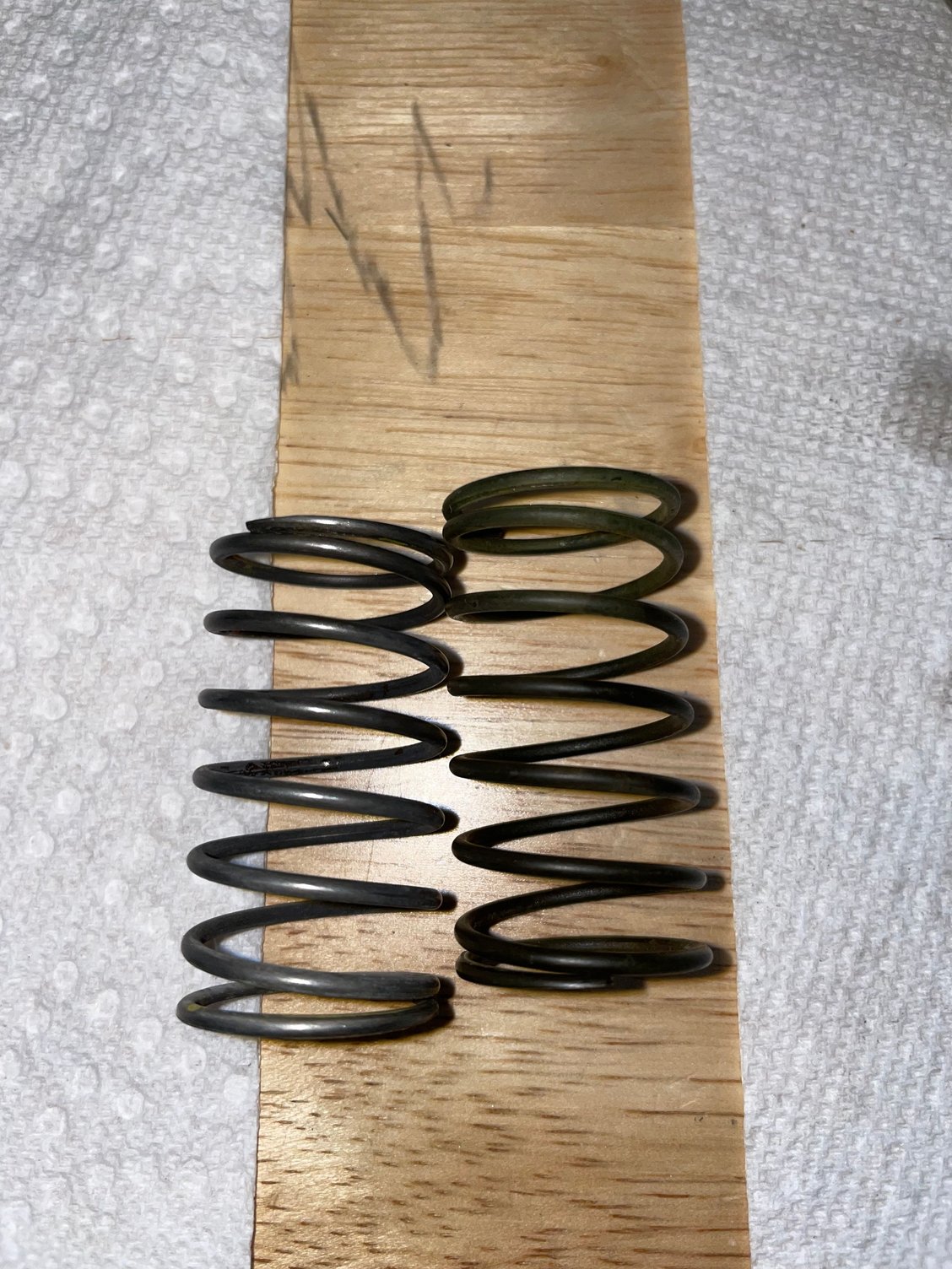

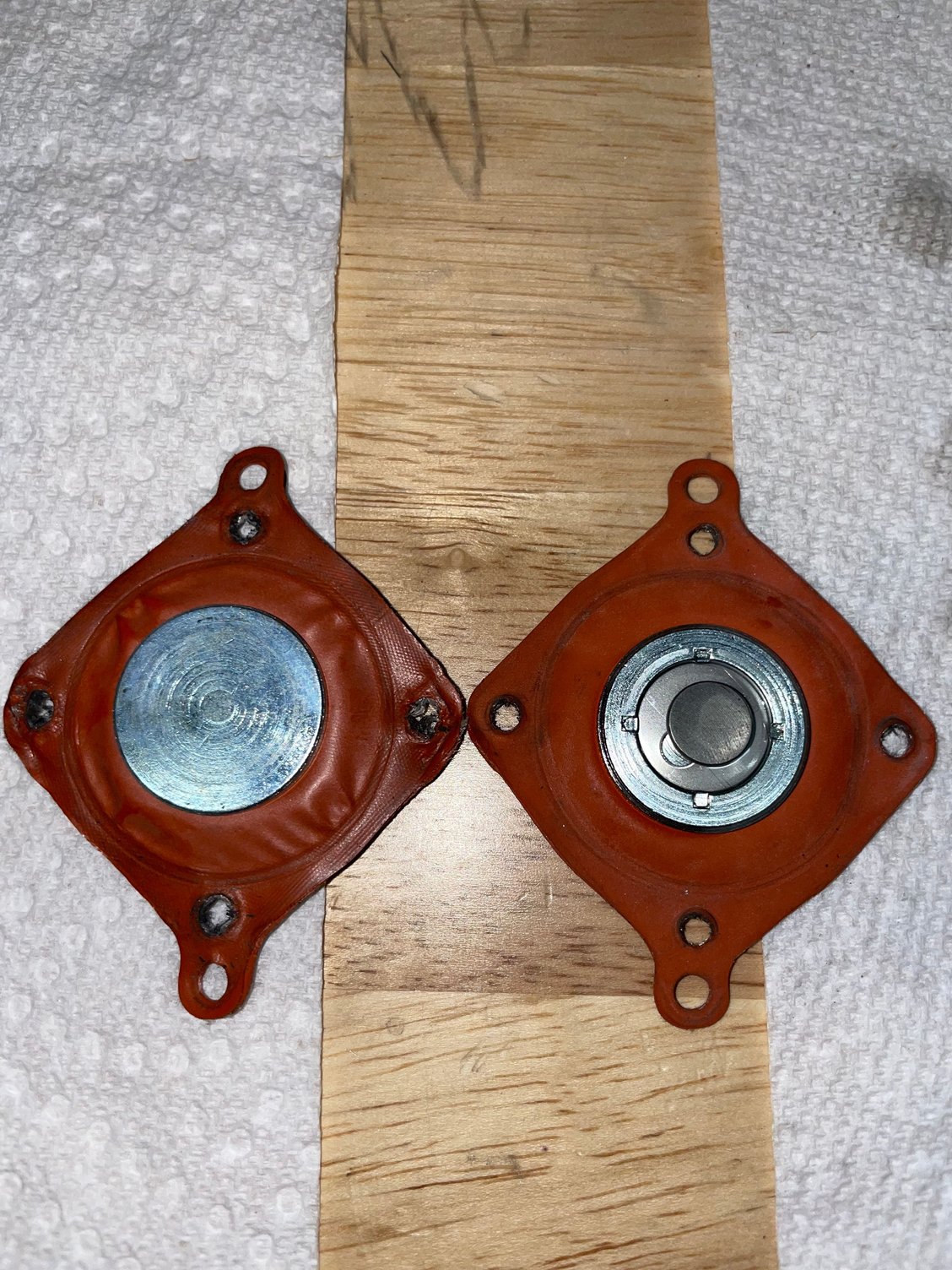

The Spring on the right was in the rear. Also the diaphragm on the right was in the rear which I believe is correct. The spring on the right is stiffer than the one on the left.

Also the one on the left was on the front TBI. I have been looking through the GM shop manual and cannot for the life of me figure out if the previous owner may have switched these also when he rebuilt it. If he did then the diaphragms would not work correctly

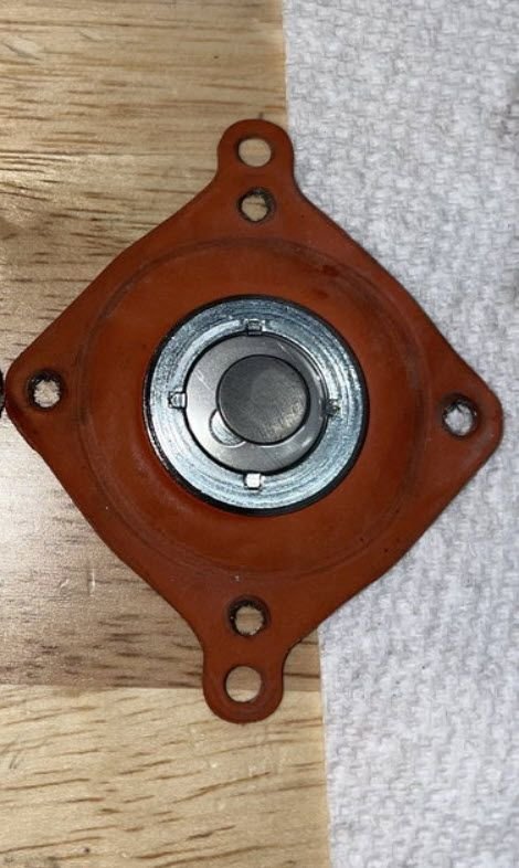

Well, that's odd. They all look correct except for the sprig colors, so who knows what someone did in the past? I still think you have a spring issue. Let me dig through all my stuff and see what I have lying around. That comp diaphragm doesn't look good, but you said you were going to replace them anyway. Were you the one that did the rebuild recently? If so, what kit did you use?

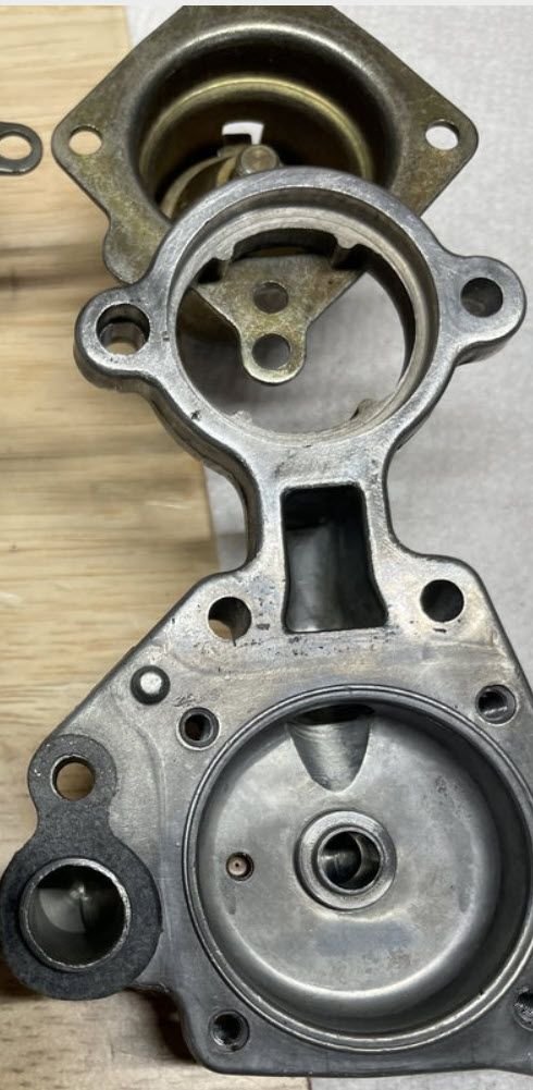

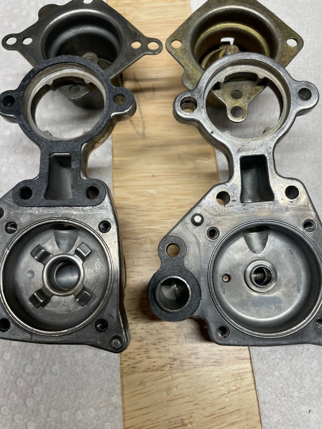

OK, not sure 100% I follow your pic posts. Here what goes with what.
REAR TB, regulated side, both of these.
