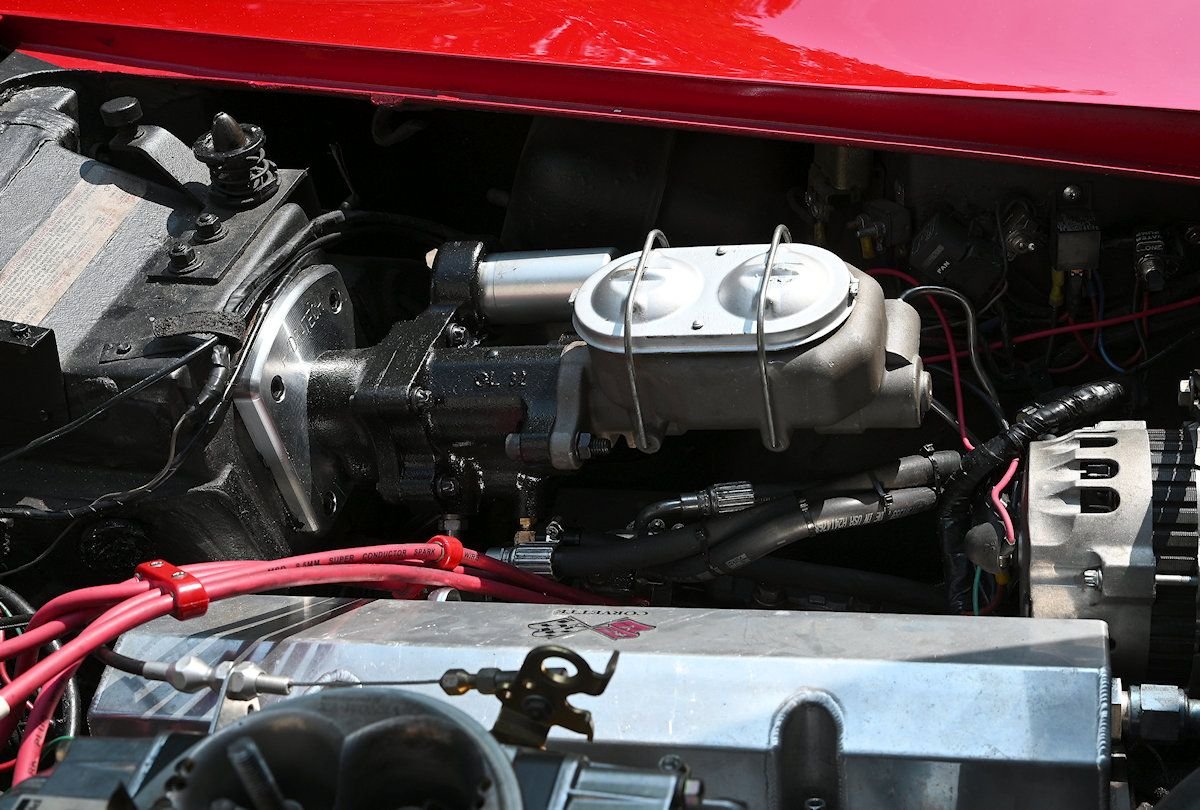

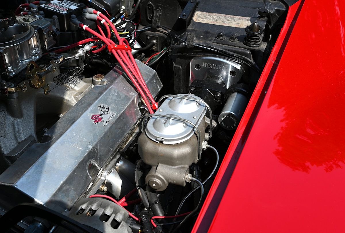

After close to a year of waiting, I finally got my hydro-boost brake system installed. It is the Hydratech system Model #3004 for '68-'72 Corvettes with factory power brakes and the long rod/deep master cylinder design. I did not do the install myself, but send out a big "thank you" to Sampson Performance, a local performance shop nearby. They said it went in smoothly and Hydratech's instructions were very good. I weighed the components, and overall gained 5 lbs. The stock booster weighed 9 lbs., and the hydro-boost weighed 14 lbs. I noticed the difference immediately, with the positive feel of the new unit.....effortless, almost "toe-touch" brakes. Well, now my vacuum system is completely gone, since I previously installed Richard's electric headlight and wiper door kits.
PS - I have Borgeson steering installed, and it posed no issues, but you have to use the Borgeson power steering hose adapters.......https://www.summitracing.com/parts/brg-925121
Pics....

Hydroboost setups kick ***! Their stopping power is incredible, and love the feeling of them. The install looks great!
