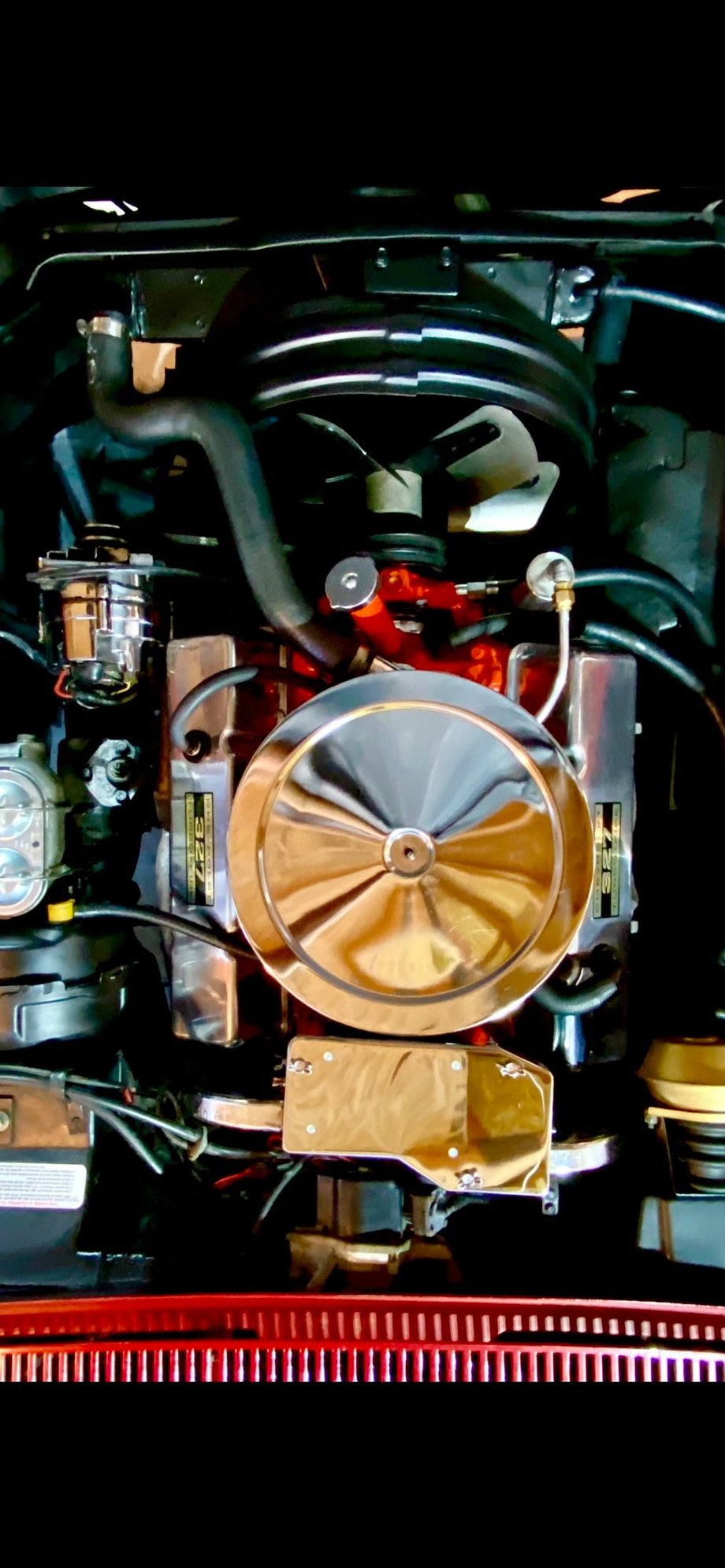

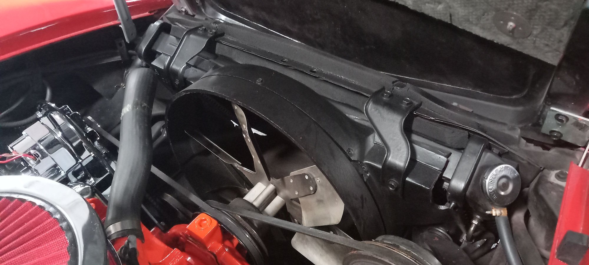

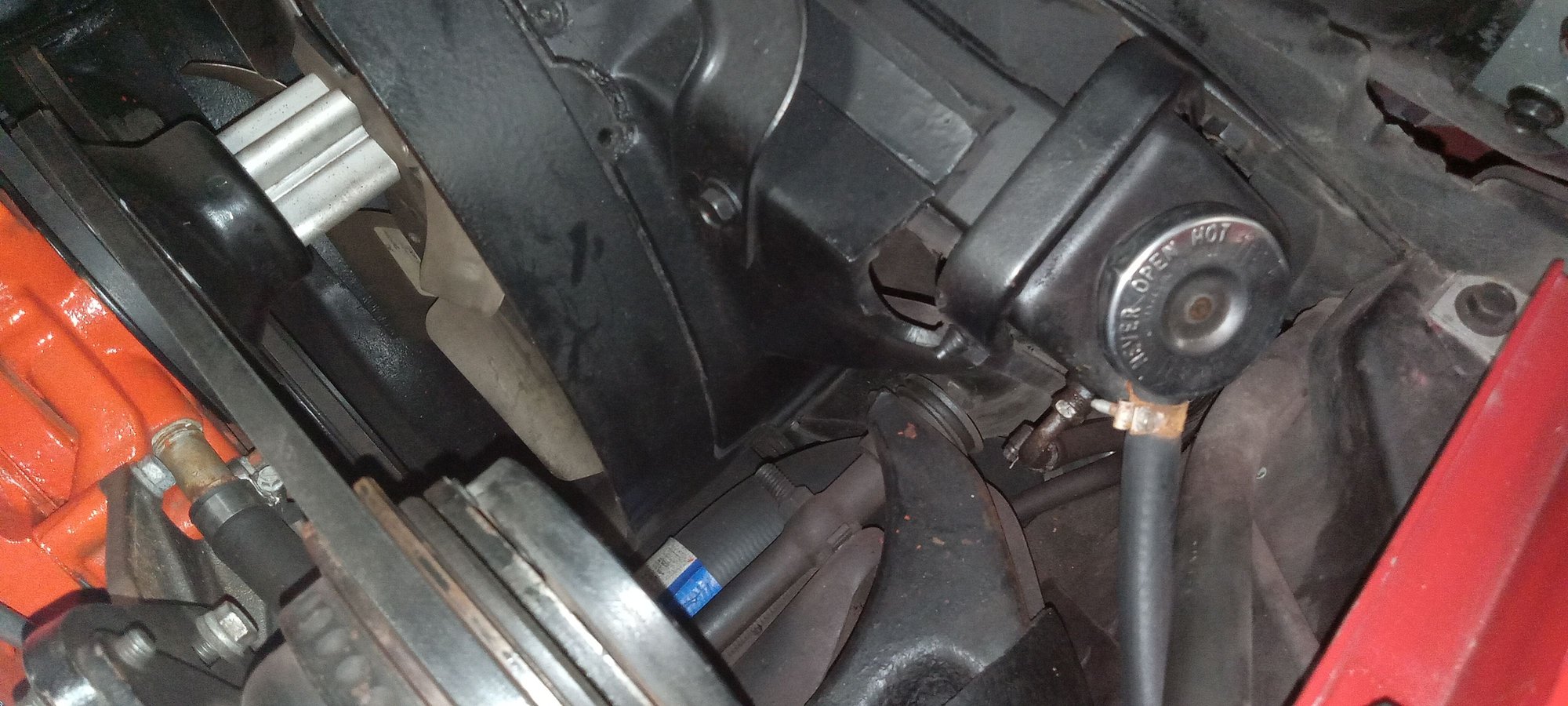

Hi All, on my 74, I just completed a radiator flush, replaced the thermostat, and the temp. sensor with all OEM parts. The car still heats up to about 210 after driving it for about an hour without AC running. I have been looking at comments on the forum and its seems that every year between 70 and 75 with overheating issues there is reference to the fan clutch along with other items. With that said, on mine there is no fan clutch with the fan when I got the car. My question is, should there have been a fan clutch with it or where there models without it?

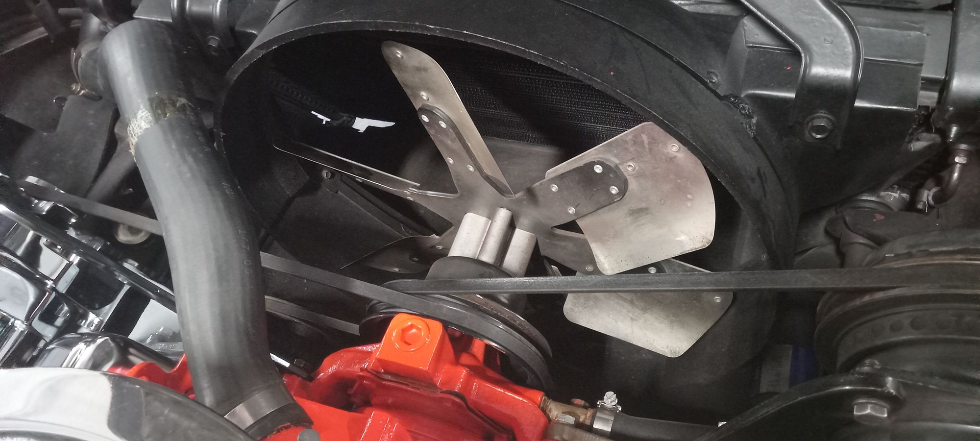

you have a non OEM flex fan with no clutch.. it is spinning 100% of the time.. a clutch will not help your situation.
no clue how effective that flex fan is, but it may be your issue.
- what is the temp of thermostat yo used?
- what does the inside of radiator look like?

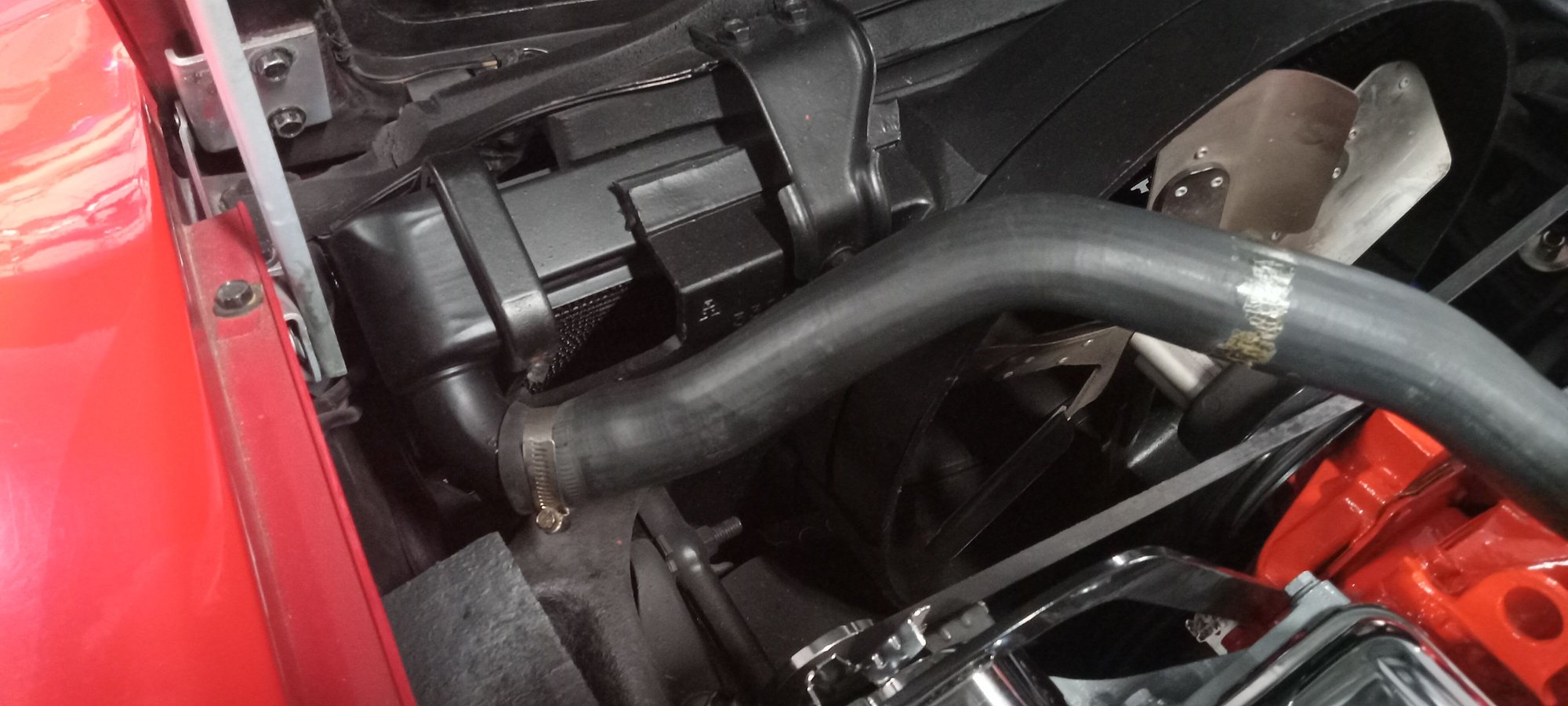

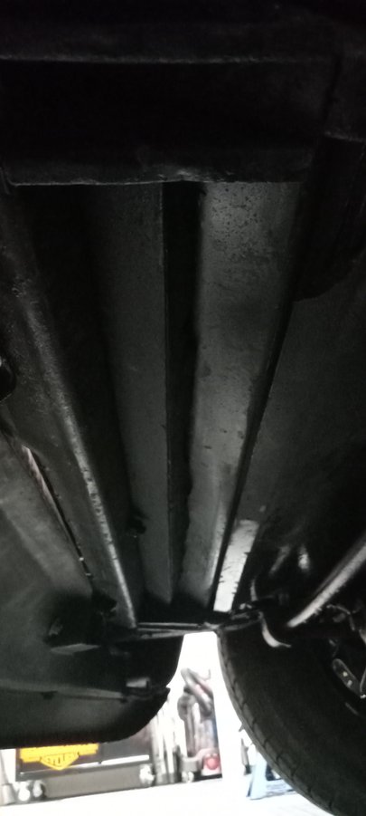

- all seals in place? take lots pics.. is the spoiler there under car? not sure if 75 had one though.. more pics..
VERY clean looking engine there!!!
Flex fans make me nervous..
i would consider factory fan and clutch
see this thread on clutches on fans
https://www.corvetteforum.com/forums...-79-l82-4.html

If that was my car the first thing I would of is put the correct OEM fan and fan clutch back on the car. I'm with interpon on this, that flex fan is spinning razor blades and gives me the heebie jeebies.

I'd be installing electric fans so fast, it would make your head spin.
But anyway. Are you driiving on the highway for an hour when this happens? In other words, not in stop and go traffic? If so, a few other things come to mind:
Do you have a front air dam to direct air towards your radiator?
Intact seals around the radiator?
Do you have a spring in your lower radiator hose to keep it from collapsing?
Do you know that your rad cap is good?
Also, yes. You should get rid of that flex fan.

Hi and thank you everyone for the feedback...
These are the parts I replaced:
ACDelco Professional G1852 Engine Coolant Temperature Sensor
Edelbrock 8604 High Flow Thermostat 053 mm / 2 3/32 in. 180 Deg. High Flow Thermostat
Additional PICs:

None of what you did has any effect on your overheating problem.
  • The thermostat has no control over maximum temperature. The thermostat only controls minimum temperature
  • Get rid of that horrible, ineffective JCWhitney/Checker Auto Parts mail-order suicide flex fan. Install the correct, factory, heavy duty 7-bladed declutching fan that was stock on your air conditioned engine. Your fan setup is a total POS - those things are simply horrible.
  • Set up your timing correctly. Badly set (retarded) timing is the #1 cause of overheating. Make sure your vacuum advance control unit is functional and that it's hooked up to manifold vacuum. Set up your timing as outlined in my timing papers - available from me via e-mail request. With vacuum advance hooked up correctly and initial timing properly set, your actual timing at idle should be close to 30 degrees. I'm going to bet that you have about 6 degrees initial with no vacuum advance at idle, making your timing roughly 20 degrees retarded, causing a severe heat problem.
  • Get an IR temp gun and "shoot" your actual engine temperature at the intake manifold water crossover near the thermostat housing. Verify you actually have a problem. But get rid of the nasty-*** flex fan whether you have a problem or not.

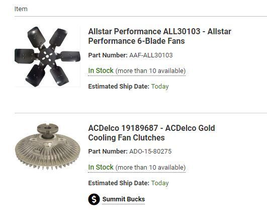

Lol... Thanks again all, its a unanimous decision amongst all, get RID OF THE FLEX FAN... I have been shopping Corvette Central, Top Flight, etc. it seems every place has the clutch fan but no fans. I was able to find the following Fan and Clutch Fan from Summit below, any comments on these would be greatly appreciated...
First.....I second everything Lars said....especially about the timing and the salad cutter......
Second......have you removed the rad to see if you have any debris between the condenser and rad? 50 years is a long time for a car to collect ****......
Third...that Allstar fan will not work....I urge you to find the right 7 blade fan new or used........and the "HD" fan clutch.......I use both on my 500hp 406 small block with a bone stock cooling system and run 190-195 degrees......

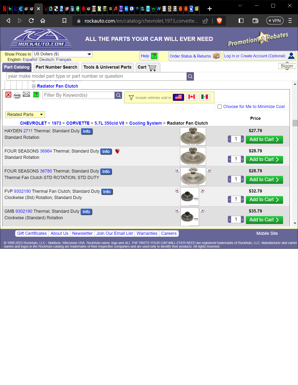

Hi all, thanks again for all the feedback… With that said, it has been a great struggle trying to find a 7-blade/17.5 width w/AC fan. It seems all corvette supplies have stopped supplying and salvage yards just don’t have one. So, unless I can find a fan, which I really want to, to keep the originality of the car I am starting to look at electric fans to add to existing radiator or replacing with an aluminum radiator with fans combo. Any suggestions on adding an electric fan to existing setup vs combo and manufactures would be much appreciated.
