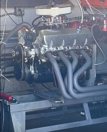

I think you should go with the setup below. The innermost crank to w/p should be by itself and you may want to reconsider the idler as it makes installation much easier. Then the crank, w/p, and alternator on the middle groove of the top pulley with the A/C driven by its own belt off the forward most w/p groove.

The idler isn't absolutely necessary. My 427 doesn't have one, my 454 does. Without is a real struggle to get the belt on but with is just mildly taxing. I'm sure there are other benefits to having one but I don't know the full reasoning as to why some had them and others didn't.
