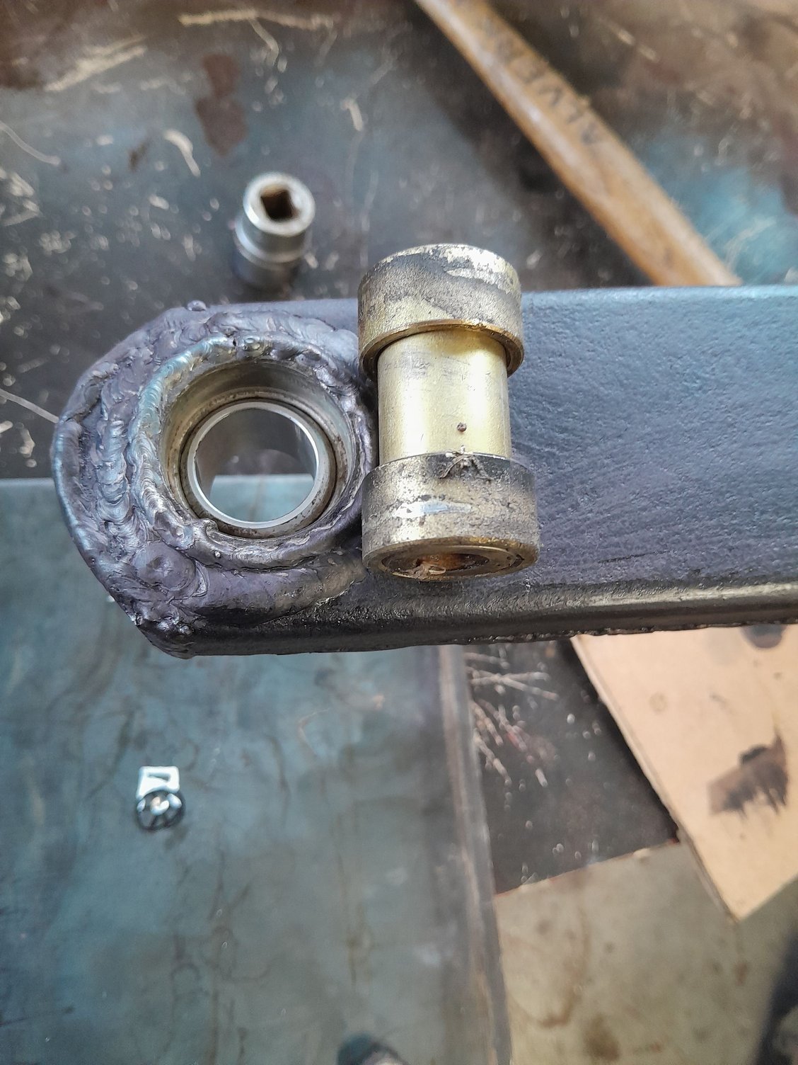

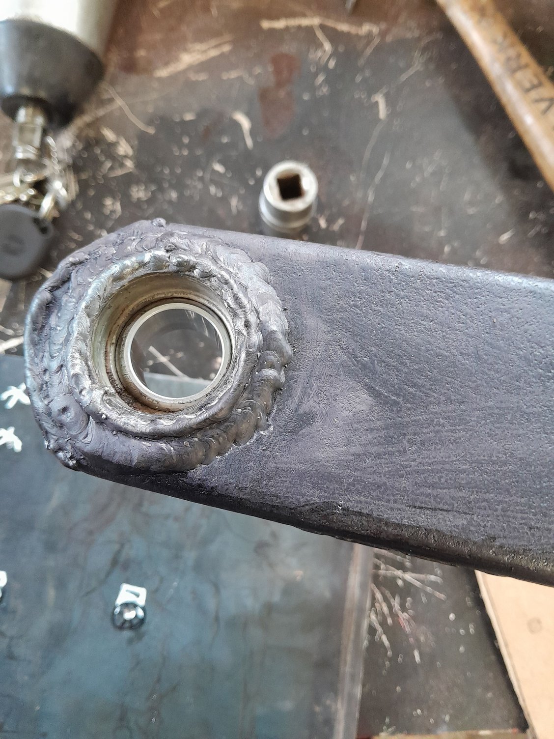

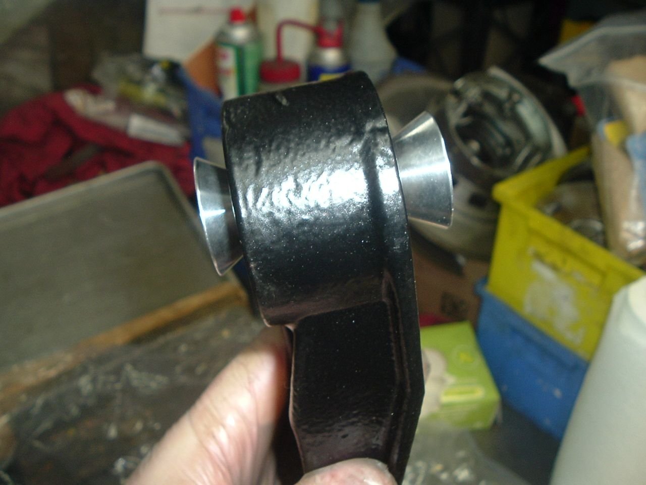

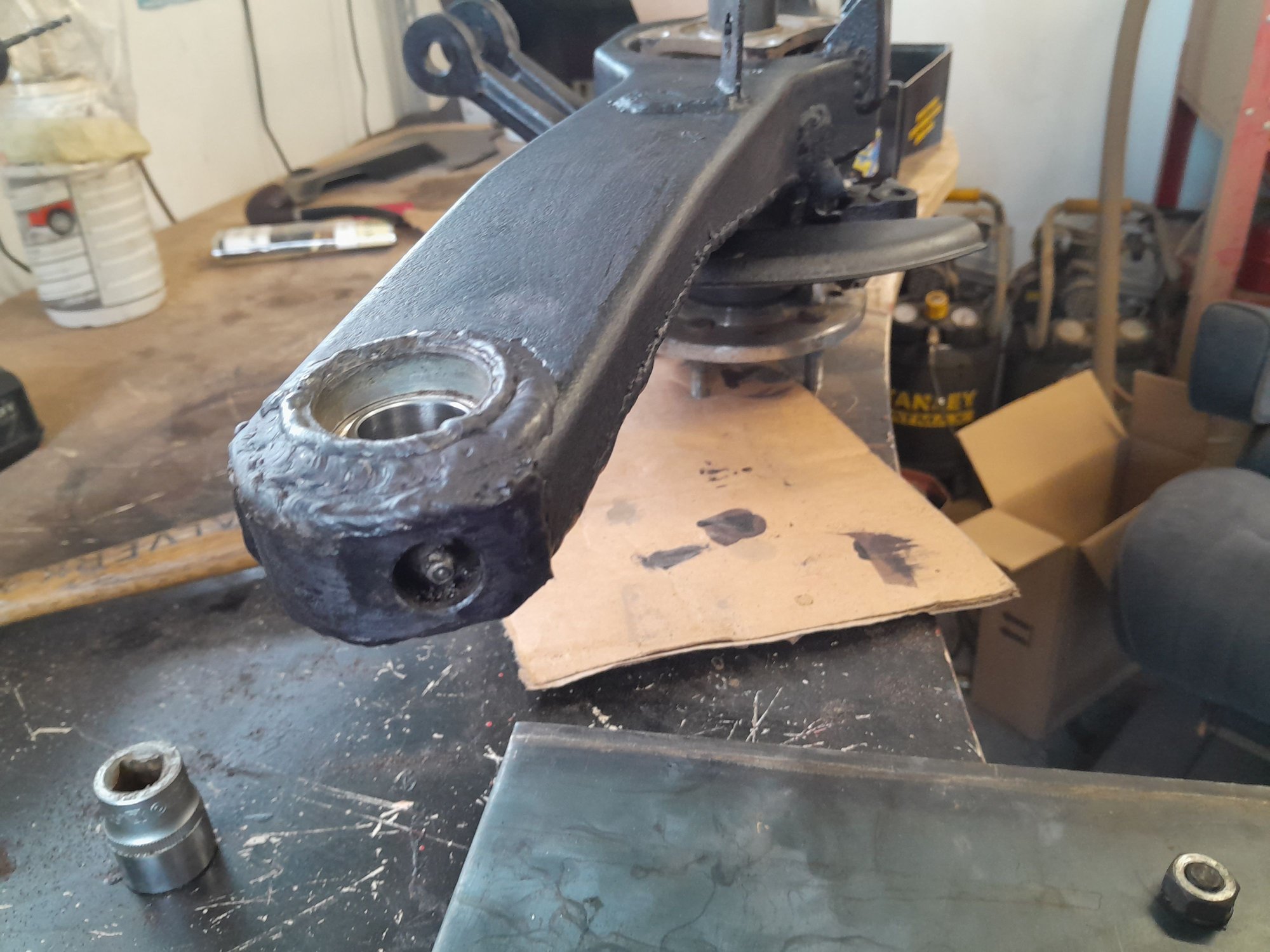

Hello guys. New here and need some information.
Just bought a bushing set from Hyperflex and the trailing arm bushing does not fit. Seems like maybe some modifications have been made but there is a flexible joint in the arm. Any information would be much appreciated. Is this a original bushing seat? Also the original bolt does not fit through the bushing shield plates.

You are going to have to replace that trailing arm.

That is a mess. Someone modified it and welded in a sleeve with poly bushings or maybe those are just rubber sleeves? they are junk. Do not use your new poly bushings because those are junk.
At this point buy new USA Made- NOT Chinese made arms. You have to ask sellers who makes them, most buy and resell them. I can mention names and only get in trouble, so you have to do some homework. The new USA Arms run about $200 each the last I checked. They are powder coated, have rubber bushings installed, new spring cup, and new guide. They are better than original arms. To get your arms in that condition, if they are not bent or rotted will cost you more and it's not worth it. Prices vary as there is still some competition left but that is drying up by the day with consolidation.
Next question, if you are into the arms, did you setup new bearings? Again, same thing applies.

Looks like it may be a Johnny joint conversion.
Tom

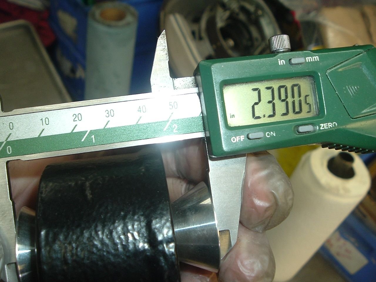

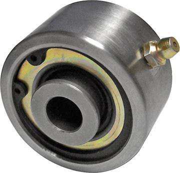

I did a set of those a couple of months ago, they're poly too. I had to make a fixture to keep the arm centered between the bushing and the axle. The contact point is too small, so I had to machine caps. They came out fine but it wouldn't be my go-to part.

The bushings he has are regular poly bushings I think. Not meant for a Johnny joint. It looks like the center ball is still on the arm. It much be an early version of the joint. I think new ones are like this.

It doesn’t look like an issue besides needing a bushing. If it were me I would try to fabricate a poly bushing for it.

I'm not convinced you need anything. The set up that came out of it looks far superior to all the other options. The spherical bearing in the arm looks good, probably didn't have any rubber type material when installed originally. What am I missing here? I would reassemble it and if there is no slack on the bolt, motor on! Grease it once a year, best set up I've seen.

Yes, flexibility in that joint is a good thing, just so there is no radial movement (slop) on the mounting bolt.

Since you're on an island with not a lot of Corvette resources- if anything, you might be able to use those arms. I would confirm they are no bent or rotted first. Then look over the bushing. If you were in the states and not having inspected the arms I would still go for the new USA made ones with rubber bushings.

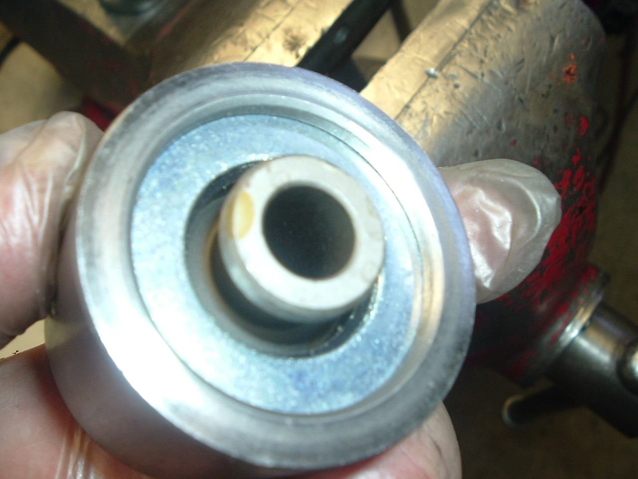

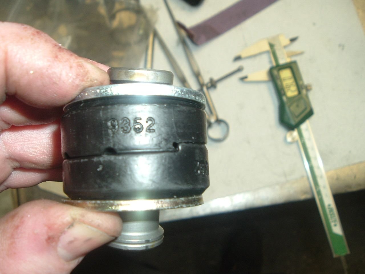

I would check the bushings for binding and if they're good I would look at machining up a larger face diameter set of inserts. Look at these bushings, something like this. The Johnny Joint is a sphere in a poly bushing set. Finding a machine shop in Iceland I expect would be easier than corvette parts. It might just work for you, at least it's worth the time and maybe get some driving in. If you don't like them, go back to replacing them, just don't use poly.

Those look like the Herb Adams Bearings I installed back in the early 80's. The Rubber Doughnuts on the sides is probably just to keep the dirt out. They work great on the Track but are a bit ex stream on the Street. You get real good at making lane changes on the Highways not hitting the little bumps marking the lanes. Cause if you do it will shake your fillings loose.
