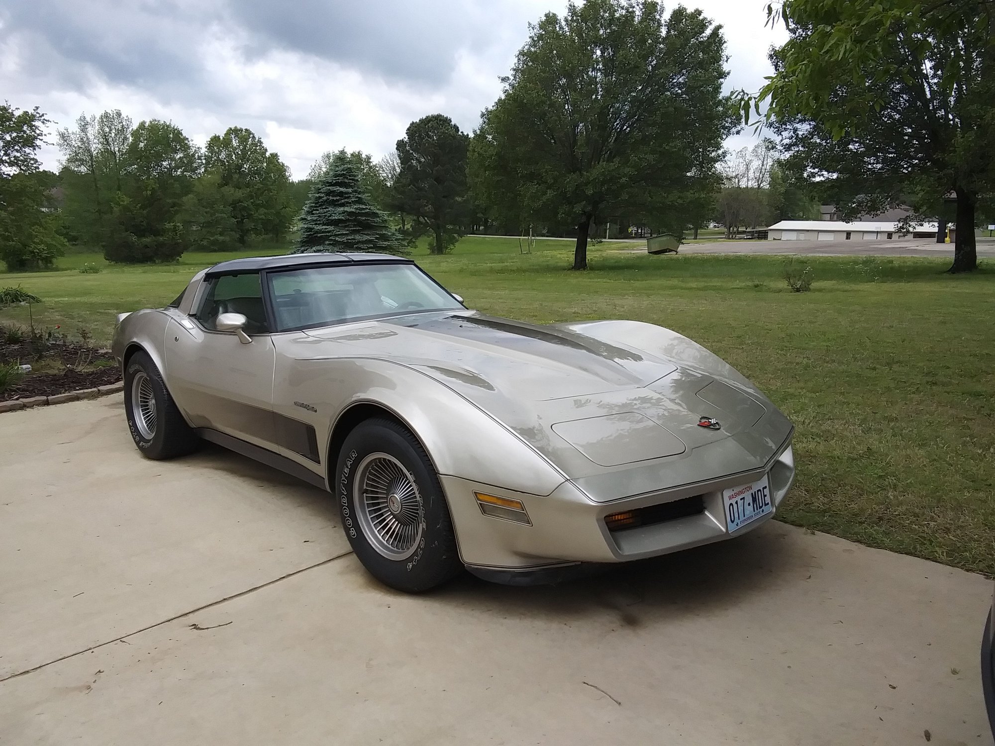

nice! pics of your new ride?

Old Jun 27, 2023 | 09:01 AM
electrocreep's Avatar
electrocreep
Cruising
Joined: Apr 2023
Posts: 12
Old Jun 27, 2023 | 09:48 AM
