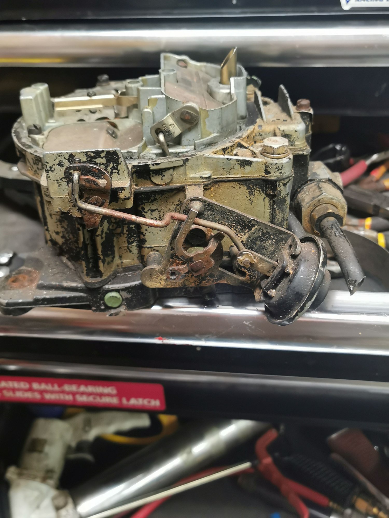

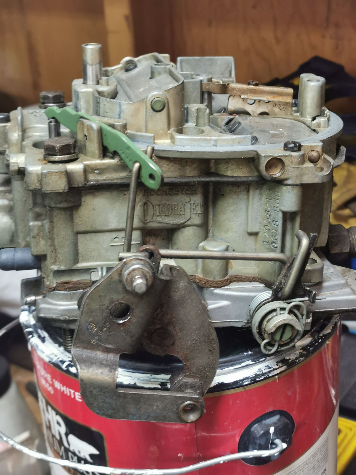

Just out of curiosity what is the actual model of the carb? There is a stamping on the choke housing on the carb, would you mind reading off the numbers?
I currently have a quick fuel brawler 650 on there. Pretty new. But I still have the quad that came off and another quad off a boat I took apart. Both don't work well. The numbers for those are in the pictures I posted. The first carb is the one off my Vette, 2nd off the boat.
No no no….. There is a stamping on the front of the choke air horn that gives the Holley part number. There are possibly several different 650 Brawler carbs. The code on the front will tell us exactly what that carb is. The code looks something like this.

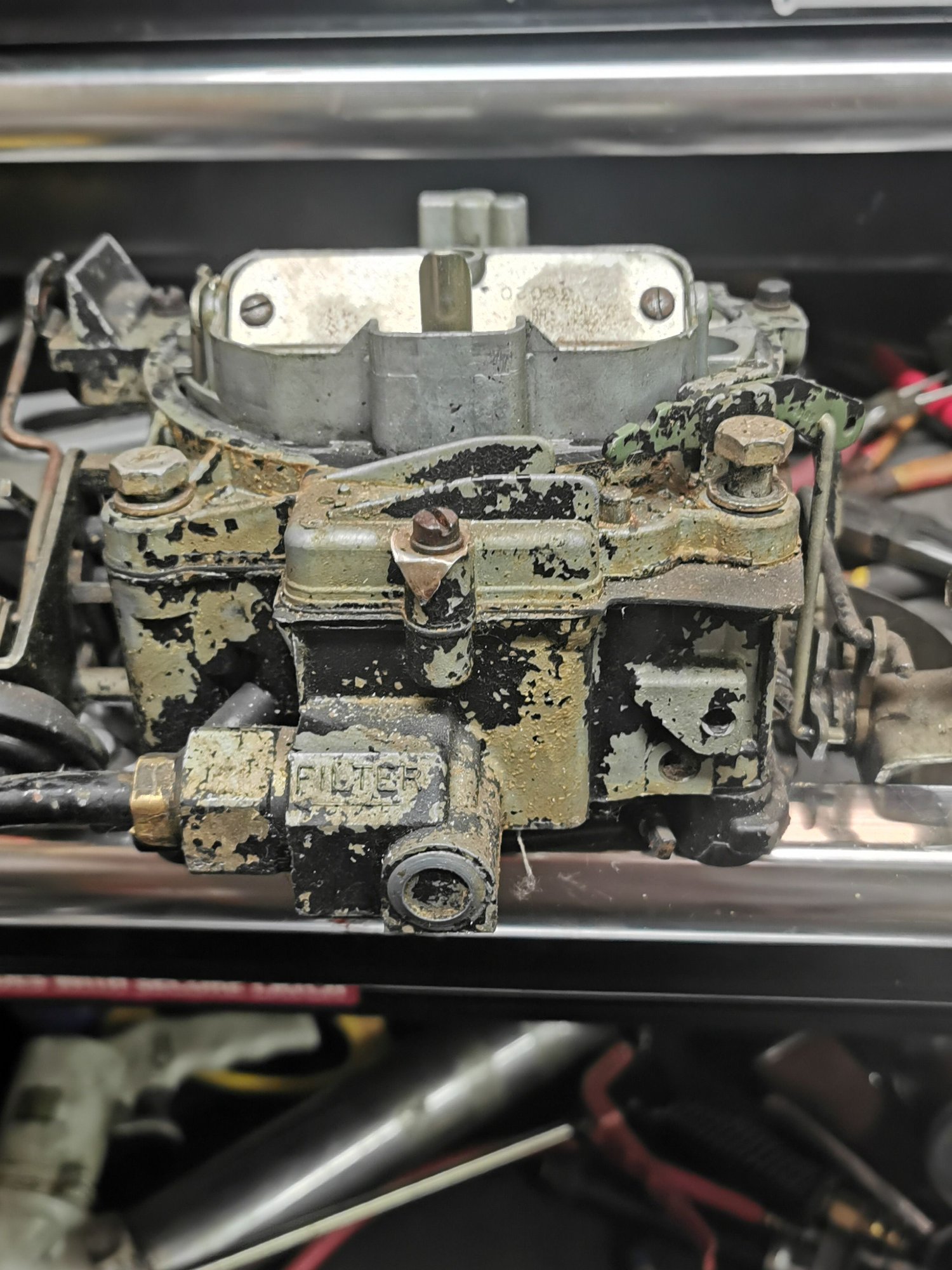

There's the number, as a note the electric choke is removed and I have a manual installed. Electric never worked right and I prefer manual.
