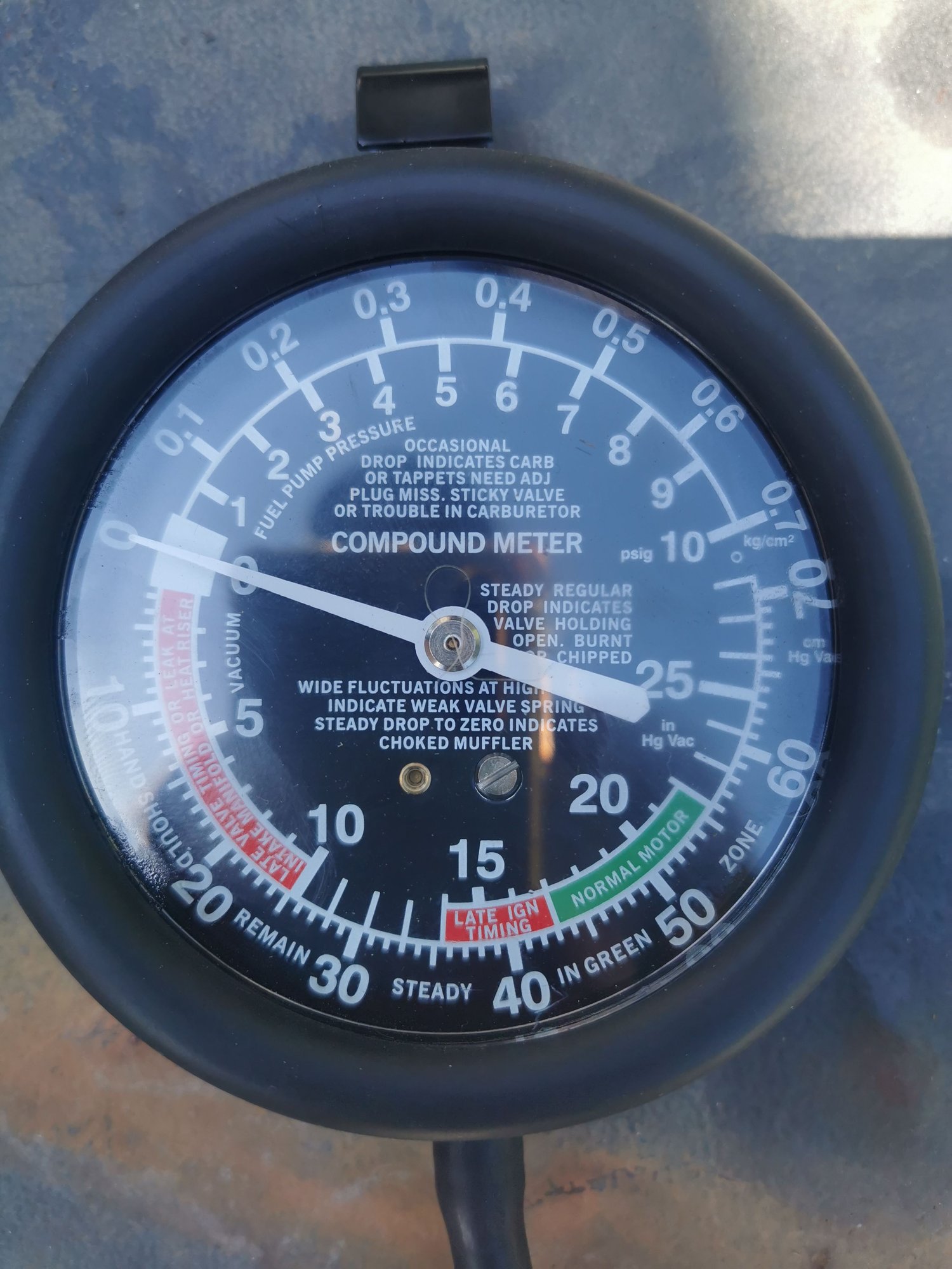

So after figuring out all my timing and distributor issues, it is running real good. But I can't seem to get the carb adjusted right. I had it close but it was sputtering a bit on wot. So got a vacuum gauge to try this properly, but not getting best results, although much better. My carb is a holley brawler 650 double pumper. So it's a tiny bit large for my high output 350, stock except carb, distributor and intake. Hers what I've done and results. First, the carb has 3 vacuum ports. One metered up top, and 2 down below on front. 1 of the 2 has 0 vacuum unless you open the throttle. The other has full vacuum all the time except wot obviously. So I put gauge on the full vacuum one. (I also put the vacuum advance on that one when driving it) I get about 45 on the gauge. That's with all 4 screws 3/4 open. Adjusting I started on front passenger side, turned until gauge went as high as I could get it, then did same on other side. It's now at 50 inches. 2 screws are at 1/4. Had to drop back to idle at that point with idle screw. Then went to pass rear turned it to about 1/2 open and it went to 52 inches. Then other side same but gained barely an inch so about 53inches. Now it drives super nice and is real snappy, goes good. But if I run it up then let it off and coast in gear, it will pop a couple times out exhaust. So this means lean to me? Except if I turn any screws out, I lose some vacuum, instructions say max vacuum. So that's an issue, why does it do that. Also carburetor instructions say all 4 screws should be the same, mine are not, and anything I do causes them to get worse as well as vacuum loss. Fronts are 1/4 open, backs 1/2 turn open. So now I'm all confused. Seems to really run great and fast, it's really just the exhaust popping on hard decel that scares me. Could it be simple like my new 2.5inch flowmaster exhaust with cross over? Could it be the reason it pops? Actually sounds like those European race cars when they pop decellerating. Just no were near as bad. It pops maybe 2 - 3 times max. I think I'm close. Can anyone straighten me out?

Popping on decel is a lean condition.
something is up with your vacuum gauge, it should be closer to maybe 18-22 inches of vacuum. 45 and 53 is not achievable from an engine.

Ok your right. I was reading the wrong number on the gauge. If you look on the right of the gauge in the green area for tuning, that's the 50 I was reading. My mistake the inches are on the inside dial so it was about 22inches. The gauge us brand new first time used. Sorry about that.
