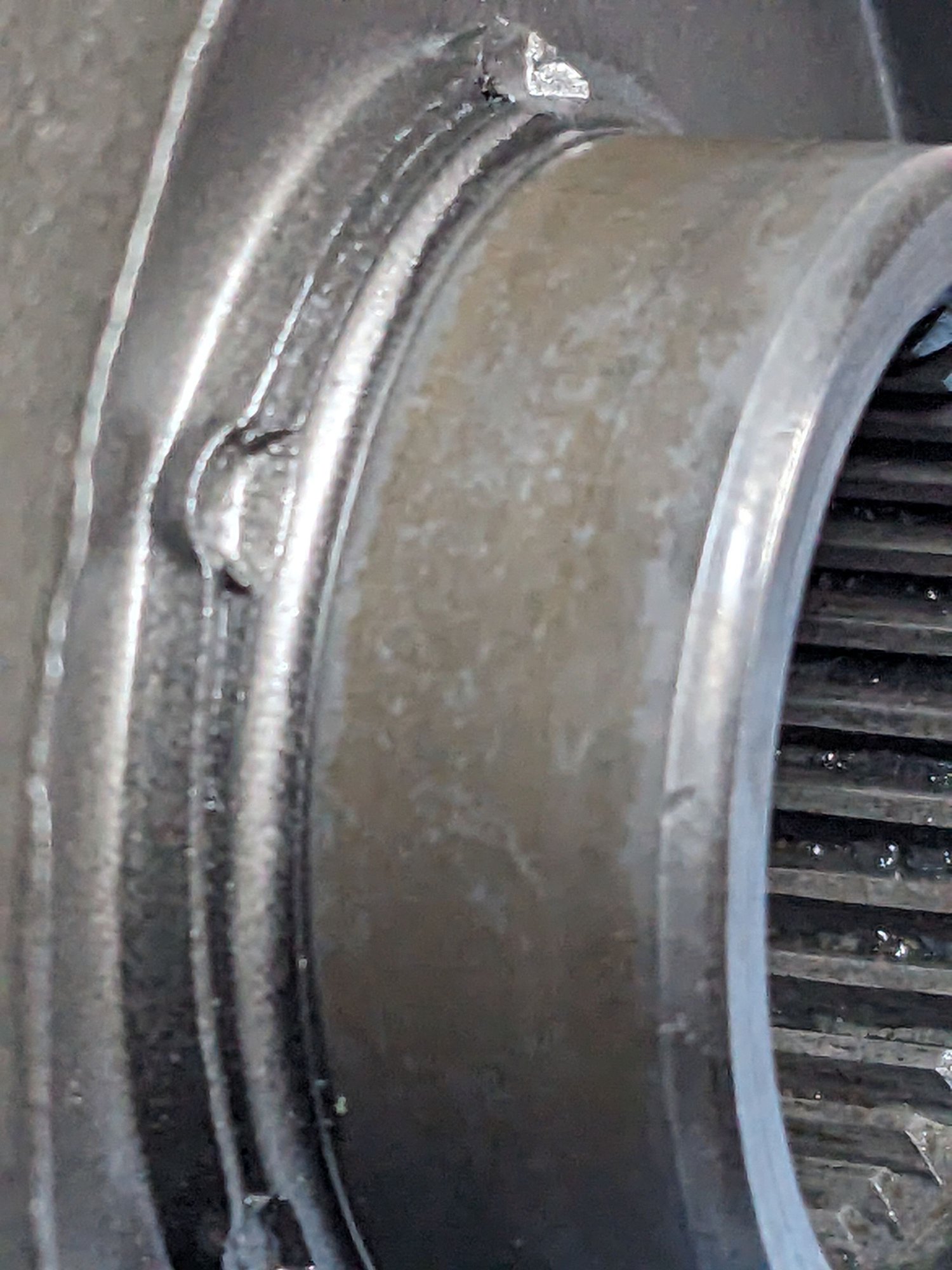

I have a very clean Original GM one left over:
1330 u-joints 3.625" wide off my 72. Is that the size you need?
I just took pics. I cleaned it in evaporust a while back, and painted it. The seal area has a line that I can just barely see, but I can not feel anything there at all. I have not touched the seal area with any kind of abrasive at all. You may wish to polish it up a little bit before use.
Let me know if your interested.
Thanks I will need to check, mine is a 1978 original diff.
