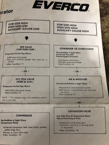

If I'm reading all this correctly when the compressor starts to slip and/or stop turning you are at a Low Side High and High Side High condition. The below troubleshooting tree is from my Everco manual.
EVERCO bleManual A9590
Troubleshooting Tree
Condition 14
Condition 15
Condition 16

This is awesome, thank you for posting this book.
