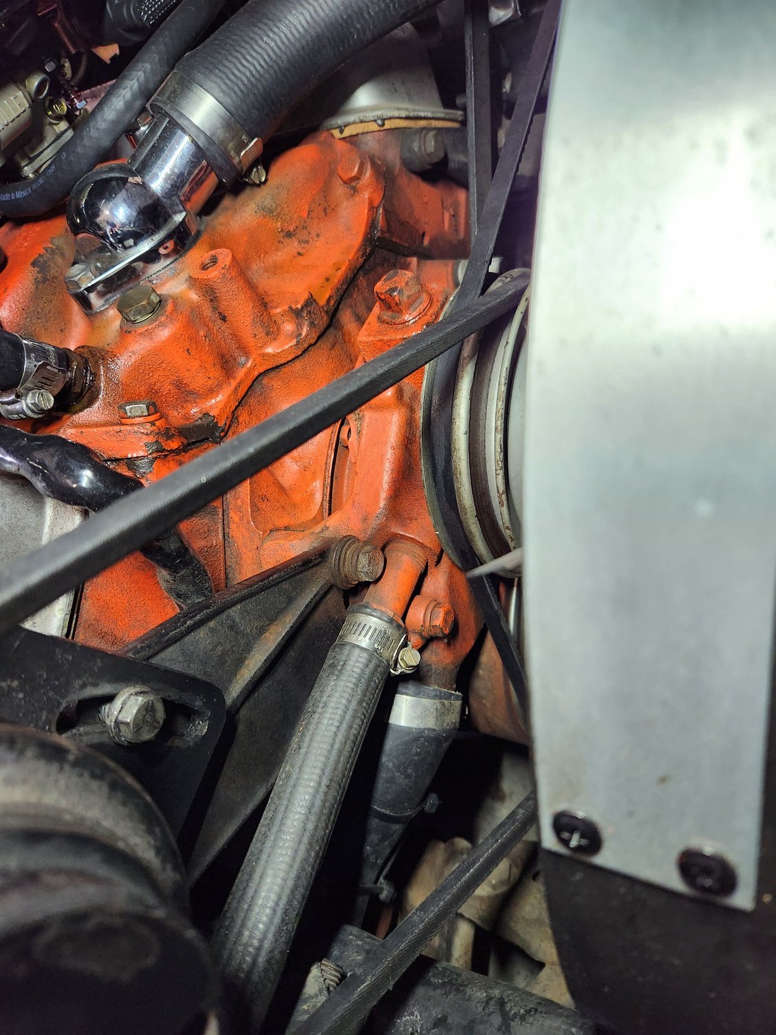

Originally Posted by Eric P
When the Compressor starts locking up and belt smoking , does this cause the engine to want to die at Idle speed ?
It is the belt smoking and not the AC Clutch correct ?
Yes, when this happens this pulls the engine way down for sure, until the belt starts slipping around the A/C pulley.
Its definitely the belt slipping. The clutch remains engaged, so the pulley stops and the belt starts to slip.

Did you notice the belt on the compressor, it is a cheap cogged belt . You need a solid belt with no cogs or teeth. The belt grabs the sides of the pulley. Half the area of the belt is missing with a cogged or toothed belt. This might be one of your problems, (not enough belt area around the pulley) Also when the system warms up is when you get the slippage also indicating there is moisture in the system and/or overcharge. you may also have too much oil in the system. TRy removing some refrigerant and see if the high side comes down. 325# is too high. Compressor is probably good if it can deliver 325# of pressure. And one more thing the belt riding on the water pump pulley is crooked. Not really a show stopper but should be better aligned. The belt riding on the comp. looks perfect. Try re-shimming the compressor to get rid of the water pump pulley mis-alignment. Had a similar situation like this but with a POA valve/A6 Comp. Turned out it was over-charged and too much oil, only I damaged the reed valves by sending liquid refrigerant back to the Comp. When this happens, it's game over. Time for a new Comp. Luckily this hasn't happened yet for you.
So funny enough, it is a solid belt. One of the first things i did when all this started was ditch the cheap cogged belt and get a nice thick solid belt, just like you suggested.
Its definitely not overcharged, I tried half the listed poundage, adding a little at a time up and down, and no matter what charge im at, it locks.
Current theory is maybe too much oil, like you mentioned. Gonna remove the compressor again and remove some oil and see if it improves.
Didn't see the solid belt, but that's good. So now we're down to : too much oil?, clogged condenser on either the fin side or the tube side, too much oil will reduce the heat transfer rate of the condenser. And a reduced airflow thru the condenser will do the same too. How's the airflow from the fan, with the fan clutch fully engaged it should be literally roaring. The more and more I think about this; it points to too much oil, provided your have good airflow thru the condenser and the condenser is not blocked with debris, dirt, etc. The condenser is just not rejecting the heat fast enough, too much oil can slow down this transfer or an internally clogged condenser. One more check, Are the gauge lines, at the fittings, from your A/C gauge set covered in oil when you remove them from the A/C system? There should be some oil mist but not dripping when they are disconnected. This would be another indication of too much oil.
As we work through this, Im starting to think this same thing, too much oil. Fan airflow is good, condensor is not blocked externally, and i blew through it internally. No oil dripping when i disconnect, that ive noticed.
So let me as you, and the forum, this: What is the proper oil servicing procedure for this system?
Assuming i open the system up, clean all the oil out, including out of the compressor, and everything is empty.
Before, i put 10.5 oz into the belly of the compressor through the drain hole, but some things im reading now suggest more like 6 oz need to go in. Some also recommend filling the compressor through the suction side line. And should any be in the VIR? Evaporator? And im out of ester oil, should i use mineral this time?
