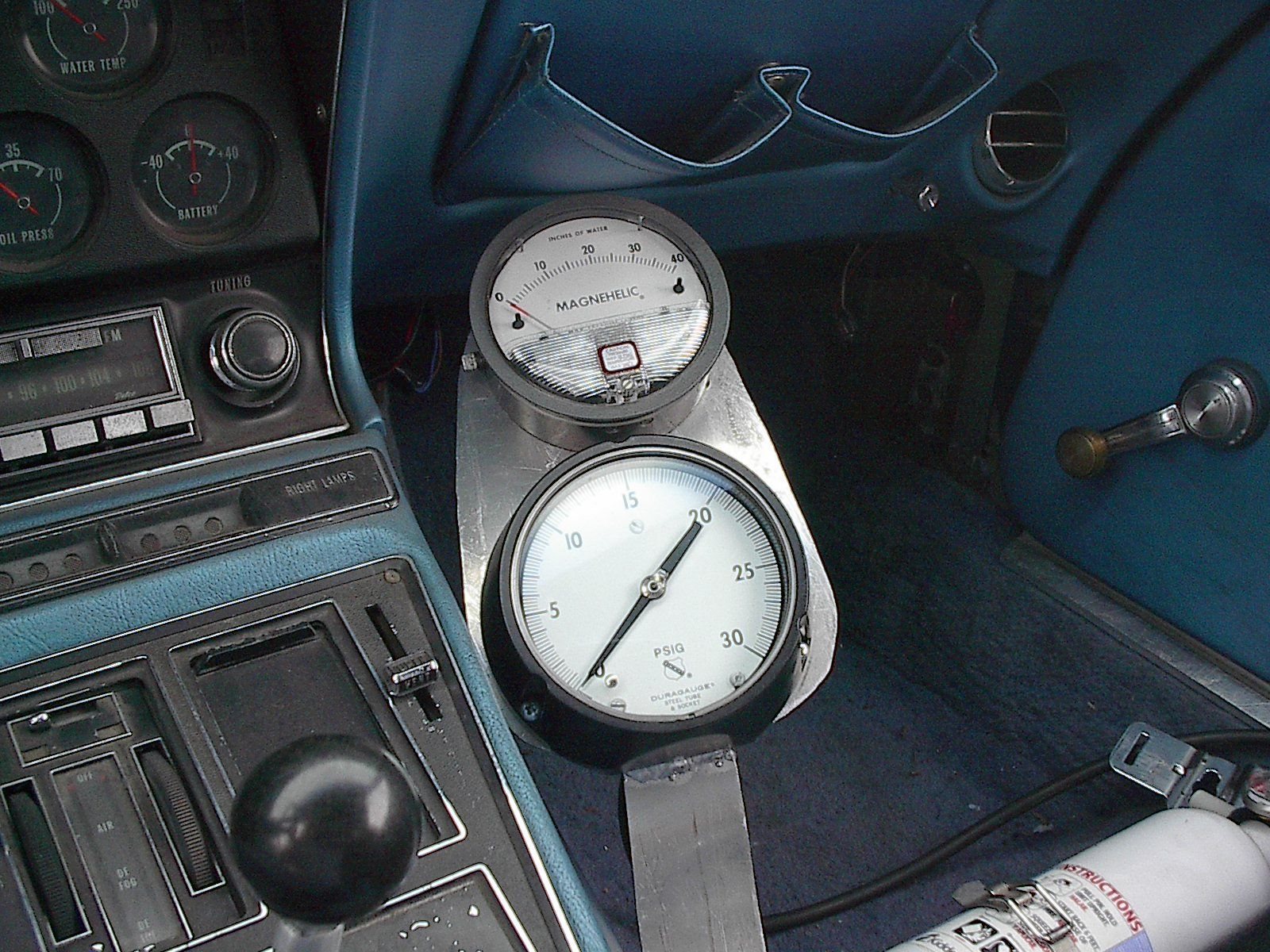

Have you measured the present system backpressure to see if an upgrade is needed or worth the expenditure?

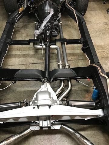

You could do something like this...Check out this beautiful exhaust by MattoonVette
https://www.corvetteforum.com/forums...post1604898317

Good question, how do you check the back pressure?
Pete.
Old Jul 29, 2023 | 10:38 AM
69427's Avatar
69427
Joined: Jun 2004
Posts: 20,847
Likes: 959
From: I tend to be leery of any guy who doesn't own a chainsaw or a handgun.
Pete.
Just use a pressure tap into the exhaust pipe (I weld an O2 fitting onto all of my exhaust systems), and plumb that to an appropriate range pressure gauge. This Magnehelic gauge is 0-40" H2O (about 1.5 psi), useful for normal exhaust systems (and other pressure differential circumstances), and I use the higher range gauge to measure turbine inlet pressure and boost pressure on my C4. Not terribly expensive gauges, but handy quite often. (This is an old picture. A forum member informed me at the time that the Magnehelic gauge should be mounted vertically for best operation, and I've since modified the bracket.)
1.5" at idle? What should it be at other rpm's/throttle openings?
Old Aug 4, 2023 | 05:27 PM
69427's Avatar
69427
Joined: Jun 2004
Posts: 20,847
Likes: 959
I had to go out and look at my notes (written on the car trailer interior walls ). I didn't write down what the idle backpressure happened to be, just the high RPM WOT reading on the main straight of the track I frequent. It was 10" H2O (about 0.36 psi). This is on a system that I've had compliments on how (comparatively) quiet the car is at WOT.
Zero backpressure is certainly the goal, but it gets expensive, difficult, and heavy to construct a zero backpressure system that's also quiet, and vice versa.
