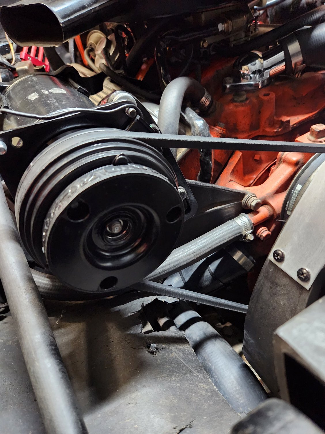

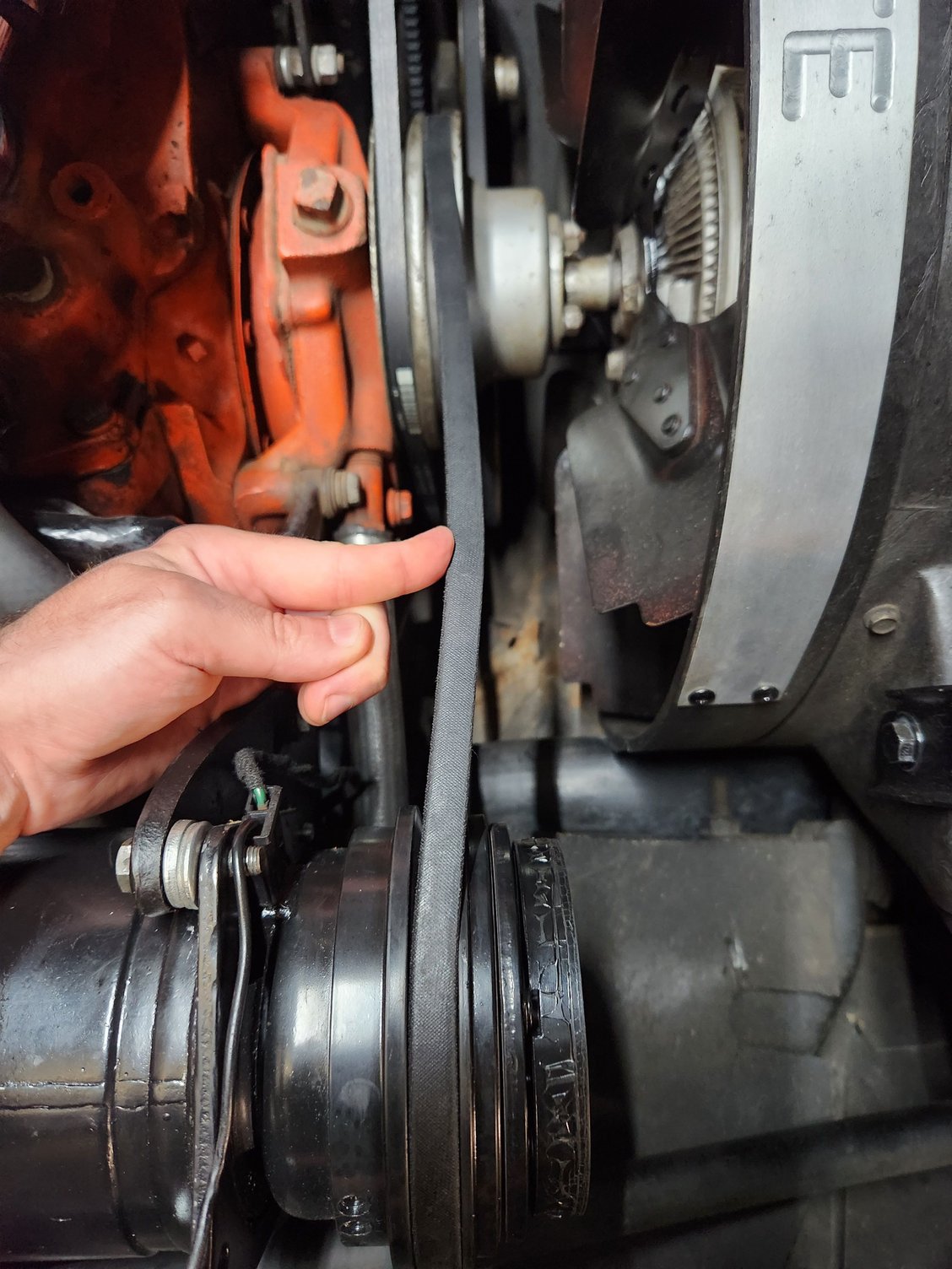

Originally Posted by interpon
Post up some pics..like how the belt sits in pulley etc..
pressures are high but maybe not if really hot and humid..
it is also possible the remanufactured compressor is crap too..
To Air Conditioning compressor issue

or use a hose to wet condenser...and check pressures..
that belt i think still loose..

Looks like that clutch got hot with the cooked looking paint. I'm not at home so I can't compare the tightness of my belt to what you're showing. I'd have to agree that it does still look too loose. Are you all out of adjustment travel to make it tighter?
