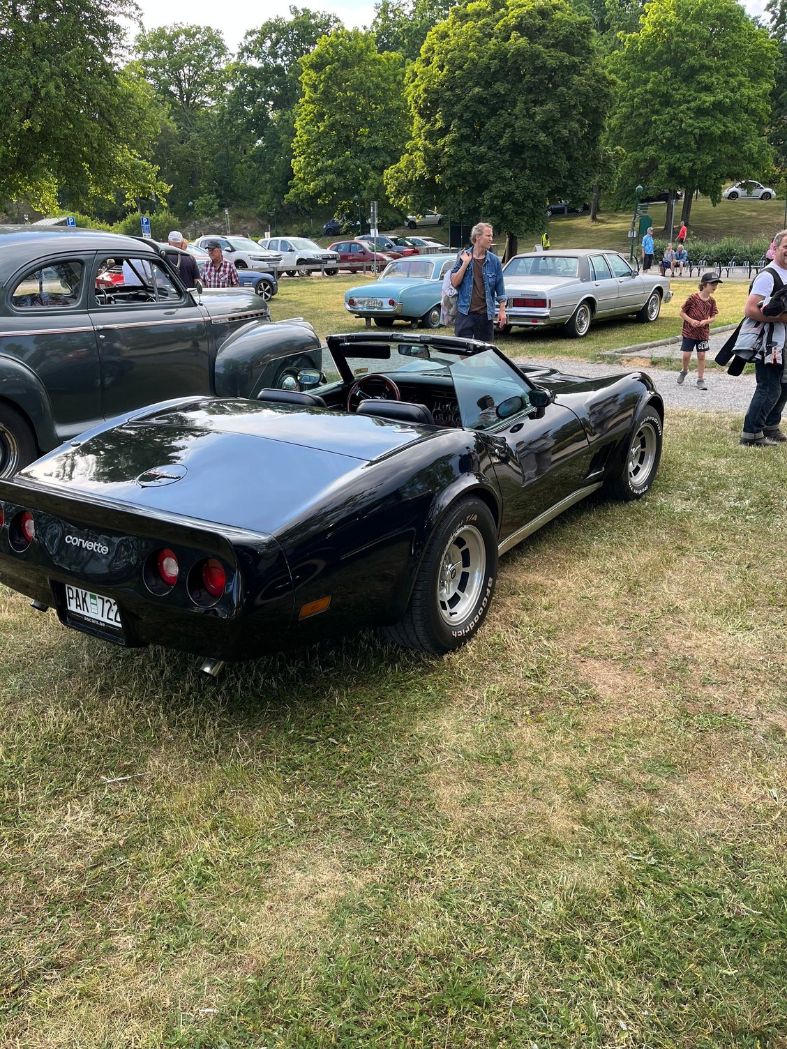

here is a picture of my 81 convertible , rebuilt from coupe in california in 81 , exported to sweden in 89
