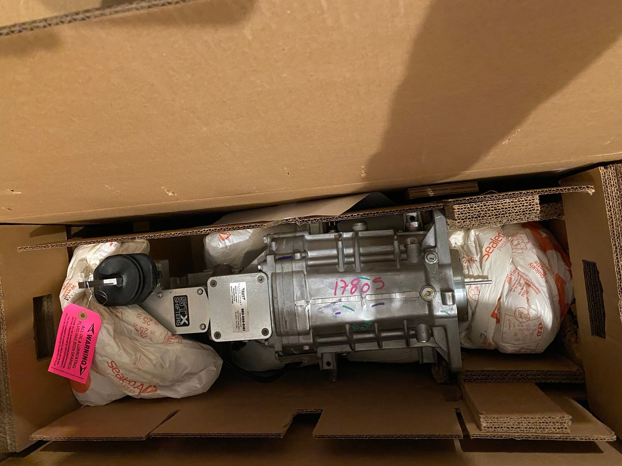

I'd love to give a review of my TKX, but it's still in the box thanks to scope creep. I ordered the same 0.68 OD, though. I think many here will agree that the SST bellhousing is a robust unit, but you'll need to make sure you zero the runout.

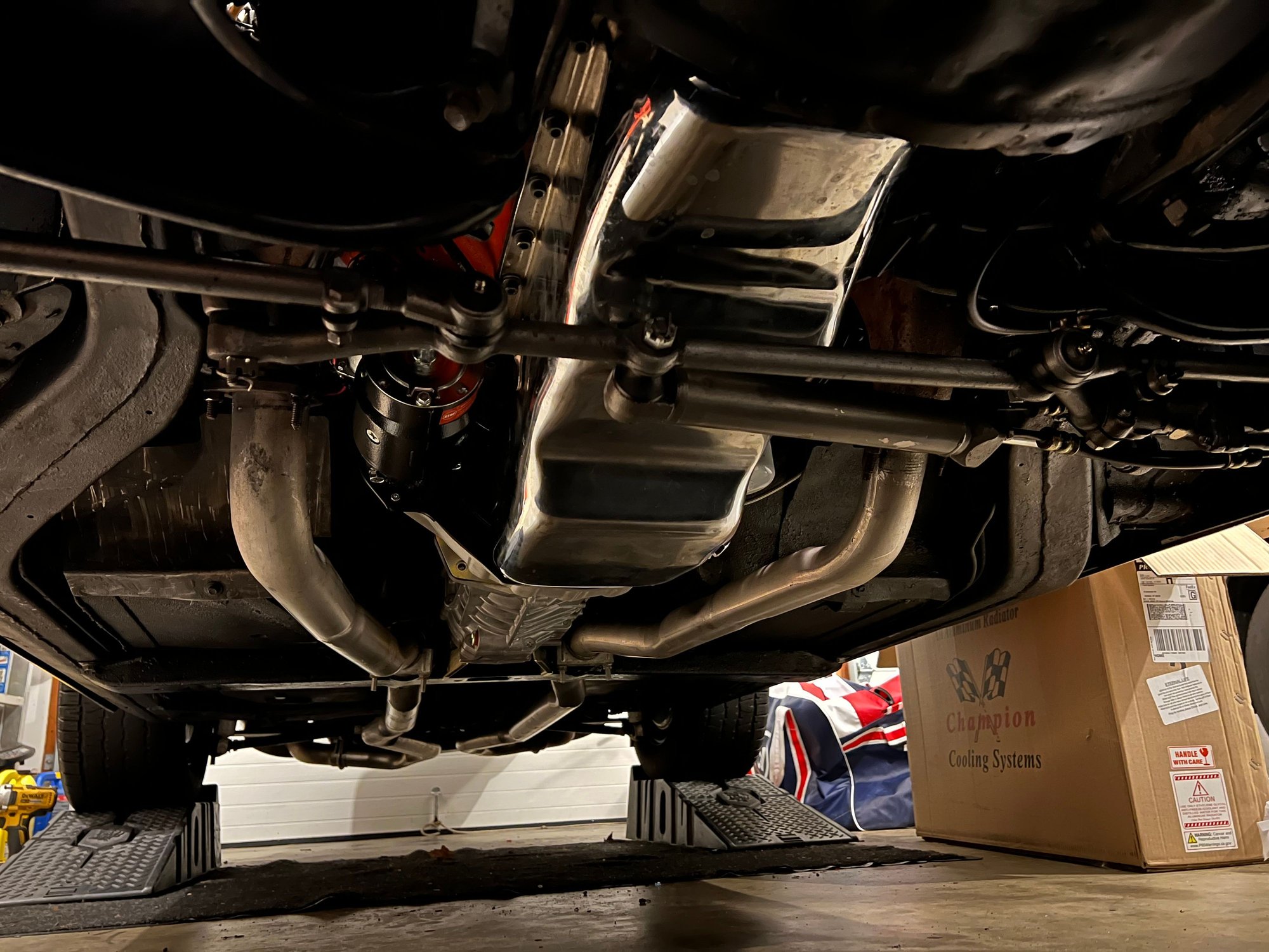

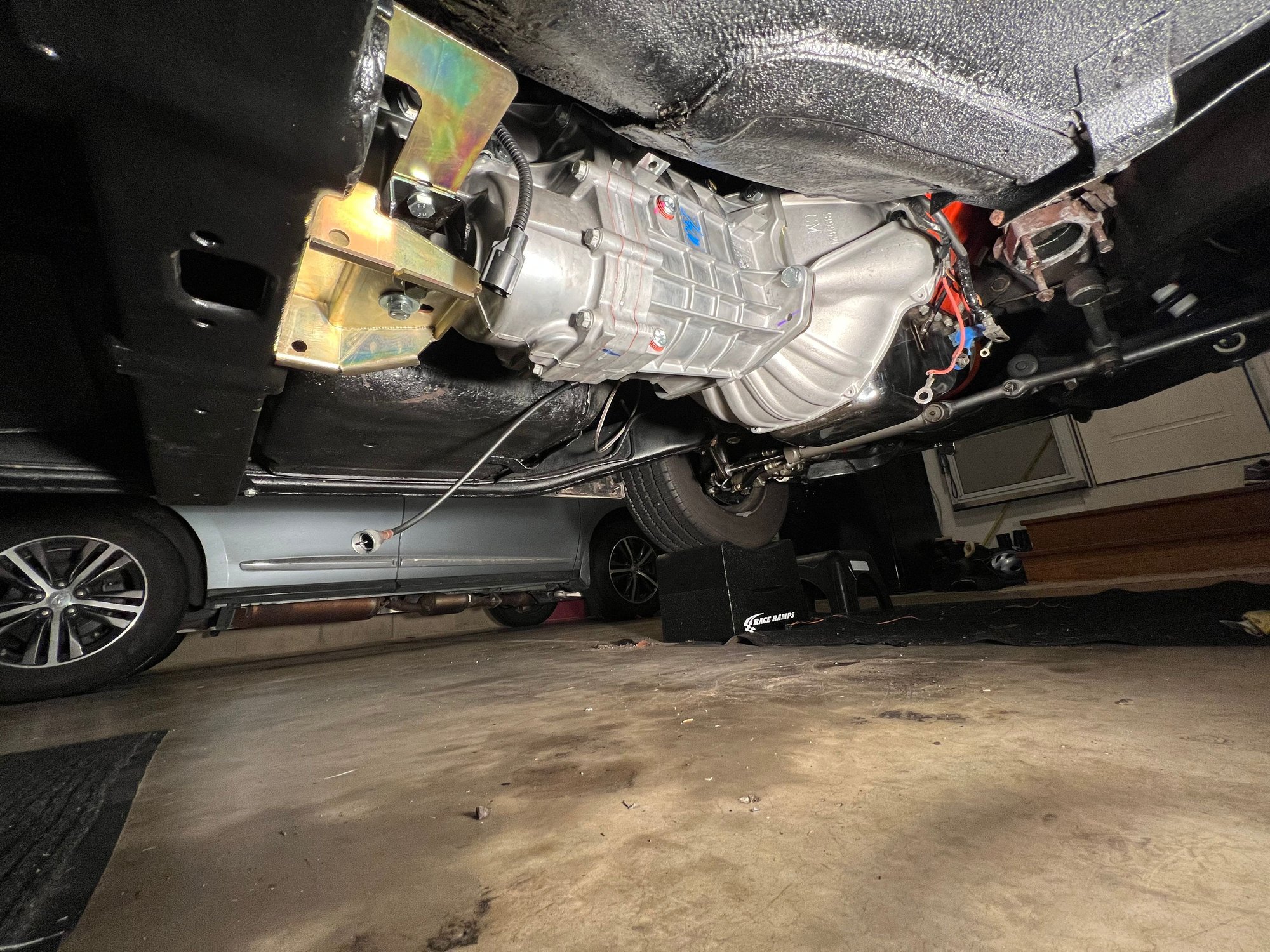

I installed the TKX 2 winters ago in my ‘71 big block. Got the kit from SilverSport, they were awesome to deal with. I converted from a TH400 auto, so I already had the removable crossmember, I’d recommend adding the removable crossmember because it makes it much easier to install.
Overall the install was pretty straightforward, honestly indexing the bellhousing was probably the hardest part, and it really wasn’t bad. I went with the hydraulic clutch setup since I had an auto and needed to buy all the clutch parts anyway. I would highly recommend it, the clutch is so easy to push and smooth engagement. I added a McLeod street clutch, wish I’d gone with a bit of a stickier clutch but that’s just my preference.
I have a 3:55 rear and I went with the close ratio with the 2.87 first and .68 fifth. I love blasting through twisties so the close ratio made more sense for me, plus with a built big block I don’t have any issues launching! 4th is fine for around town and fast sweepers, 5th is truly overdrive, I use it when I’m on the highway primarily. At 70 I’m spinning around 1900 versus 3200 before.
Feedback overall: best investment yet on my corvette. I love it, it’s a totally new car vs the auto. It’s easy to shift and makes driving on the highway actually enjoyable. I would totally recommend the TKX and SilverSport.
