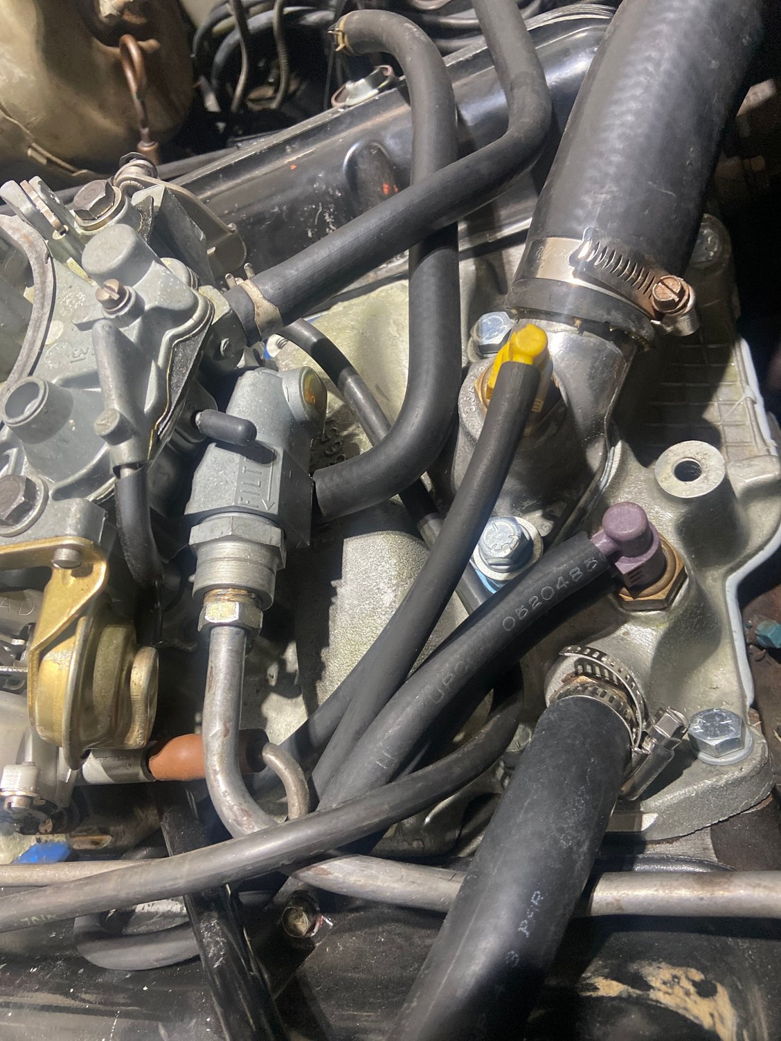

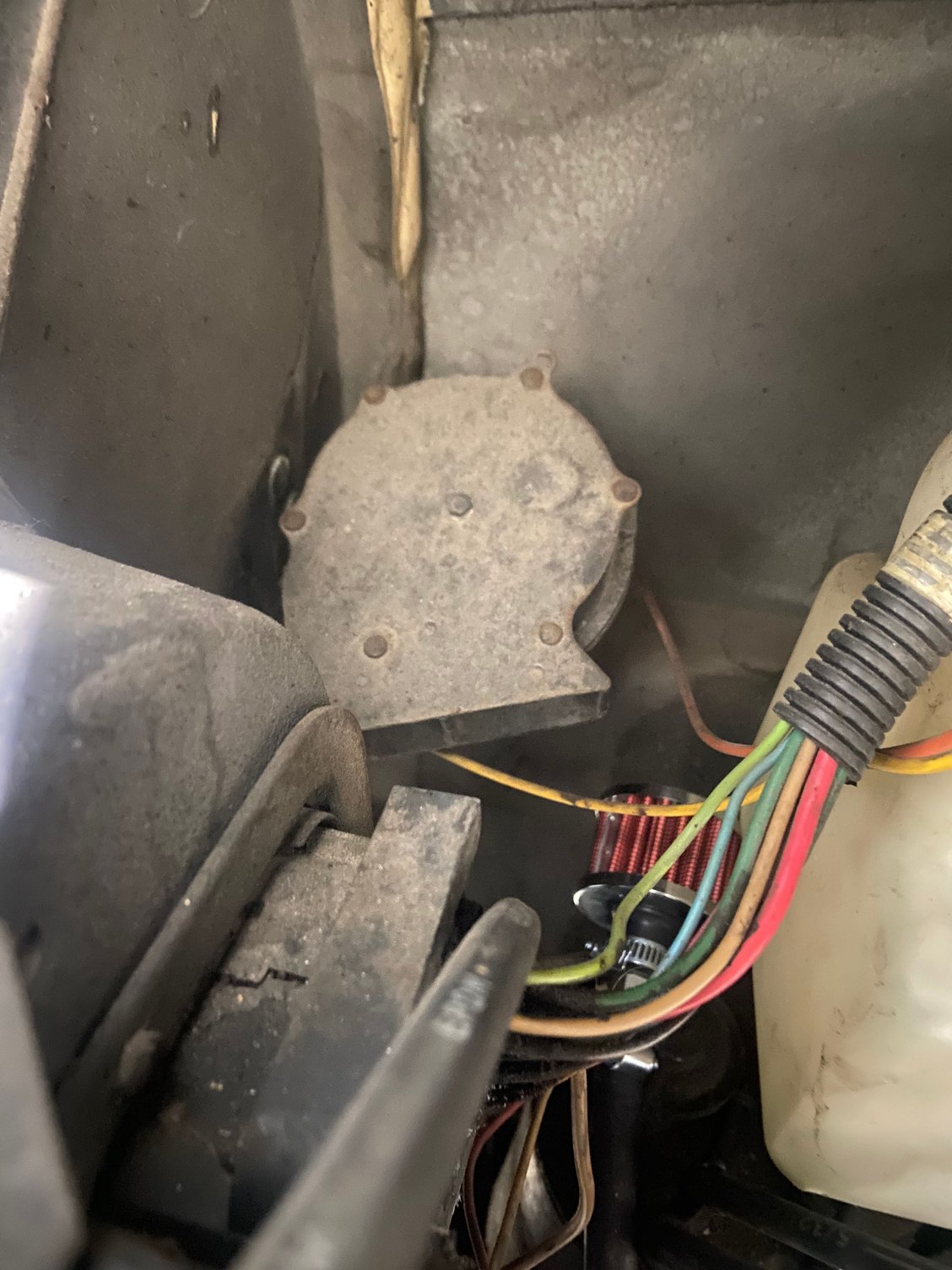

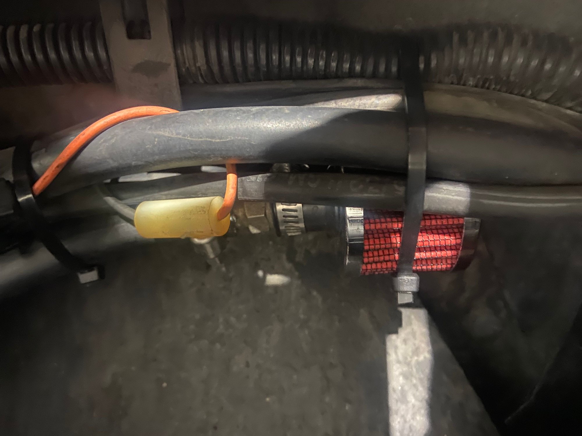

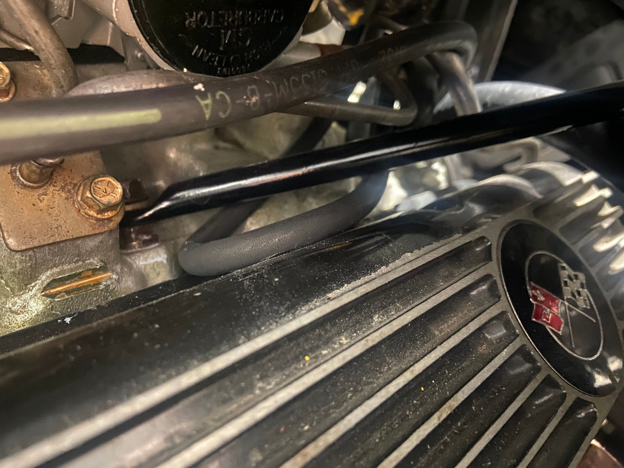

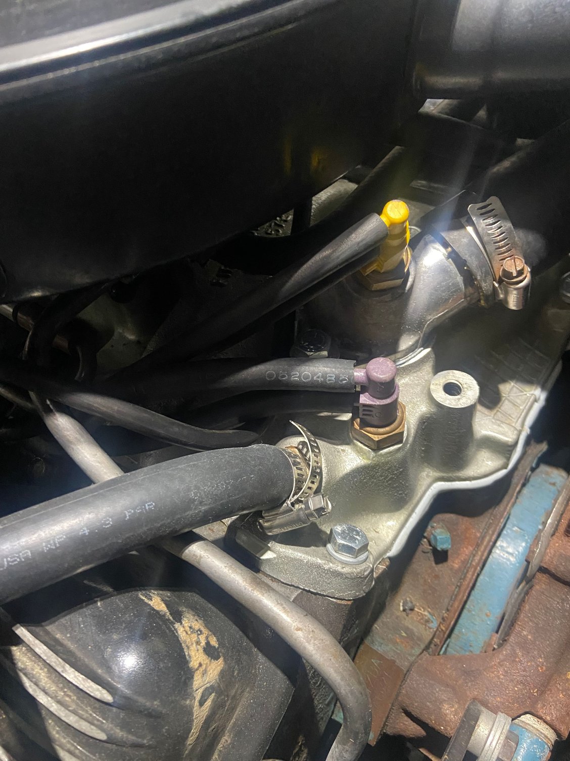

as I started to take a close look at how the car is tuned I am curious if anyone is familiar with these types of modifications:
  • complete bypass of canister
  • breather placed on line to tank
  • T taken off PCV valve
  • vacuum from carb to canister to breather
  • carb to air plugged
  • pump removed
  • both manifold ports defeated
  • EGR removed
  • butterflies in snorkels removed along with associated vacuum lines
  • high performance distributor
  • cats removed
car really runs good however is running, in my opinion, very rich… trying to understand this “tune” before I start twisting mobs and pulling levers….

most of what you describe is for better flow, some of it maybe either issues he had bypassed or just thought it would give him more performance
  • complete bypass of canister...............canister may be plugged or just bad
  • breather placed on line to tank...........with the canister plugged there is no venting to the tank so this is the new vent
  • T taken off PCV valve........................he did away with the vacuum source to the emissions probably, get a get diagram
  • vacuum from carb to canister to breather... not needed with everything plugged or removed
  • carb to air plugged........................... with the doors removed its not necessary
  • pump removed................................. smog pump? just looking for more HP
  • both manifold ports defeated.............not familiar with what you are referring to..probably emissions I assume, he was looking for more power
  • EGR removed................................. .again hes looking for power
  • butterflies in snorkels removed along with associated vacuum lines...better flow for more power
  • high performance distributor..............more spark for better ignition, may have had the old dizzy go bad
  • cats removed................................. .better exhaust flow for more power.
THeres no telling which he thought was for power and which was bypassing an issue. I myself would get rid of the emissions controls just to have a cleaner looking and tidier engine compartment along with the performance benefits. It looks like its still all there just not doing its job. He may have been trying to hide that it was all bypassed for state inspections as well. As for running rich I have an AFR gauge installed so I can tune with it. Better than trying to read hot plugs and getting burned

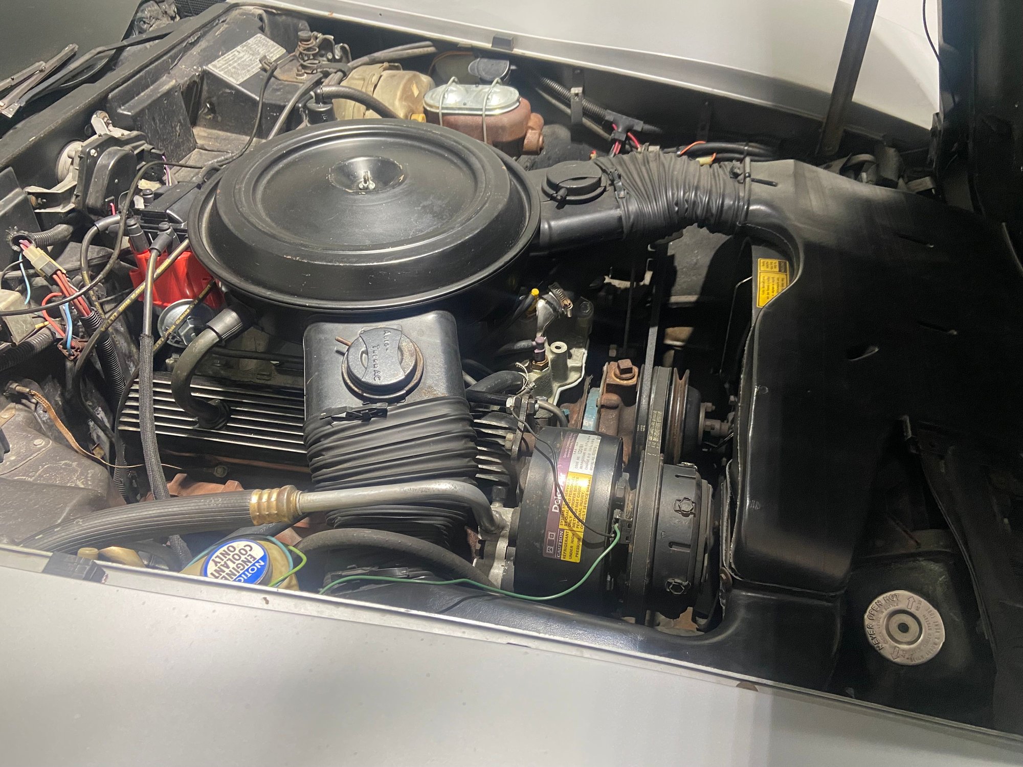

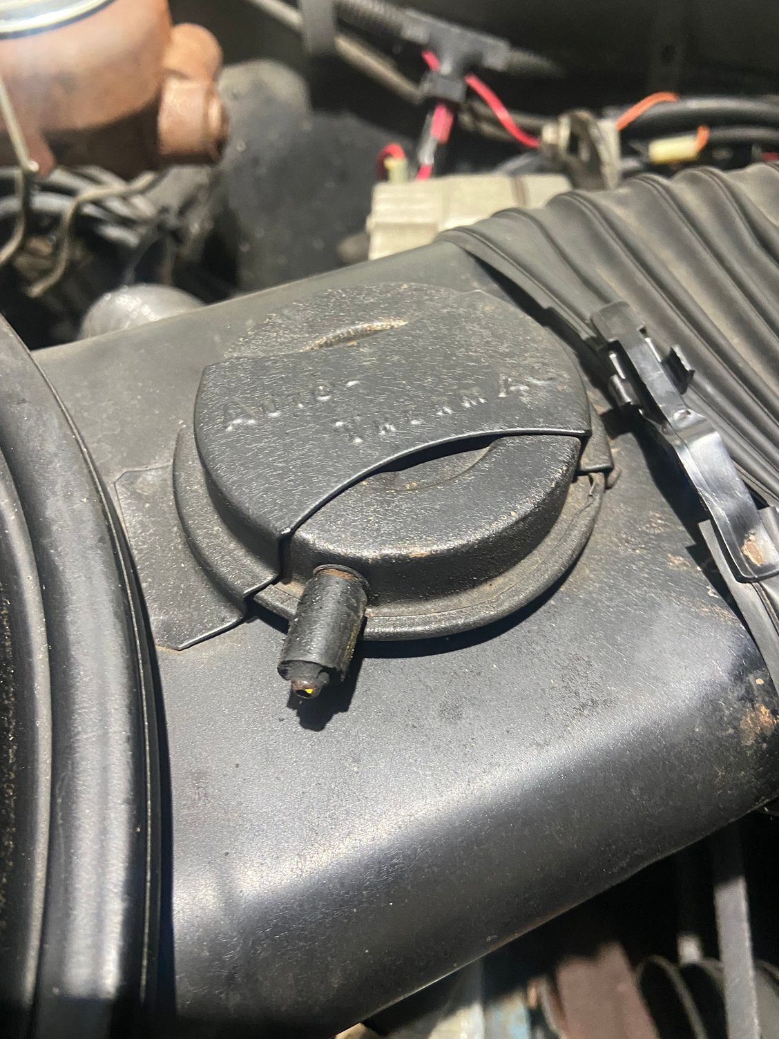

Check the timing. There are still vacuum hoses that can be removed, but the most important one appears intact: the vacuum advance. That should go to a manifold vacuum port on the distributor (please a few wide shots with the air cleaner removed, but it appears that it is connected to the correct port. Check with a finger or vacuum gauge, there should be vacuum signal at idle). The distributor vacuum advance has a hex by the nipple, indicating that it is adjustable, so be sure to see what effect the vacuum has on timing. For that, you'll need a Mity-Vac in addition to a timing light.

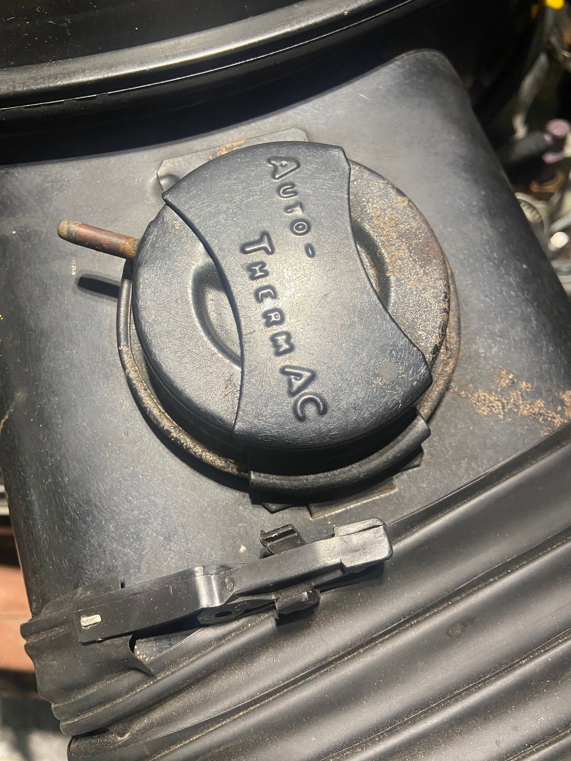

It's a bit unusual to find that the flappers have been removed from the dual snorkel intake, but the heat stove pipe is intact.

Yeah....kind of a major brainfart to open up the thermactor valves on the snorkles and leave the tubes so it can suck up all the good heated air........
