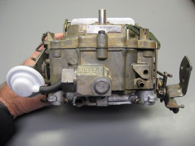

Let me give an update :
My Rochester carb has been rebuilt and cleaned up , it lookes like new !
The man who did the job came to me and did a setup with the carb also a tune up with the ignition.
A vacuum leak also has been found and repaired.
Throttle cable was hooked up to the right hole in the throttle lever.
What should I say ?
My car runs great , better than ever berfore since I´m the owner of the car !
No issues , much performance.
It was the right idea not to change to Edelbrock !

You're missing a vacuum nipple in the forward, driver's side of the carb just above the driver's side idle mixture screw - you have an open vacuum leak at that location. Install a nipple and either hook it up or cap it. It should look like this (compare to the last photo in your post above):

Nice catch!
